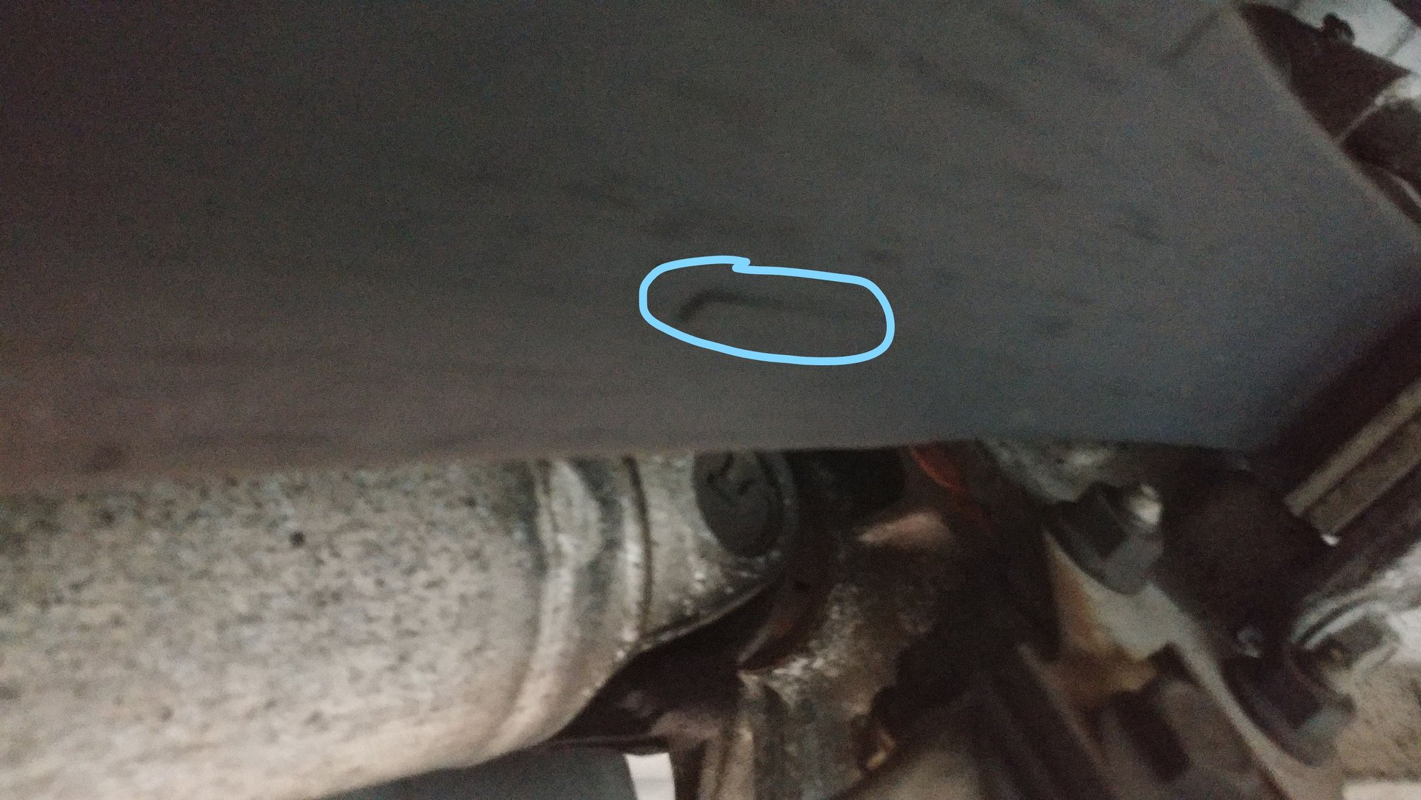

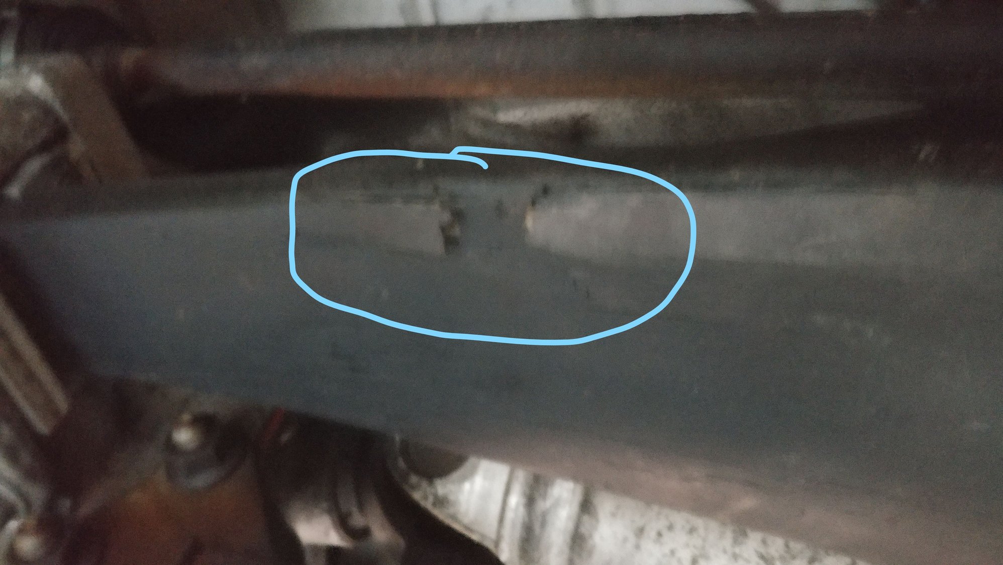

Tires... I put new continentals all the way around. Didn’t help. Just a quick question. Where are the front springs? I opened the hood to look at the suspension, and see only shocks. It’s probably a stupid question but I’m used to seeing springs. I “bounced” the front end pretty good with the hood opened hoping to see something bottoming out or broke, etc but nothing. What type of bushing damage should I be looking for? Control arm? Sway bar? Thanks! I’m gonna keep looking.

do a visible inspection, look for delaminating (see pics)

They don't weaken by what I am aware, if they are in good condition. But obviously they can get damaged / delaminated, this is a serious issue when it happens.
