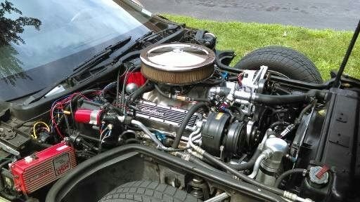

The motor is a pollution motor that had basic electronics control. The intake was designed for torque and pollution.
I rebuilt my 85, it's a small block Chevy and responds as such to mods.
Depending on your abilities, you can get a good , reliable car with 400 HP.
I chose to go basic SBC and did away with the computer. Later on I added a 6 speed. For what I have into it and the miles and smiles I get out of it - it was a great investment.
I did not buy it as an investment, I bought it as a hobby car - to enjoy and work on. ( I did away with the MSD box , a while ago, as it was used and failed)
It has done both very well. People will talk bad about carburetors, but they don't remember that cars ran well with them for 50+ years. I have had only minor issues since a conversion to a carb in 7+ years. It has not been the fuel system.
The HELI module went bad, and the dash went bad. Both cost less than $300 total.
I'm over 100k miles, and just spent $600 to re-do the suspension. Try that on a new Vette.
For me it's not a money issue, I have an A/C 67, top flight + others. I enjoy driving the 85 and the look.
