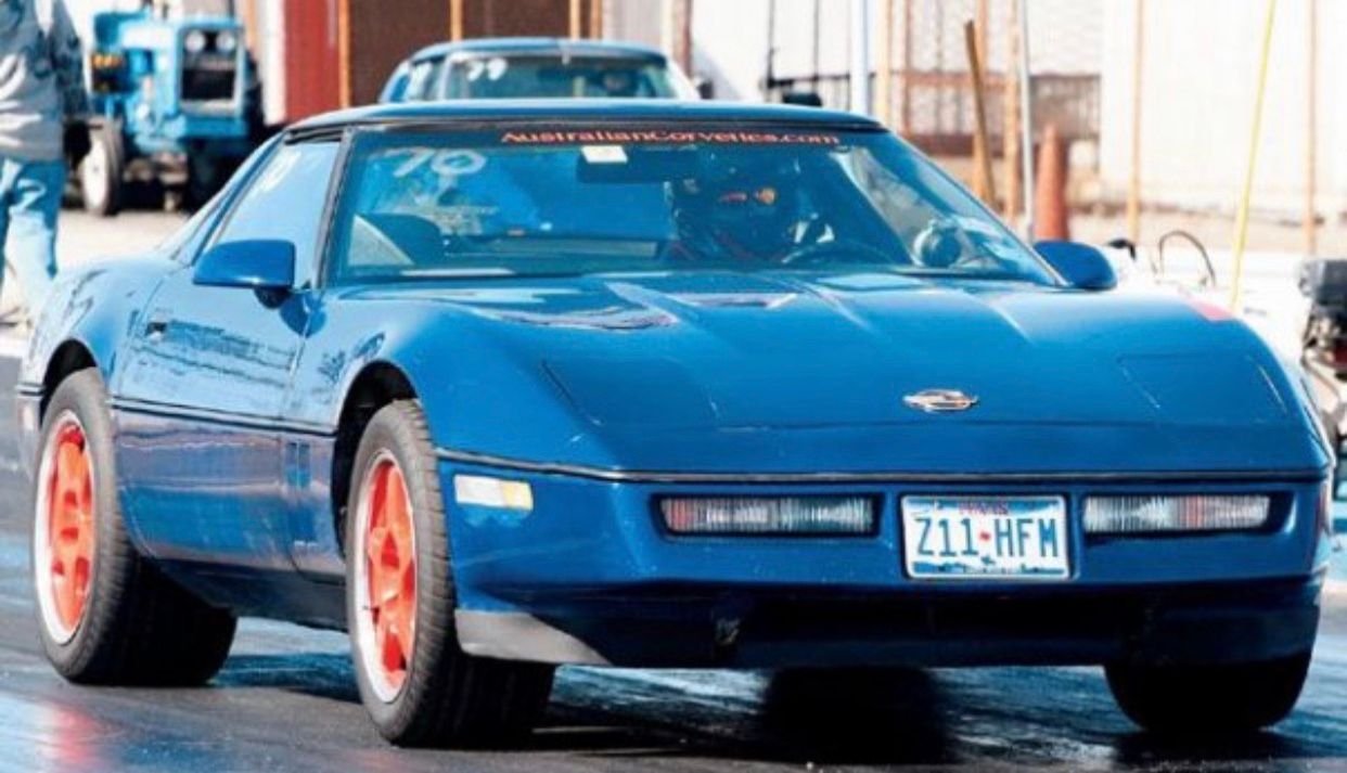

My 84
Just read your posts. Brilliant journey. I've got an 84 that had seen some various mods and a CFI car can certainly run hard. Pop the hood after a 13 flat at 107 and watch the eyes bug out lol
Enjoyed the read, lots of the same guys provided my answers a few years back.
Awesome ride !

That’s a nice car, must be about 350hp or so?
I'm glad you enjoyed the posts I thought it would be helpful to others with crossfire Corvettes. They are a little different so there isn’t as much info out there, but as you say you can make them go pretty hard. The guy that helped me with the dyno ben73 has a 84 that runs 12 flat with a crossfire. Buccaneer thinks it’s the fastest normally aspirated crossfire in the world. By all accounts it’s a monster.
I was pretty conservative with my build but I can probably find a bit more HP if I go looking.
