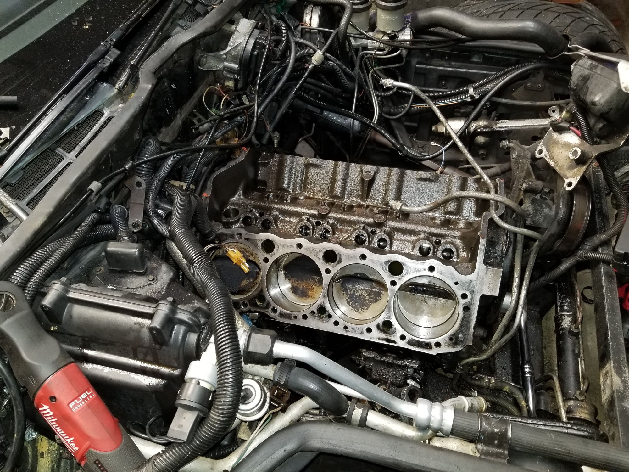

I'll post the full spec out at the end. I just am horrible at documenting along the way then also second guessing everything as I do it lol. I am actually basing my build off the 383 we built for the work truck 2 years ago... that was more or less a 9.8:1 vortec headed 224/230 build up. But that retained the stock manifold (vortec) and exhaust (2.75 true dual) I'm realistically expecting 330 or so at the crank but depending on tuning and other factors such as the restriction of the throttle bodies it has the potential for 400 at the crank. (I think I'll brick wall the fuel system before that though) With good tuning I should be able to inch it to 375 but that'll be a long process and hopeful. My original goal was 1hp per cubic inch but my buddy played with desktop dyno... albeit it is hard to get a renegade style intake in it so we fudged it with a mild flowing shared plenum lowrise single plane and we got something like 440. I guesstimate that DD reads 10% high so 400 seemed like a pipe dream. 375 I feel can be done. Or I launch a rod trying. broad power band is the goal. So if I only get to 350 but have a flat band from 2500-5000 then I think I've done well. I'm expecting roughly 6000 as the redline. Nothing crazy.

Ah 383 sounds more doable. 4 or 2 bolt mains? ZZ4 might be a start. I think over about 6100 4 bolt mains provide a bit more comfort and peace of mind. Looking forward to hearing all about it.
