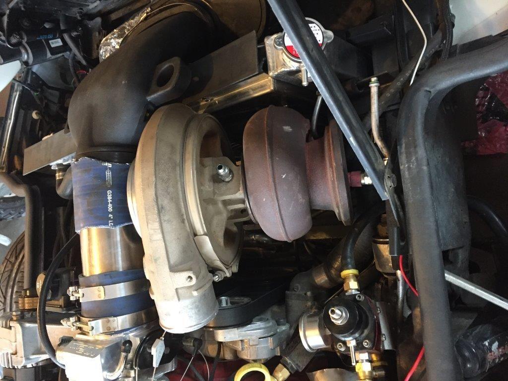

I'm curious if that AC bracket will fit, with the engine/frame support brace there. The C5 accesory kit I have is pretty tight next to the engine already, so I doubt it will fit. As for the PS/alternator in the lower position there is a C4 steering shaft going to the rack. It would be awesome to move the accessories down low so you can run the turbo exhaust tubing up above, but I doubt the dirty dingo set-up will work. The accessory kit pwnage is running looks to be the sweet-up if you want to run a LS turbos set-up at some point.
You could always build your own turbo piping as there is room with out the AC unit up top position. You could easily put in a S400 T-6 sized turbo in between the engine and raditor.
I was just goofing around last winter, but it fits in there decently Thats a BIG BOY S480/96 T-6/1.32 96mm turbine, probably around 1000HP turbo
