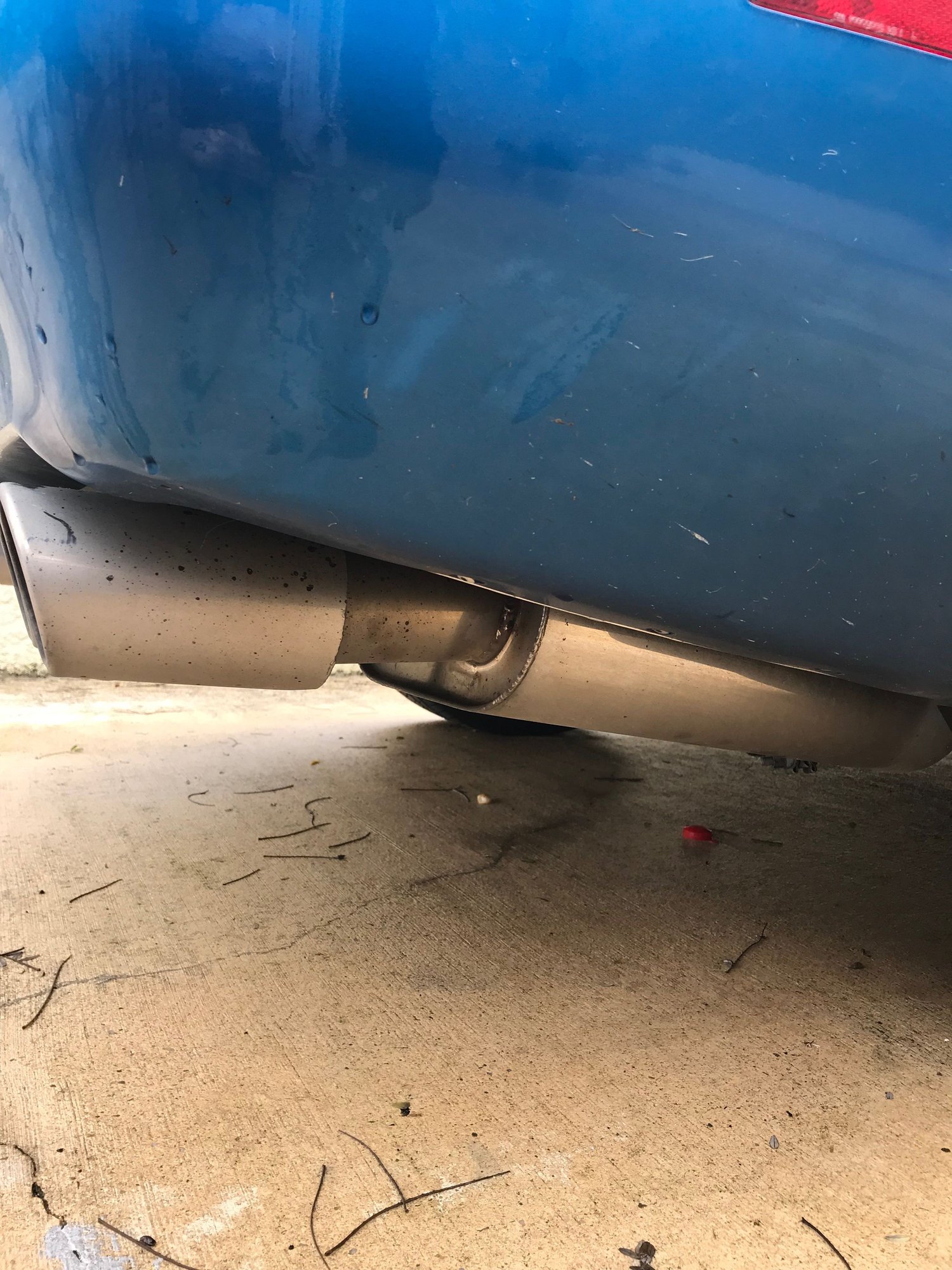

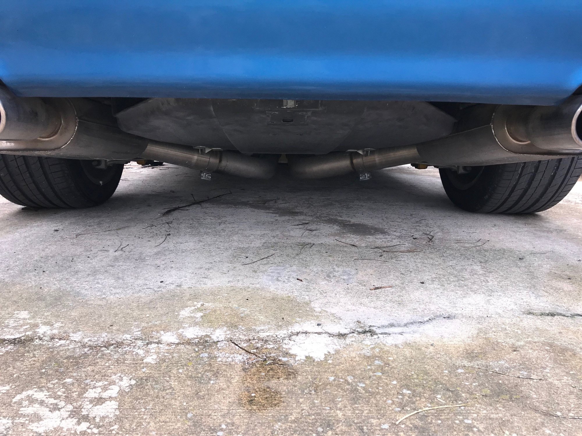

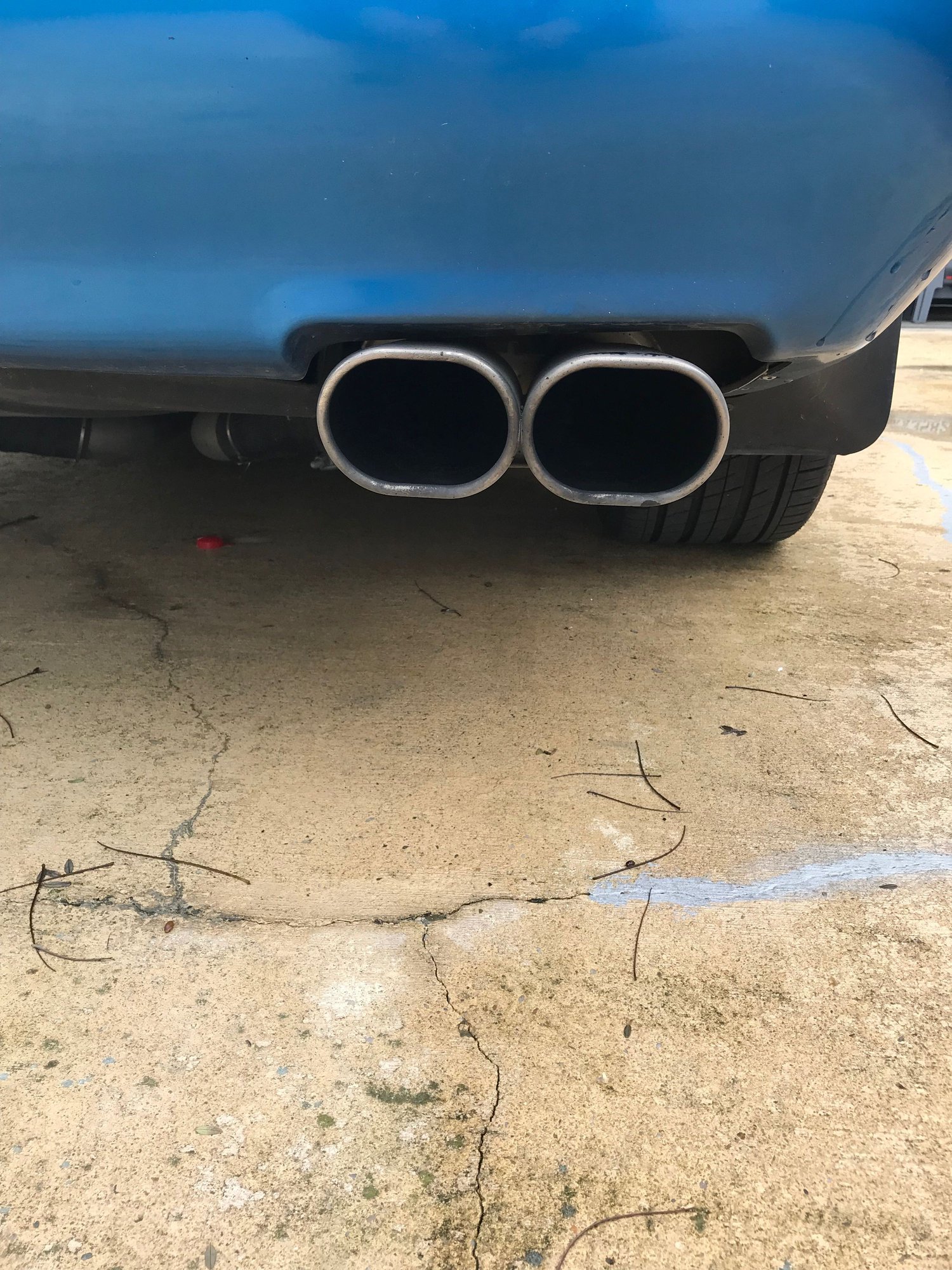

Hi these are the pipes fitted, can you id them?
'93 vette exhaust
'93 vette exhaust 2
'93 vette exhaust 3

Looks like B&B mufflers to me, not sure about the rest though.
I also see what looks like soot where they clamp on. Try tightening the clamps up a bit, as leaks can cause unbelievable drone.
