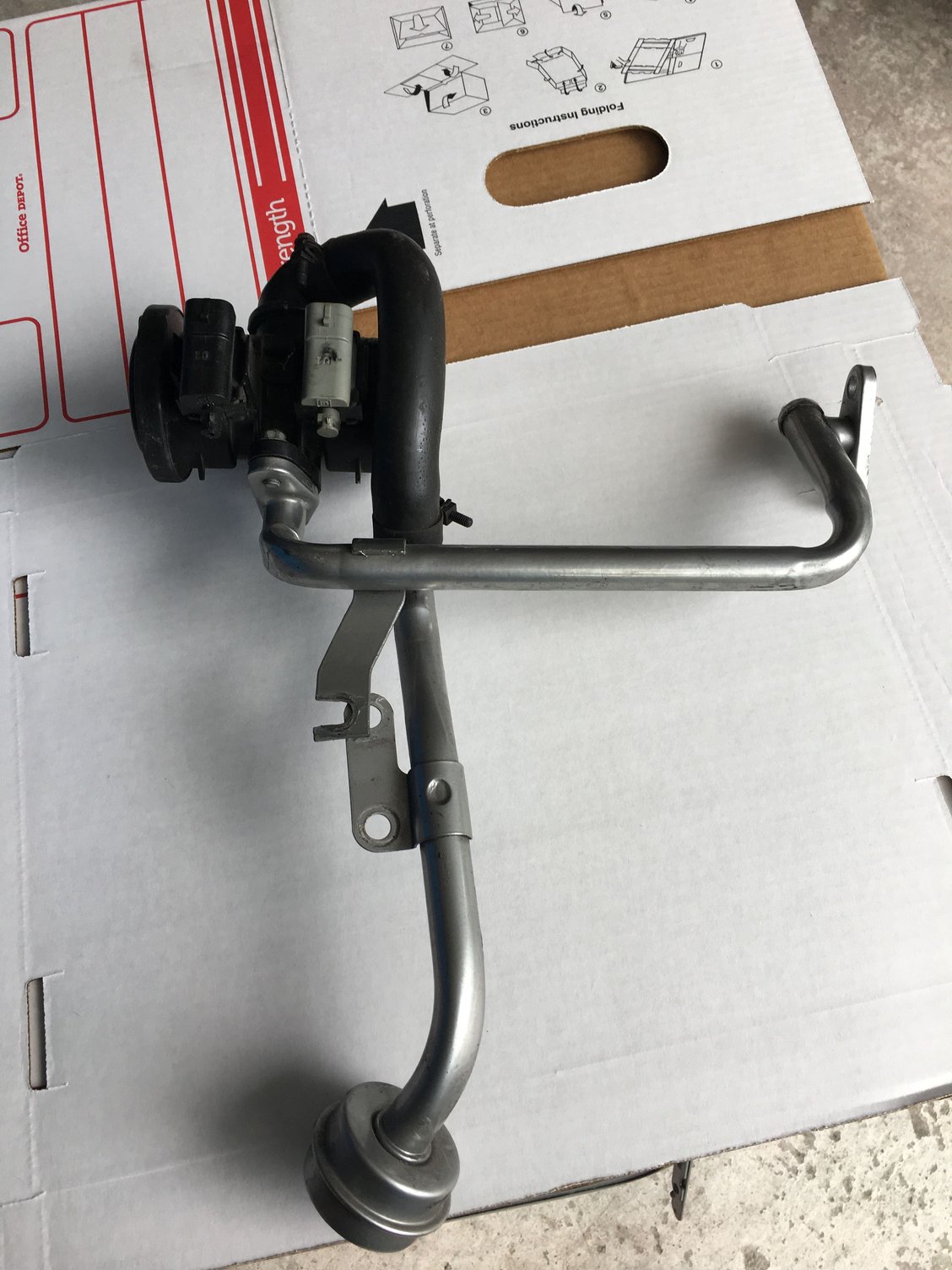

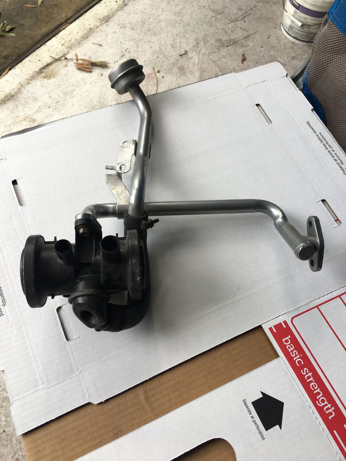

That is probably the inlet for the air pump exhaust. When the AIR valve(s) are closed the air from the pump just goes overboard through that pipe. It might be hard to see, but if you follow it down it ends in a small muffler to quiet it down some.

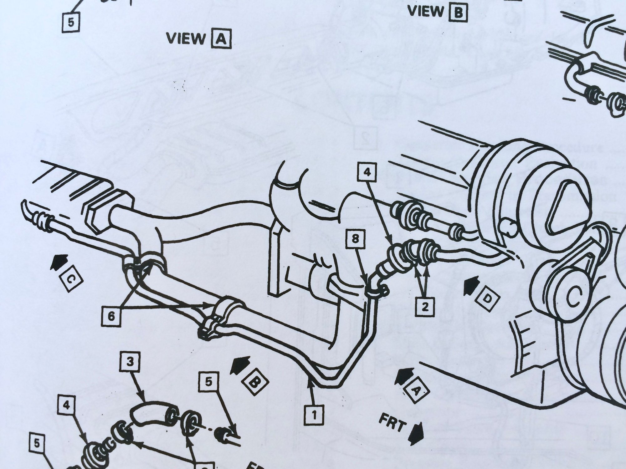

Well then it's either the pipe to the passenger-side exhaust manifold or the injection pipe to the cat, number 1 in the diagram.
AIR pipes

Tod, you may be right. I just got the car about a week ago and I have not been under the car, I''ll check to see if the cat was remove. if so I'm assuming just leave the pipe as is or should I add another pipe or hose blowing down and away from the engine, what is your advise ?

i don't know what the difference is between the 85 and the 89 but, here is what the emissions look like on the 89. you can see the hose with the 'muffler' attached to it that goes down in front of the water pump. i had my tubes powder coated a silver color.

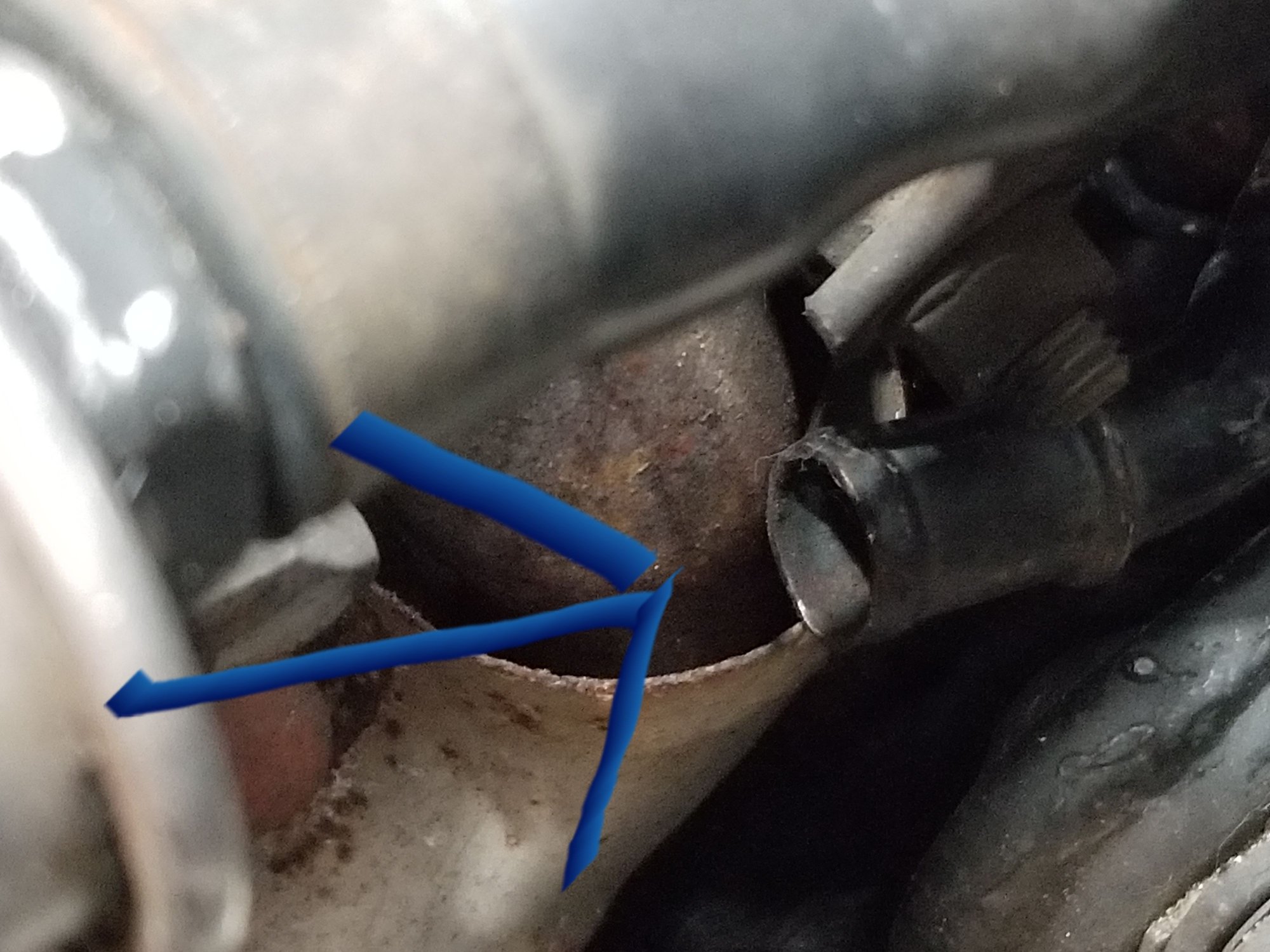

The 85 and 89 are different in set up, but probably function in the same manner. Its not the muffler tube as I posted before, that is hooked up in the correct location, I'll take a few photos and post them for everyone's review...

Here a photo of the metal tube, it's near the header. See attached...
