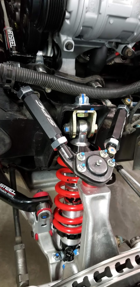

I have QA1 generic coil overs with some heavy duty mounts from a Jeep of all things.

Very nice. I may go that route. I think I could fab the mounts, Just need to determine shock lengths.

08002500550 - Spring, Eibach coilover 550# 8 inch length
DD304 - Front shocks, QA1 coil over
BAR305K - T-bar kit, QA1 shock lower mount
788-110 - Kit, QA1 spanner wrench and bearing (front shocks)
690001 - Coilover shock adapter, Pro Comp loop to stem Upper control arm, RH tubular maximize caster and geometry

Check with Van Steel for C4 Coilovers. They have QA1's with single and double adjustable Coilovers. The application you are going to run will determine the spring rates you will want to use. Also, important to corner balance and set ride height once you choose rates. If just running on the street you could run whatever height you wanted.
