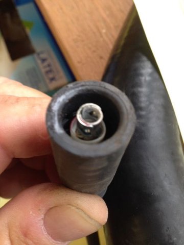

I did not open it up before I sent it in. I did see where the coil wire connected to the opti the connection was solid yellowish thick corrosion. Both in the opti pin and the wire. Back in the day nobody would ever say," My distributer cap and rotor only have 54,000 miles so it should be good." I am 68 so when I got to the opti I wanted it done right. I am not in a giant hurry and have another car to drive. Price out a MSD cap and rotor and you
will see the optidoctor does not charge much to clean up, bead blast, install new bearing and seal the unit up with some real good sealant and TEST. Too much work for me to not have it done right.

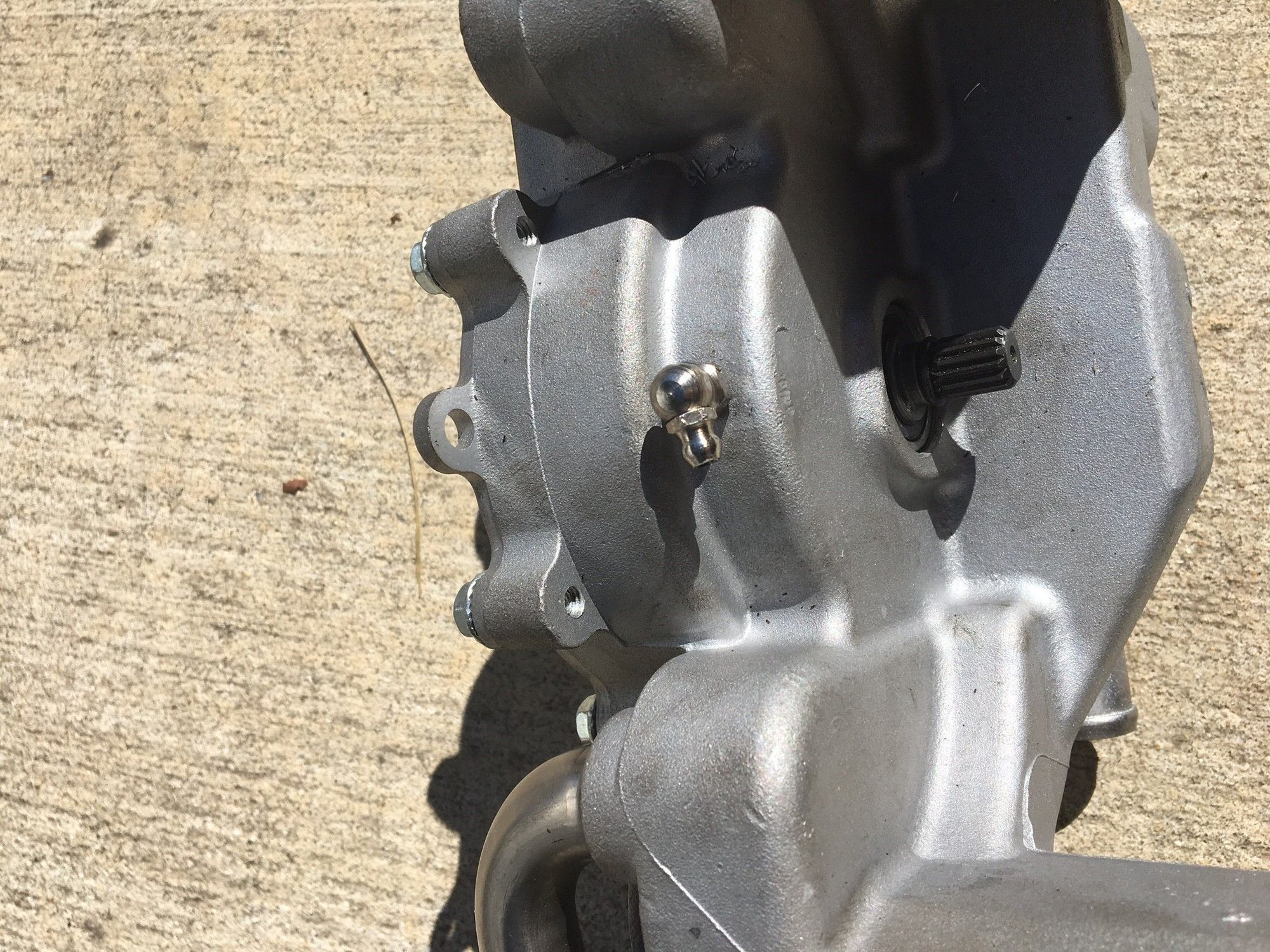

I didn’t have to tap the weep hole since it is aluminum and I used a hardened elbow. I did however use a drill bit the same size as the weep hole to essentially clean it out and de-burr any casting inaccuracies.
I used a 90* grease fitting for the elbow since that was all Lowe’s had. Turned out to be better since it is a hardened part and always in stock. I drilled out the end and removed the inner spring and ball.
I applied a little thread sealant to the elbow threads
Took a pair of vice grips and screwed the elbow into the water pump until it stopped in the position I needed. I ran the drain hose out the passenger side as it was less obstructed and there were other hoses to attach it to.
