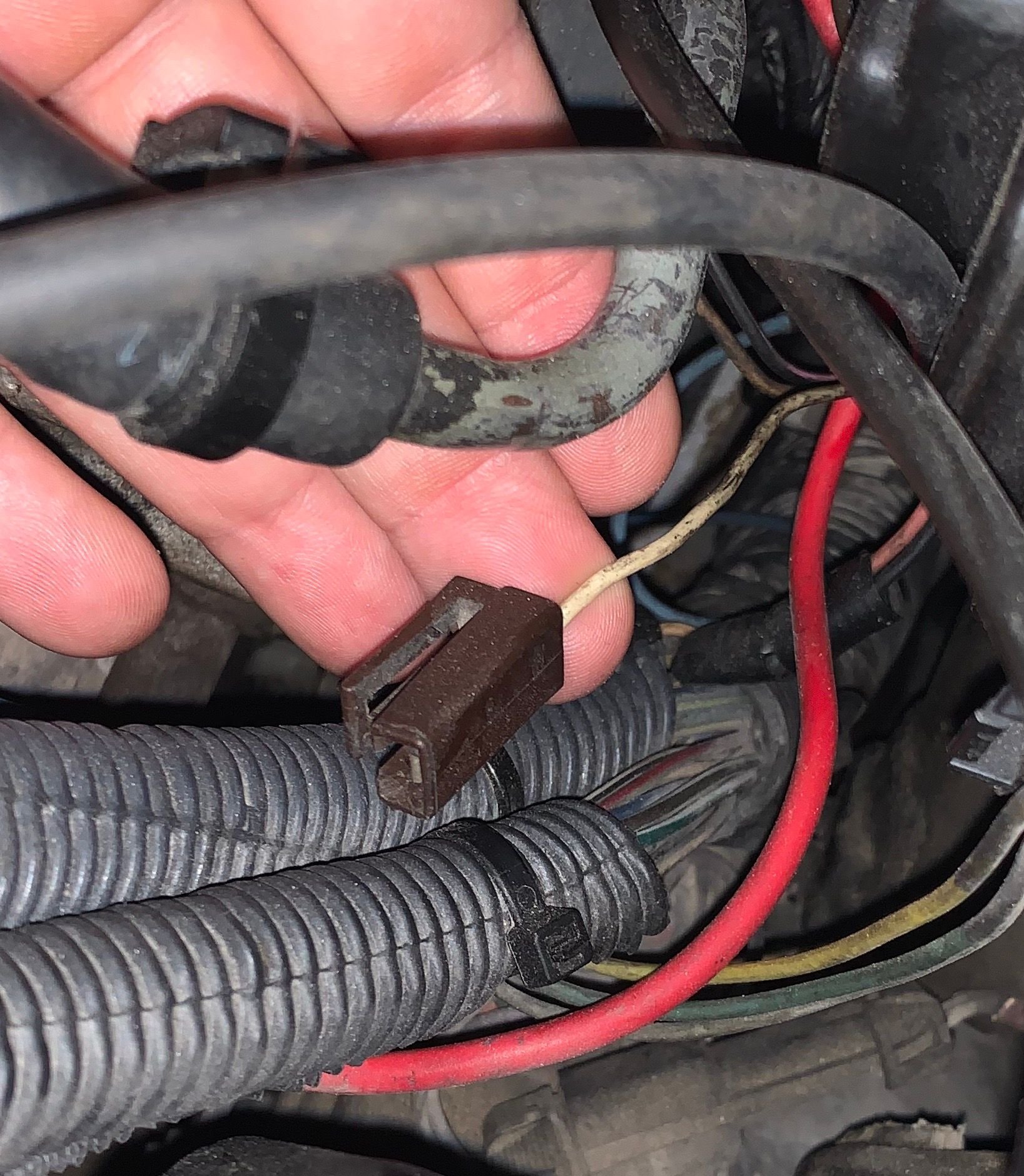

Hi, just found this connection, what is it for? Anyone knows?
TIA

It was under the distributor in the back of engine ...

Does your tach work?
no it’s not... so it’s for that
but where does it go?

Does the dash work except for the tach?
That wire goes to the tach filter mounted to the bell housing area in back of the distributor.
You'll need to take the wiper motor off to even see it. The brown wire is obviously off it. There should be another one on it hopefully.
thanks 👍🏻
I’ll try and look for it

that goes into the distributor beside the pink wire with the wite terminal.
