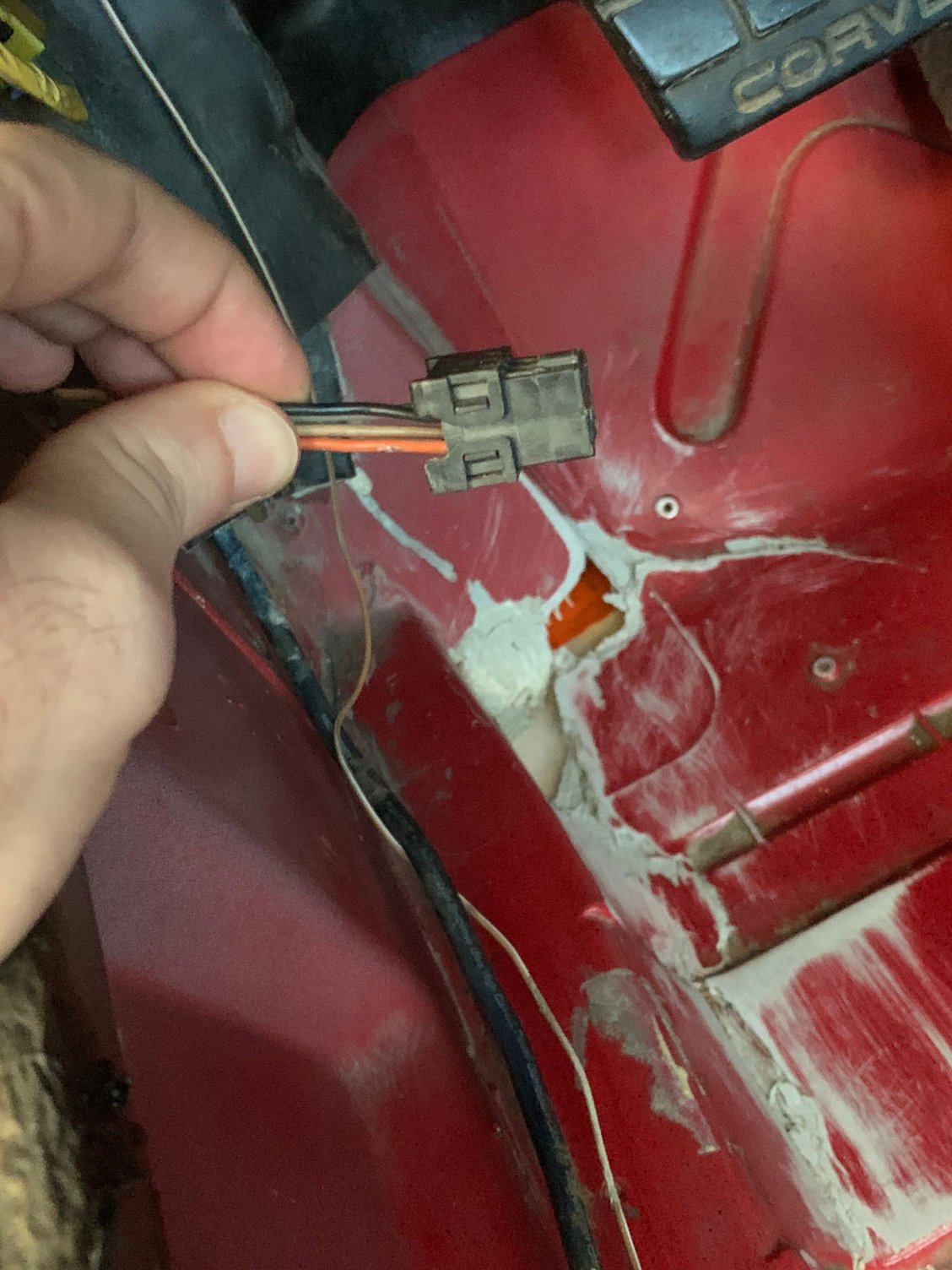

Ok, interiors removed and did some sanding with 80 grit and this is how it looks... the white thing below is wax paper to hold the work in place...
And while I’m there I found this connector just dangling from the corner, any idea what is it for and where does it go?
I'm doing a similar repair on the corner of my floor pan where the previous owner(s) didn't jack the vehicle properly.
That dangling connector looks like it would go to the LF amp\speaker enclosure.

I think I would try and remove some more paint. Perhaps another 1/2". How many layers of fiberglass do you plan on using?

I certainly have enough of this fiberglass mat stuff that I don't need to be stingy. I'm thinking maybe 4 or 5, as much as it takes to bring the repair flush with the rest of the floor pan, then grind the bottom side a bit and do a few layers there.
My hole is right in the corner, I think my biggest difficulty will be building something up to keep the the stuff in place while it cures. I think I may try and cut something out of foam to match the contours of the pan in all three dimensions, then glue wax paper or something to it.
-Mike
that could be it as there is a Audio system installed by previous owner with Amps in the back...
thanks
yeah I guess I’ll do that ... as for the layers as much as it needs..
