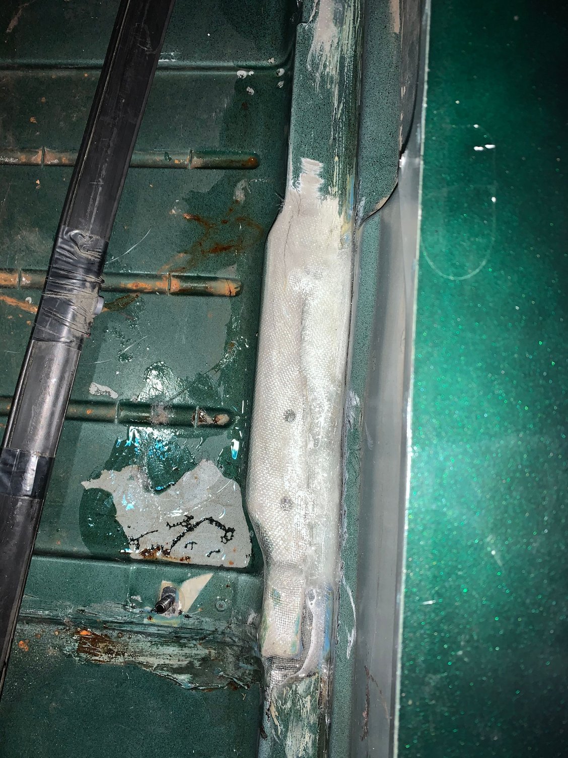

Here’s what I went through two months ago.
Used west system epoxy. Worked out great. Still have to touch up the outside for extra strength but the interior side is done 100 percent.

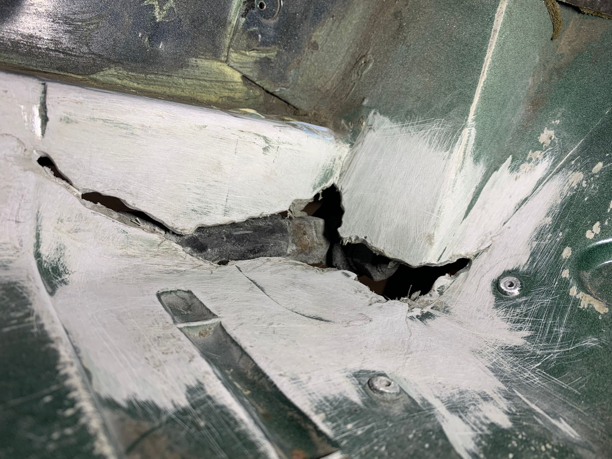

Originally Posted by MikeBusch2
Yep, no worries, I have plenty of space all around the hole to grind it down properly for good adhesion. Here's the hole I'm working with. Broken areas have already been cut out, but I still need to grind it out properly before the repair:
I'm fabbing something up out of cardboard to conform to the shape. I intend to putty the corners to get the right contour, and then I'll find some way to glue wax paper (or something else non-stick) to it. My intent is to hold this in place from underneath with a floor jack while I work from the top.
-Mike
WOW almost identical...the 2nd pic is what came out of it. I wonder if that's a bondo fix
