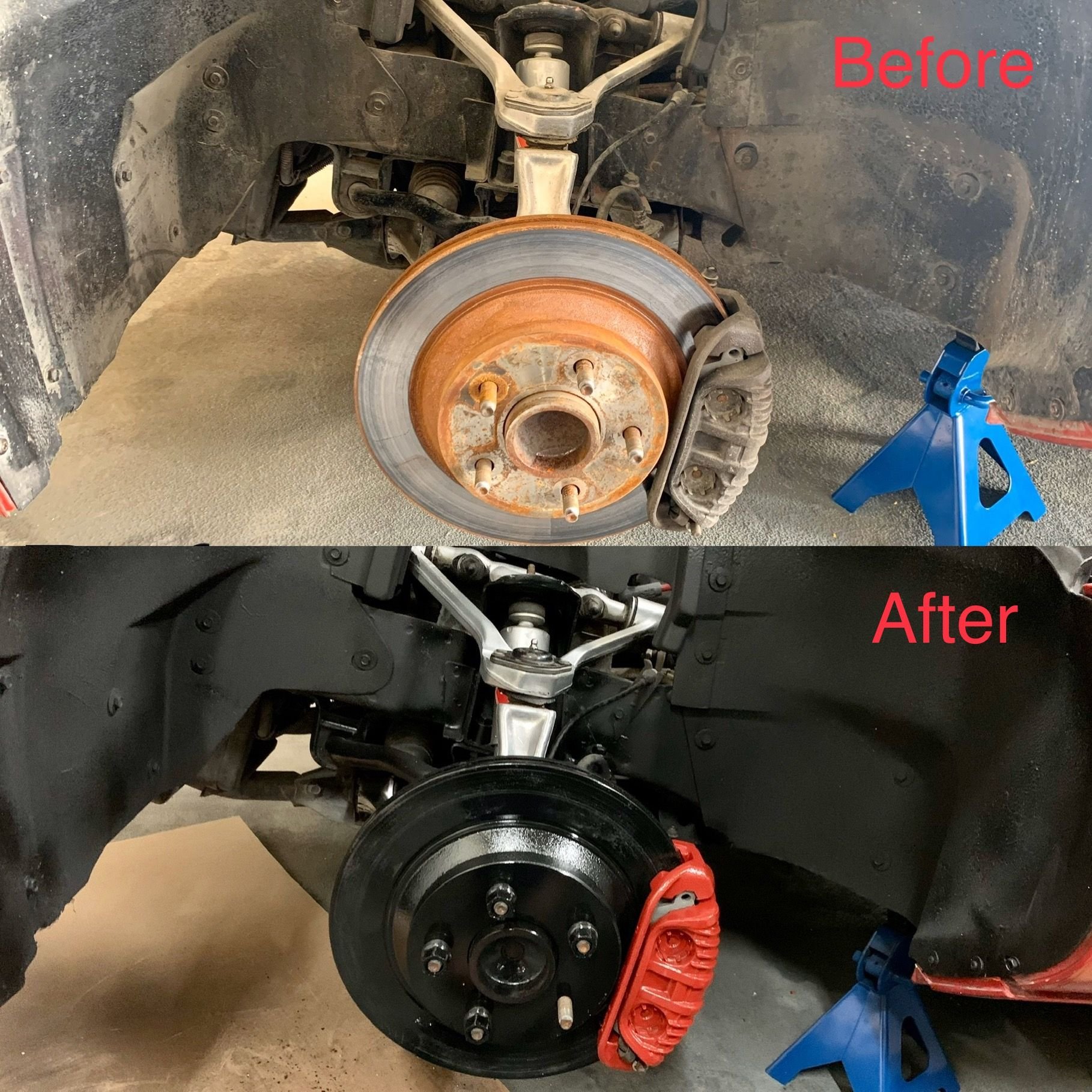

Hi, I’m in the process of restoring my 91 and renewing some parts... started with suspension as you can see in photo (before and after):

Man, did you spray paint the braking surface of the disc?
I shouldn’t?

Well, its your car - you can do whatever you want. The reasons not to do it include the horrendous smell when you first use your brakes after painting the disc, reduced braking effectiveness until the paint wears off, and contamination of the surface of the linings.
Yep I experienced that ... but it’s the fastest way and will be replacing the pads shortly.
