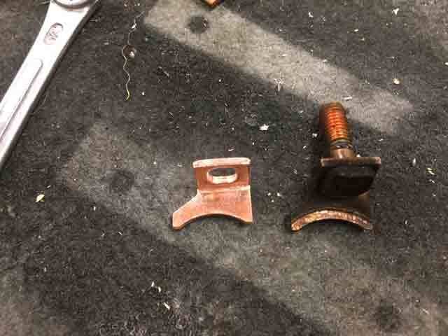

Curious, what is wrong with the starter?
Mine would start sometimes and others do nothing. But it was just the contacts in the solenoid. $15 kit and a half yours work and it was as good as new.
As others have said, Lt1 starters are pretty easy to change.
Here's a old a new contact side by side.
