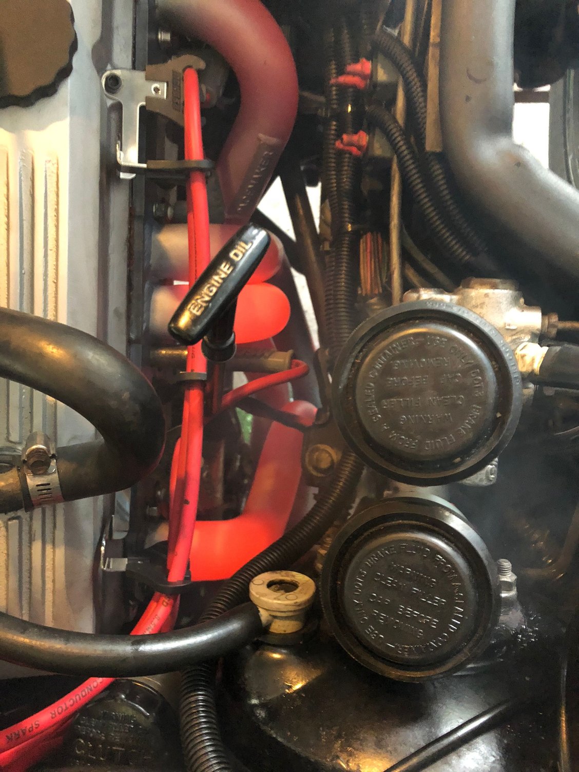

And for your dipstick, lokar makes a nice option that is working great with my headers.
the stock dipstick did not do well long term, it ended up splitting at the bolt "slit" mount.
the lokar looks awesome, but it gets hot.

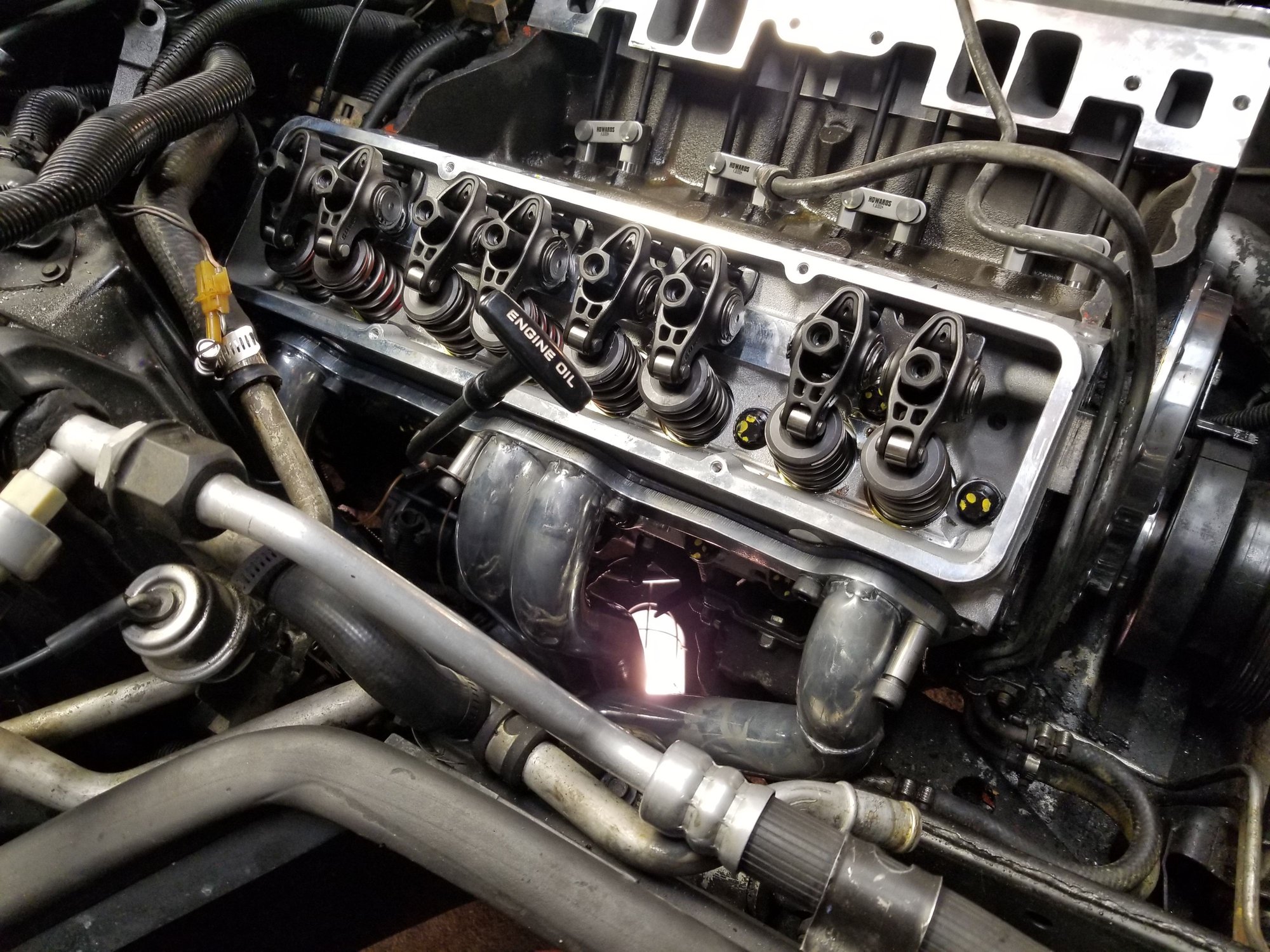

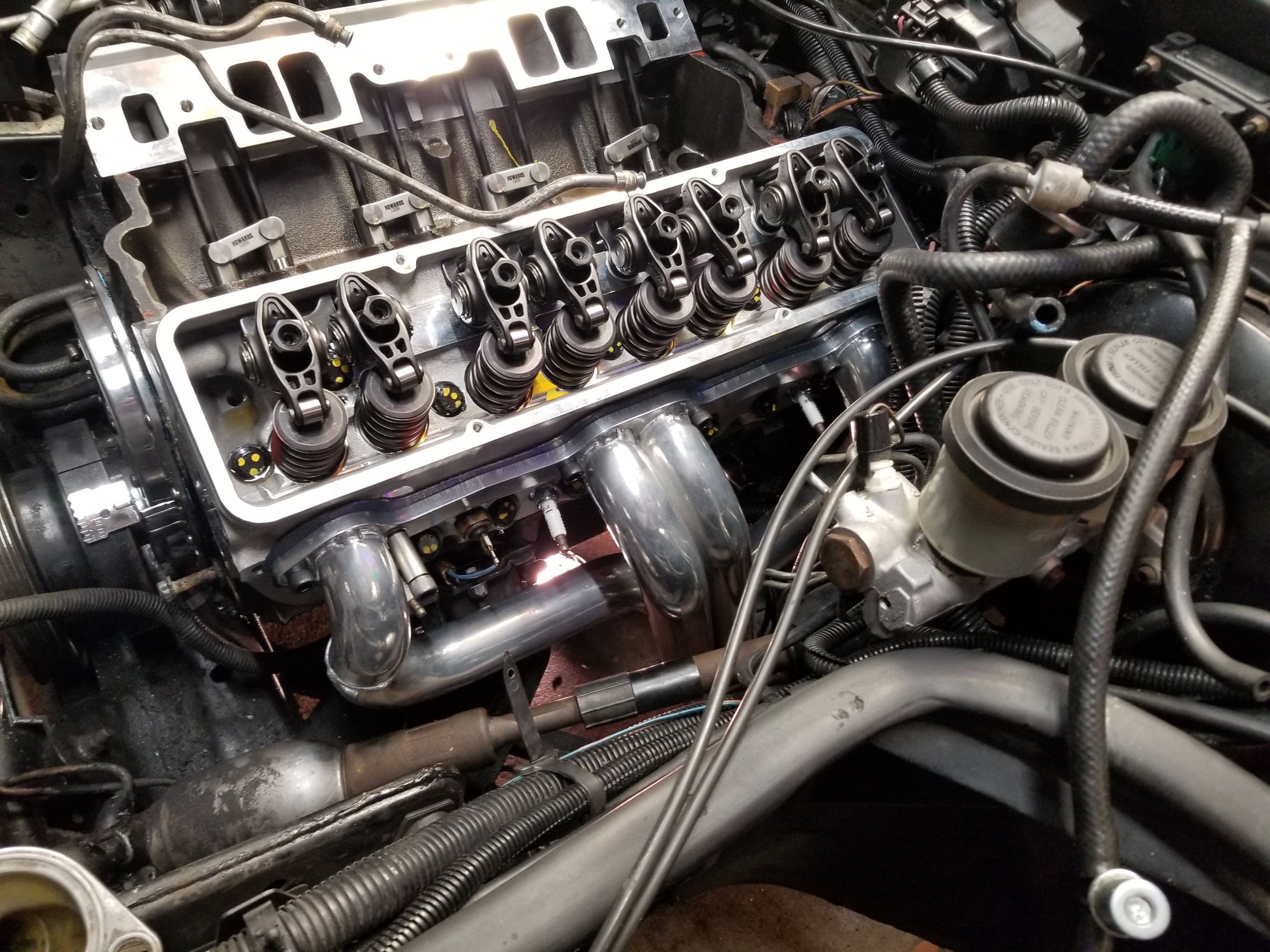

Originally Posted by 84 4+3
I'm pretty sure they are referring to the flat tappet breakin period of 2500 rpms for half an hour. I can see that baking off the ceramic coating. When I did the cam swap in mine the exhaust got so hot it actually melted the rear bumper where the knock outs are and the manifolds and down pipes were cherry red to the cat... I believe that would be the problem.
My headers during cam burn in.
