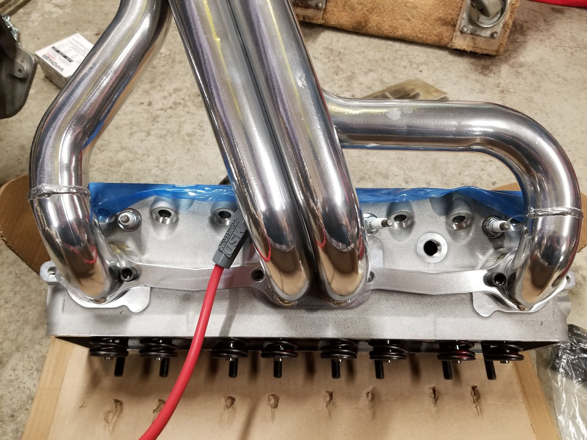

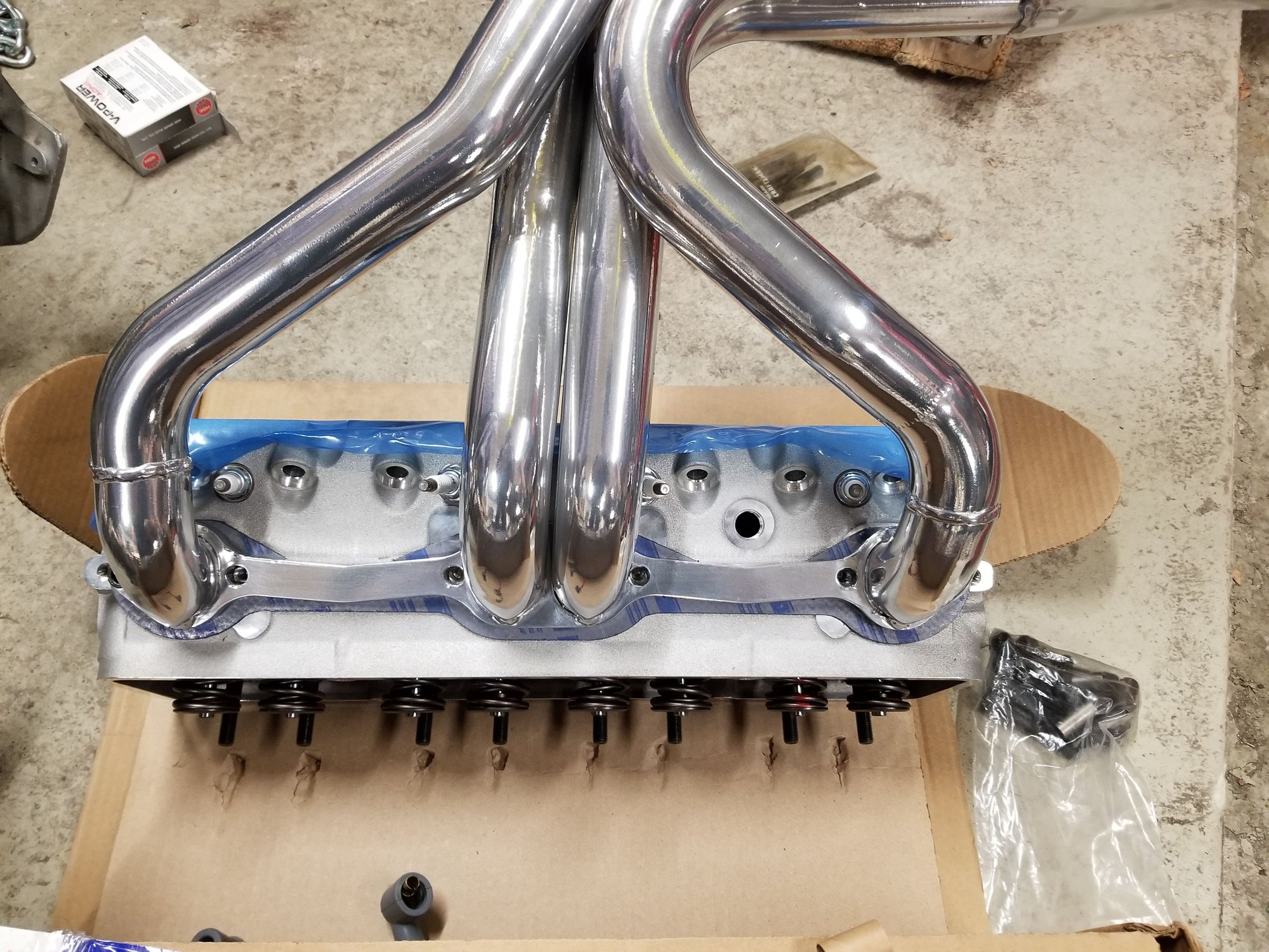

Test mock up on heads in the garage was a success. Easy plug access with a 5/8 socket with room to spare. The only thing I discovered is that I will have to run 2 exhaust gaskets or get different hardware as the bolts bottom out in the head before the flange really compresses the gasket... not that big of a deal and I'm sure the problem is probably with the heads...
Photos are always nice.
Not sure why you think your heads are at fault. You think gm screwed up your heads? Or are they not gm heads.. sorry didnt read the whole thing. ARP bolts are not cheap.
they are aftermarket heads. The bottom of the hole is drilled to a tapered end, if it were flat the bolts would be fine. They are flat finished. I'm talking like a finger nail thickness is needed to be correct, the ones with standoffs work fine too so it's just the shortys are a little long. Photos below, the one with the plug boot on it is the closet to a tube but still has almost a quarter inch of air space around it. Those boots touch my stock manifolds so I'm not overly worried. I think if I use low profile cap head lock washers or nordlocks that will solve my problem.

I like how the support between the tubes is so thin. Ive seen issues where they use a huge piece and it causes problems. are you sure all the holes line up perfectly. In the photo it looks questionable on one side. If you started them all great.. looks like a winner winner chicken dinner!
I cant tell if the msd is touching the tube. If it is are they designed for direct contact?
the wire has 1/4 inch of air all around it. No contact at all. I did pre thread all bolts but left only two in, the shadowing from the lights makes it look that way.
Figured as such... well this is a +1 for Melrose then. Sounds like a perfect fit on top anyway. Im an LT1 but Melrose would be on my list if I go that route.. Differential first though.

Not sure if you have a cut off tool but if you do you could just take off one or two threads.. run a nut up on it first.. file a champher and then run the nut off to clean up the threads. Ive done that 13,000 times.
I used to have a threaded cutoff tool but lost it. I could knock off two threads and be fine as well. I'll see what I end up doing. IIRC they don't offer the headers with emissions anymore so that is something to consider. But talking with others that had LT cars, they suck to get in but once in they fit. There just isn't much room under the hood on those to fanangle them in.
