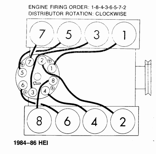

Thanks, I will let you know what happens. I have been through about the firing order but maybe I have been wrong. I have attached the firing order that I used for the L98.

Good news is I found a faulty spark plug and replaced it. All cylinders are hot now but the engine misfires and backfires and no power. My firing order is by the book. I have not done a thing to change the timing. Any suggestions would be great. Thanks
