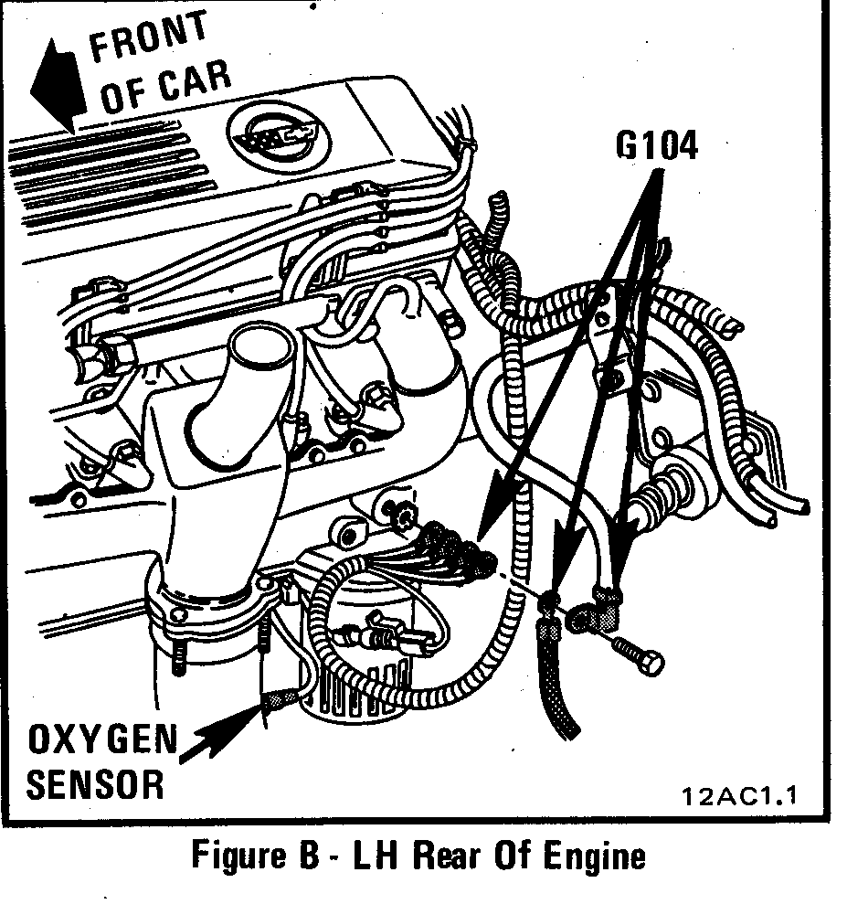

Also on my car many electrical features don't function. The screen that shows check engine is not working. I found the battery was not grounded correctly and fixed that. The main ground coming off of the block on the rear driver's side was just hanging down from the block. I did not see an obvious place to reattach so I grounded it to the frame. After that the security system started working in the car and locked me out. Kinda funny. Anyway the distributor mechanically is sound and has a new module and wiring. Another thing I plan to go over carefully is the harness for the injectors incase it is shorting somewhere. This will take time. The car was running great so I am confident that mechanically is is sound. The issues seem to be electrical.

I had a code 42 for EST(electronic spark timing) when I retraced all my connectors for poor engine performance to find my misfiring.
Note. those grounds attach above the oil temp sensor, so you may want to make sure a few are not still up above the filter/sensor.

Thanks for the insight, the main ground on the block is connected correctly, the other end that grounds to the frame is what was dangling. I think that they key to my car's issue is electrical.
