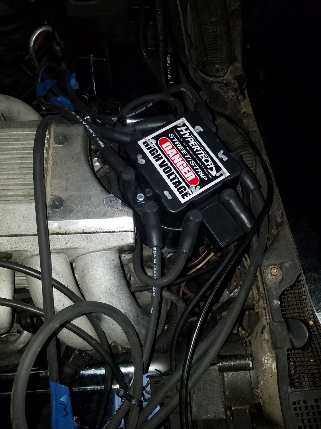

Ladies and Gentlemen,
thanks again for the support. After removing the distributor cap I found plastic parts that plug the side opening for wiring and that insulate inside exploded. Small brittle fragments were all over the place. I removed them all but ran out of time due to family dinner tonight. All other parts seem to be serviceable. I will get it all put back together later with a new rotor, cap, and coil. Looks like I will have to either rebuild or replace the distributor. Any thoughts would be great. Merry Christmas all and thanks again for the support.

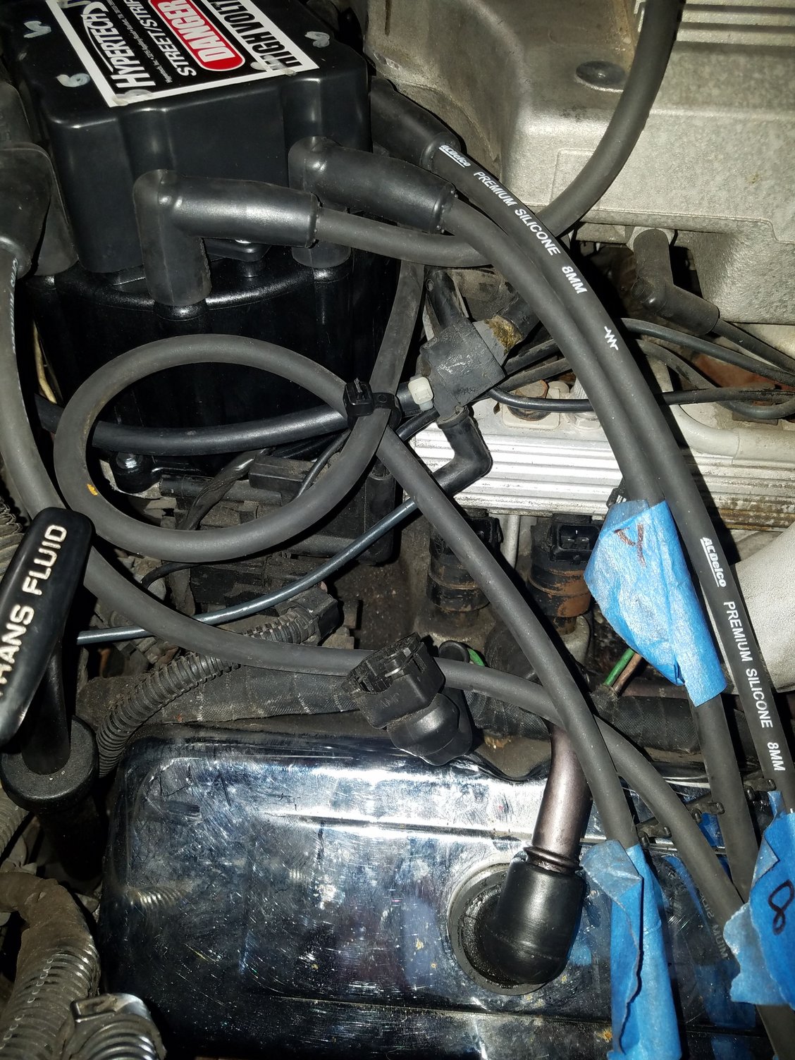

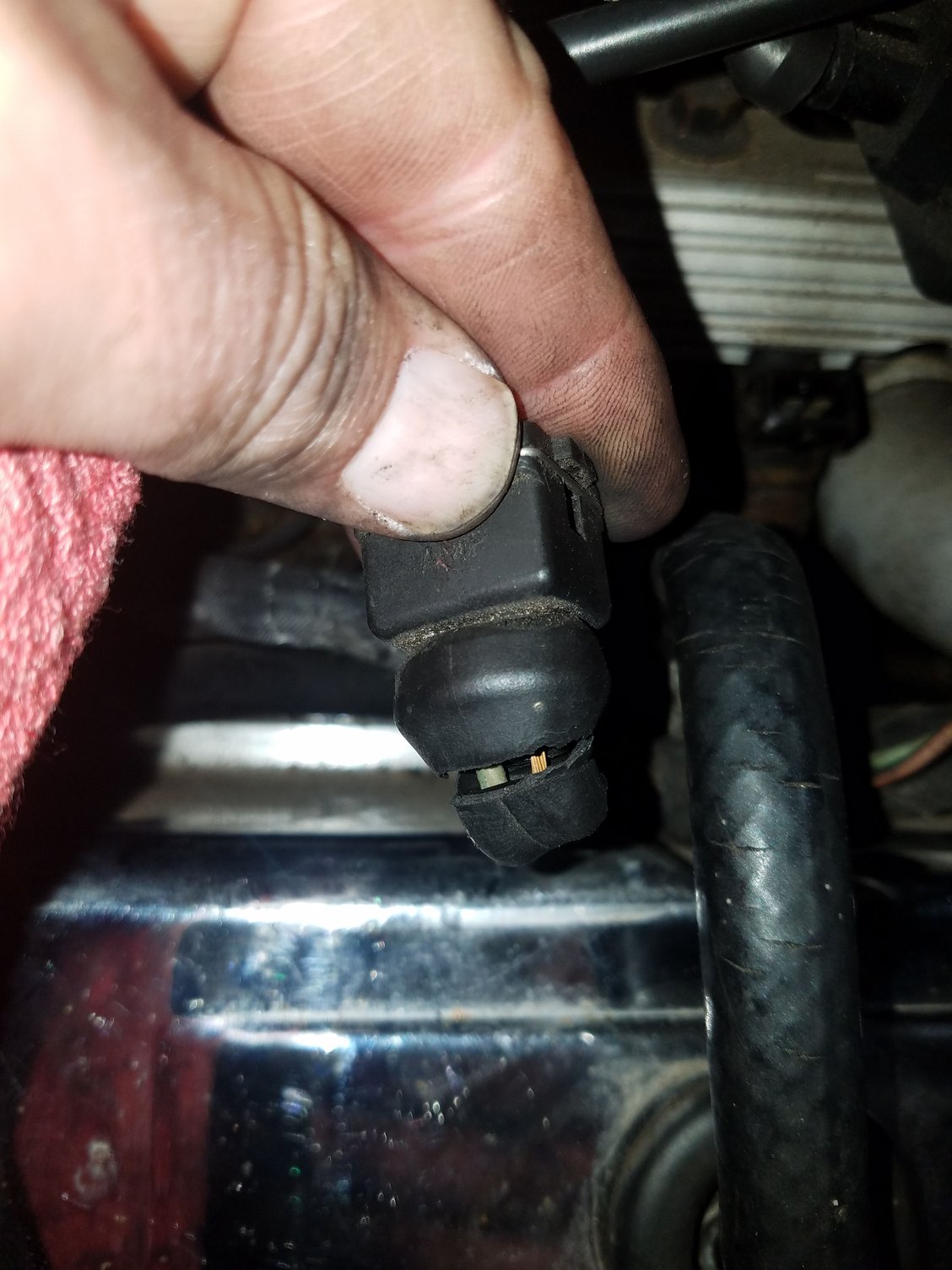

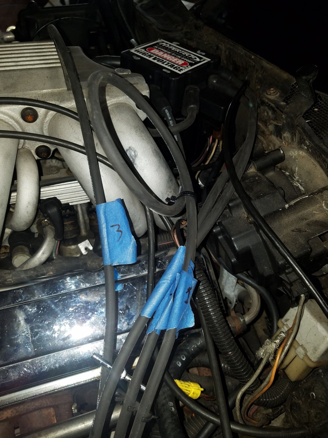

Ok,
here is where I am at. I have spark, ohm tested the wires, all are good, replaced distributor cap, rotor and coil. What I found was the #8 cylinder was not firing. Pulled the plug and it was wet with fuel. Checked for spark, and had that. Ohm tested all of the injectors and got 18 or 19 for each. My next step is to replace the injectors. Probably clogged. Any suggestions would be great. The boot to the injector wire for the #1 cylinder tore,🤨🤔. Wire is intact I think
. Looking forward to everyone's wisdom.

You can clean and or buy one single injector and make sure to fix that connector, that was my problem but my cylinder was dry.
My suggestion would be to confirm that you actually have a bad injector. You said the spark plug for the dead cylinder was wet with gas....how does that jive with a bad injector?
I would remove the fuel rail w/injectors intact, place them in bottles or over rags, then crank and see which ones are actually dispensing fuel. On your TPI, 4 injectors on one side should fire, then the other side, back and forth twice per revolution of the crank. It should be super obvious which are firing, and which are "piddling", or not doing anything.
I did this test on an L98 a while back, and 5 of the 8 injectors were plugged. That car wouldn't start....but my plugs weren't wet with gas, either.

Run a quick compression test on #8 to make sure you have enough compression to fire the mixture. You have spark, fuel but no ignition.
