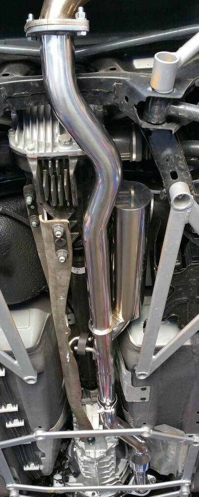

was this you barchetta? do we know who this was?
so many questions.

Cool project. I have noticed a lot of aftermarket exhaust (high end) are using the same concept to address drone. Personally I like the look of the Corsa tips over stock and they address drone. We all have out motivations and preferences, cool use of knowledge to achieve a goal.

No, I do not know who he is yet but he did respond to me on you tube and added quite a bit more information.
In regards to Corsa, this is not for someone willing to spend $1500 on an exhaust system. If this is you this is not a thread you will be interested in.
Other than Corsa I do not know of one manufacturer who uses this method to address drone, so if you know of one please pass it on.
Old Jan 3, 2020 | 11:15 AM

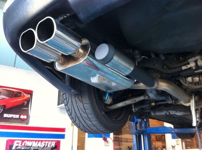

Who is the manufacture in the photo? What is the cost..? this modification if DIY would be under $100.. Im going to get a quote to have it done as I cannot do it anymore after my injury.
so who makes this one pictured above?
It's not for a Corvette. I have just seen these canisters utilized in other systems. Mainly imports. This particular one is for a 350Z.

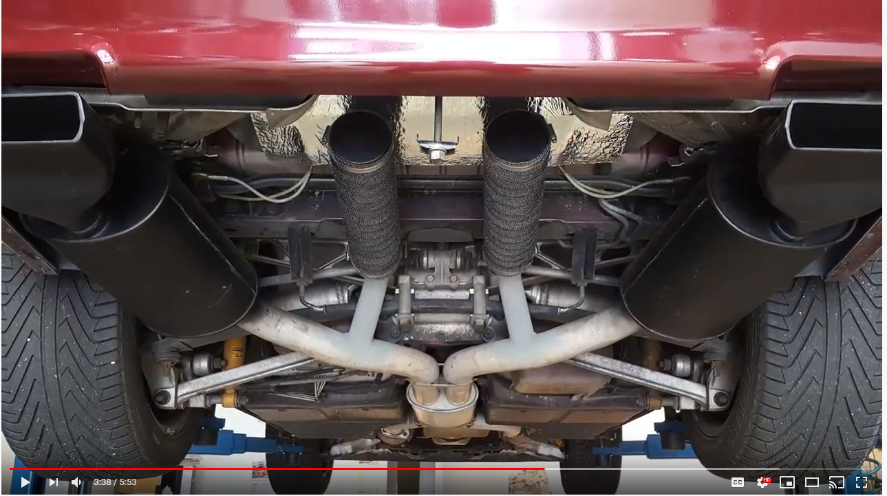

The early rear y pipe that corvette central sells with the crossover tube actually does mostly eliminate the drone. This is pretty cool either way. Just a bit of tuning required to get it exactly right. It will vary car to car.
Interesting on the y pipe.. I'll look into that.. I was referring to their no drone muffler for the l98. it has a very short tune chamber inside the muffler.
As far as I can tell it really doesnt vary from car to car.. if you meant by that vette to vette.all V8s are going to be the same.. The equation has no reference to horsepower or displacement or anything like that. Essentially all V8's will require 33".. the larger the chamber the more attenuation you get.
You can verify this with a frequency analyzer however which he posts a link to.. I installed on my phone but havent tested mine yet but I expect it to be 100hz as well. anyway, once you measure and confirm its just math.. no tuning is required. Its one of those go big or go home deals with the size of the chamber however. The larger the diameter the more volume it can absorb is the way I am reading it anyway.

I really dont like how close it is to the plastic fuel tank on his but its probably not a big deal.
