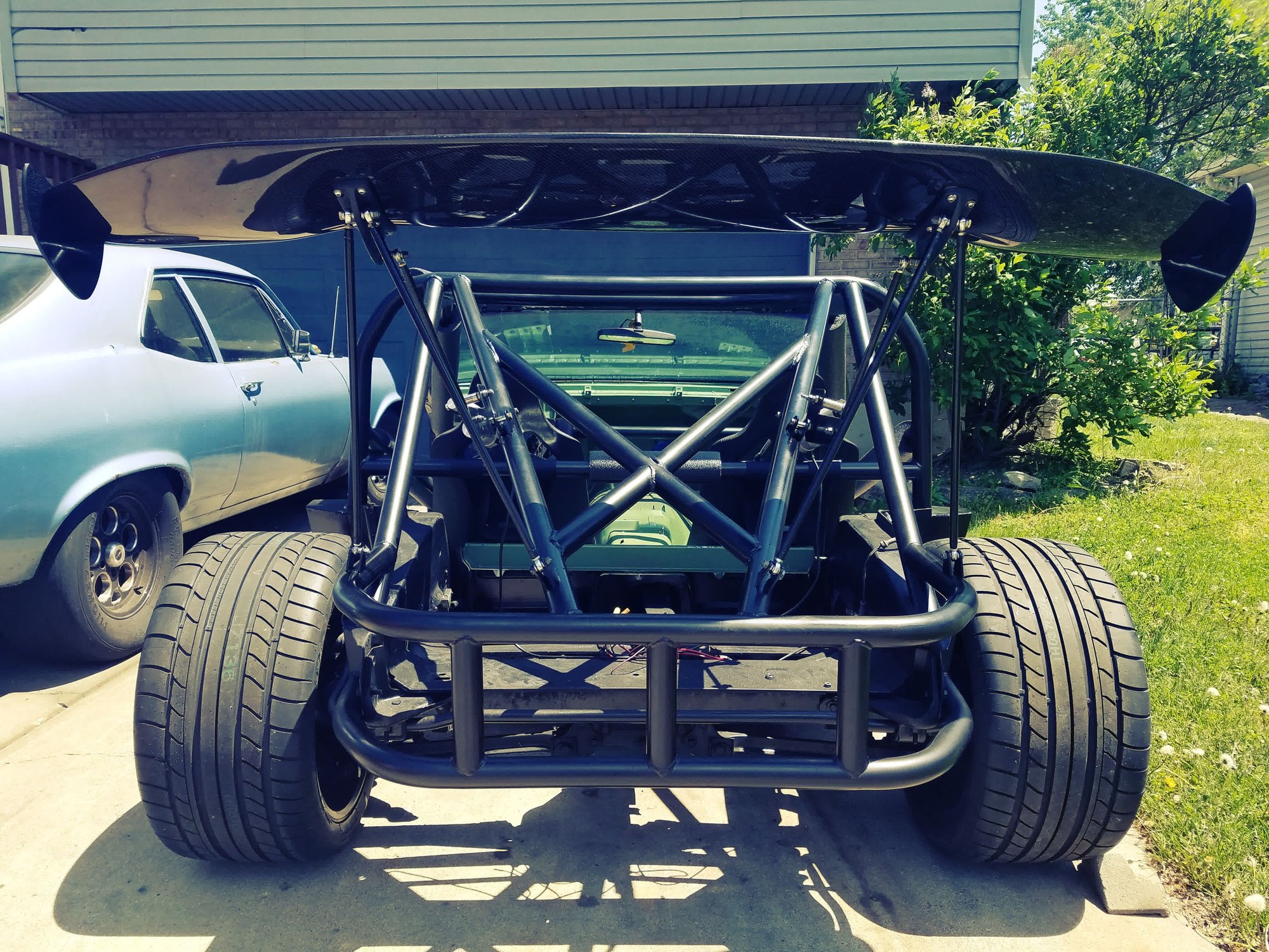

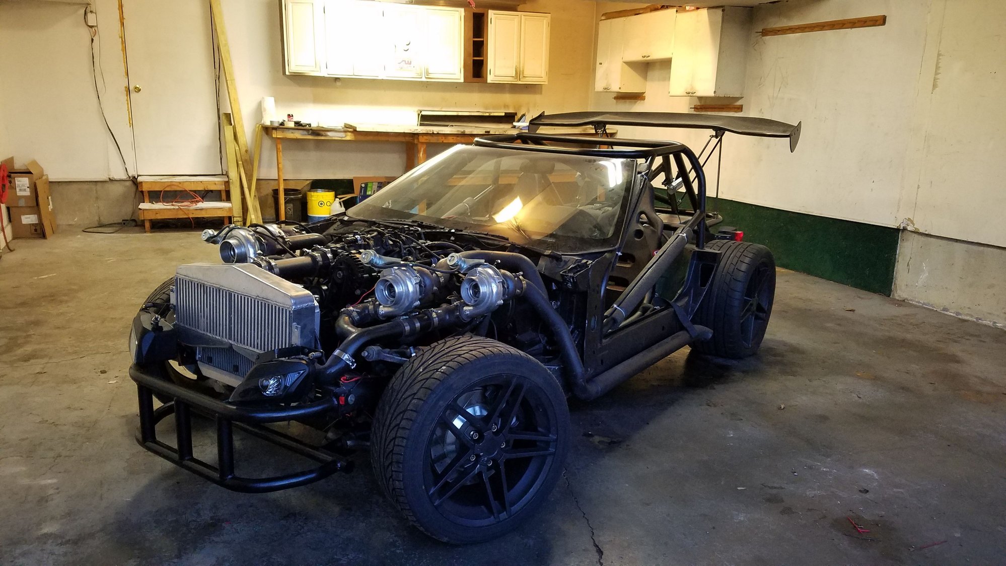

My cage (minus wing) fits inside of a completely gutted stock body. That is gutted doors, roof, and removed stock gas tank and everything inside of the rear bumper.
A 12 point cage seems overkill. Stick to a 6 or 8.

EEP. Joe your car would be enough to pants my vette and scare it into the hills buck naked . That's about as American Proud a c4 ive ever seen! cage is beautiful. will use it for notes!

It you are building a cage to race with, I wouldn’t.

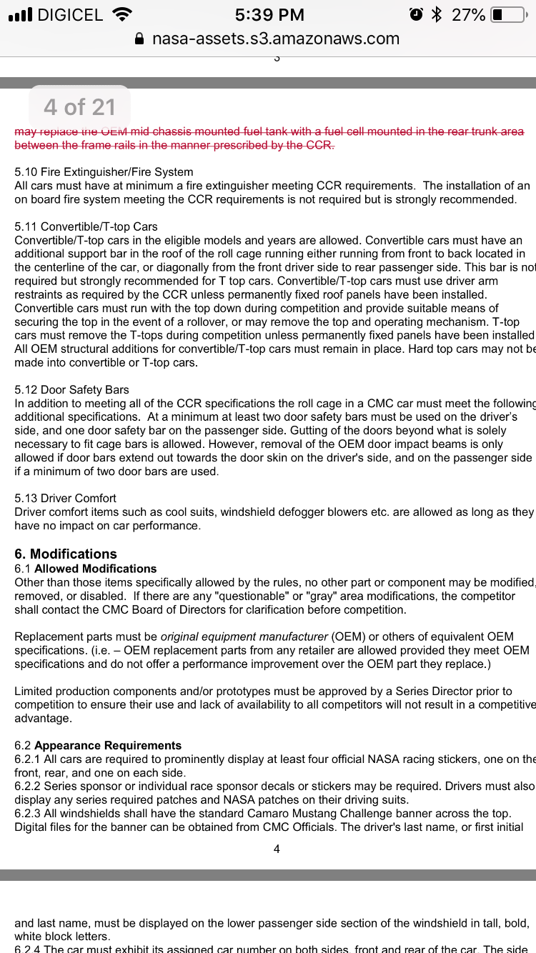

Your entry/exit area. In a race car, there will be a requirement for body panels and a roof skin. The existing angle severely limits exiting quickly.

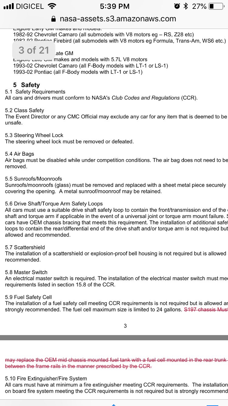

I've raced NASA before and you're right, it is a requirement for them.

So, I would fail your cage in tech in a full bodied car based upon being able to exit the car rapidly.
