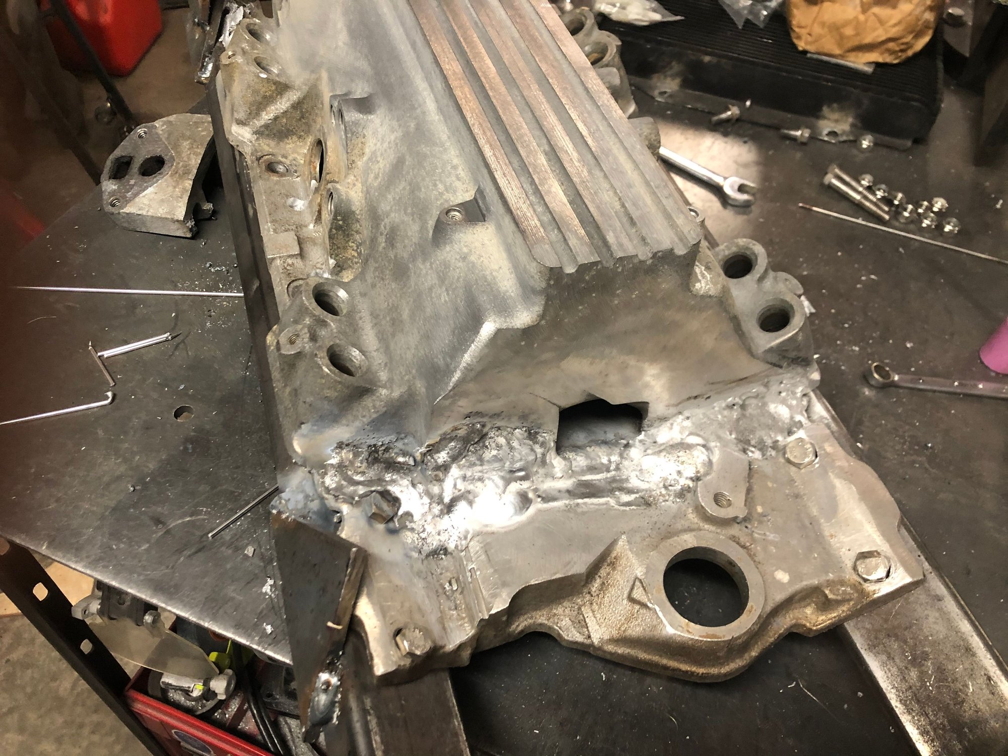

heres the curve ball: I’m currently fabricating an lt1 intake for it:
Thats the rear piece of an L98 lower intake mated to the rear of an lt1 intake. That's just the first pass, so the welds are pretty gross and theres a lot of crap baking out of the cast as I TIG. Theres lots more work to do to it, but you get the idea.
