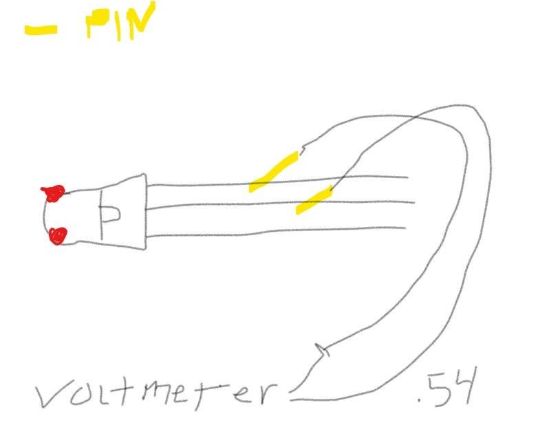

should I be sticking it into the plug connector or the actual tps prongs?
Old Mar 22, 2020 | 11:46 AM
Brandonvette's Avatar
Brandonvette
Joined: Oct 2019
Posts: 150
The back of the plug where the wires are goin in to the plug while it's still plugged in to the tps you tube a vid you'll see

xrav22's Avatar
xrav22
Joined: Mar 2013
Posts: 1,952
Likes: 239
From: Venice Cali.

Hi, very useful article. Please can I still question, setting 0.54 is when the engine is hot or cold. Thanks for the message

Thank you for the information . I know the procedure and I applied it. However, the voltage varies slightly depending on the motor temperature. Is the sensor bad? Thanks
