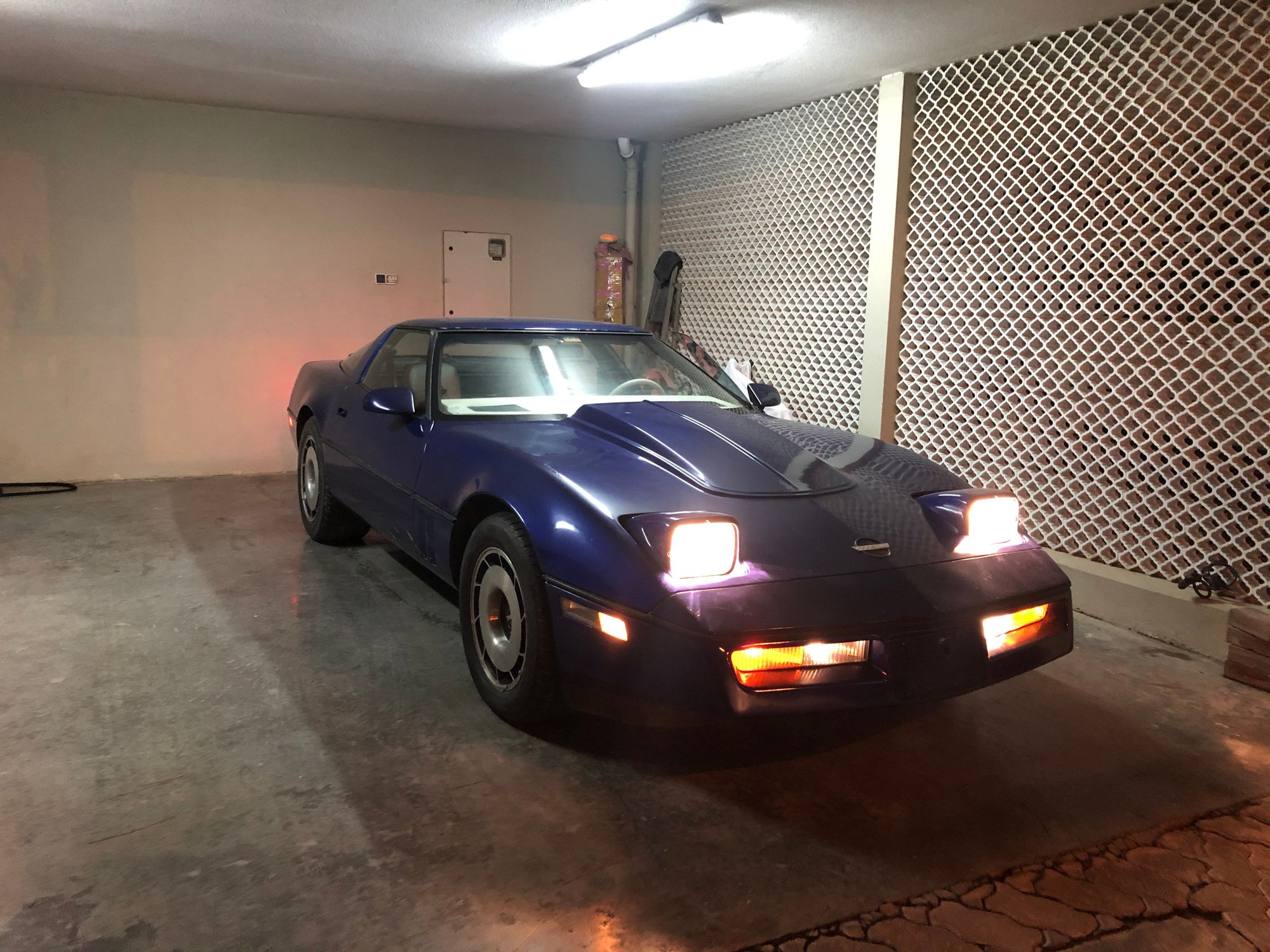

Hi all,
i am just checking in and enjoy reading some great posts about 84 vette. I recently swap my 97 mustang GT with 1984 corvette. It was a clean swap, but my stang was all fixed up and ran perfectly, wilst this z51 package vette is in decent condition but needs a lot of work.. 119000miles, ok exterior, ok suspension and interior, Mechanically so far all seems good and the car runs solid. One question tho.. i have no thermac cover, the TBIs are just having 2 air filters and that’s it. All hoses also that should be connected to the thermac air cover are open. I mean pcv valve system is there, breather hose and smog vent is there but they are not built into air filter housing, as it is missing.. i opened both air filters and watched both injectors perfectly spraying fuel. It does sound as there is a vacuum leak but not sure. Can i run the car like this? Do i need eventually an air housing? Please don’t mind me asking perhaps silly questions..this is my first vette and i have very limited mechanical knowledge, although willing to learn..
Oh and yeah i don’t have any cats, just straight pipes connected to the headers.

thanks so much for that, i was hoping it can be repaired and saw it was different to newer c4. (Watched chris fix repairing his 94 and looked pretty complicated especially opening the motor and changing the gear..)
When i got the car it was working all good, but when checked recently, passenger side was not working now. Not sure if my extensive washing of the engine bay could have caused some connection problems. 😬Or as you said some dirt or something could have also caused it. Anyhow the link you provided is super useful so i will get on the task!!

so a little update on my headlight: i decided to strip the headlight and check that motor, but before that, i just wanted to fiddle a bit with that manual turn **** after i saw on video on youtube where the guy said that the **** should jot be tight but loose. When i checked, mine was very tight on the passenger side (which was not working) whilst on the driver’s side was loose and could easily turn it. So i put a little force and managed to turn it few degrees just to loosen up. Then i tried the lights and voila!! Bothe flipped like they should!! Not sure what really happened and id i just fixed something temporarily but hey it worked!! 😃

I've owned my '84 for 16 years, so I hope you'll consider me experienced on the '84. I don't understand your source that said the **** would normally be easy to turn.
As a test, If you first disconnect your battery, you will find that the headlight doors are jammed against the hard stops at the end of their travel, so it will be normal for the ***** to be difficult to first turn, You can easily try this yourself.
With the battery connected during normal operation, the torque of the motor is adequate to spin the motor away from that initial "jammed" position. Since the motor in your car was apparently not making any noise when it was jammed against the stop, that tells me there was no power applied to your motor.
By moving the manual control **** as you did, you relieved the pressure in the gears, which allowed the limit switch to move, causing power to be applied to the motor, and the motor to spin and the door to open.
During "normal" operation with the headlights off, the door would be closed. If you try to rotate the ****, the limit switch would detect that the door isn't quite closed, so power would be applied too the motor to close the door, and the **** would return to its normal "closed" position, making the **** impossible to turn!
If the headlights are on, the door would normally be open. If you tried to turn the ****, the limit switch would detect that the door was not quite open, and power would be applied to the motor to open the door! This would make the **** impossible to turn! You can easily try these tests, too.
My conclusion for your headlight motor problem: A dirty limit switch.

umm starting to understand how these lights work (slowly must admit but at least starting..&#129299 thanks for detailed test it does make sense..
Well, i guess i stated it wrong and in his defense, he (my source) said this whilst the motor was out of the car.. 😃
This **** he said should be loose as he put 2 housing holding the motor assembly back together and as they were firmly pressed against the rotor, he could not turn the ****, so he had to loosen up the last 2 housing screws in order to be able to freely turn the motor with that ****. (jerr spud on youtube)
So i just played a little and it worked.. so i can conclude that maybe i just freed a bit some dirty connections,but the problem probably remains the same as you stated and this is a dirty limit switch.. i will have to take it apart at some point and clean..
