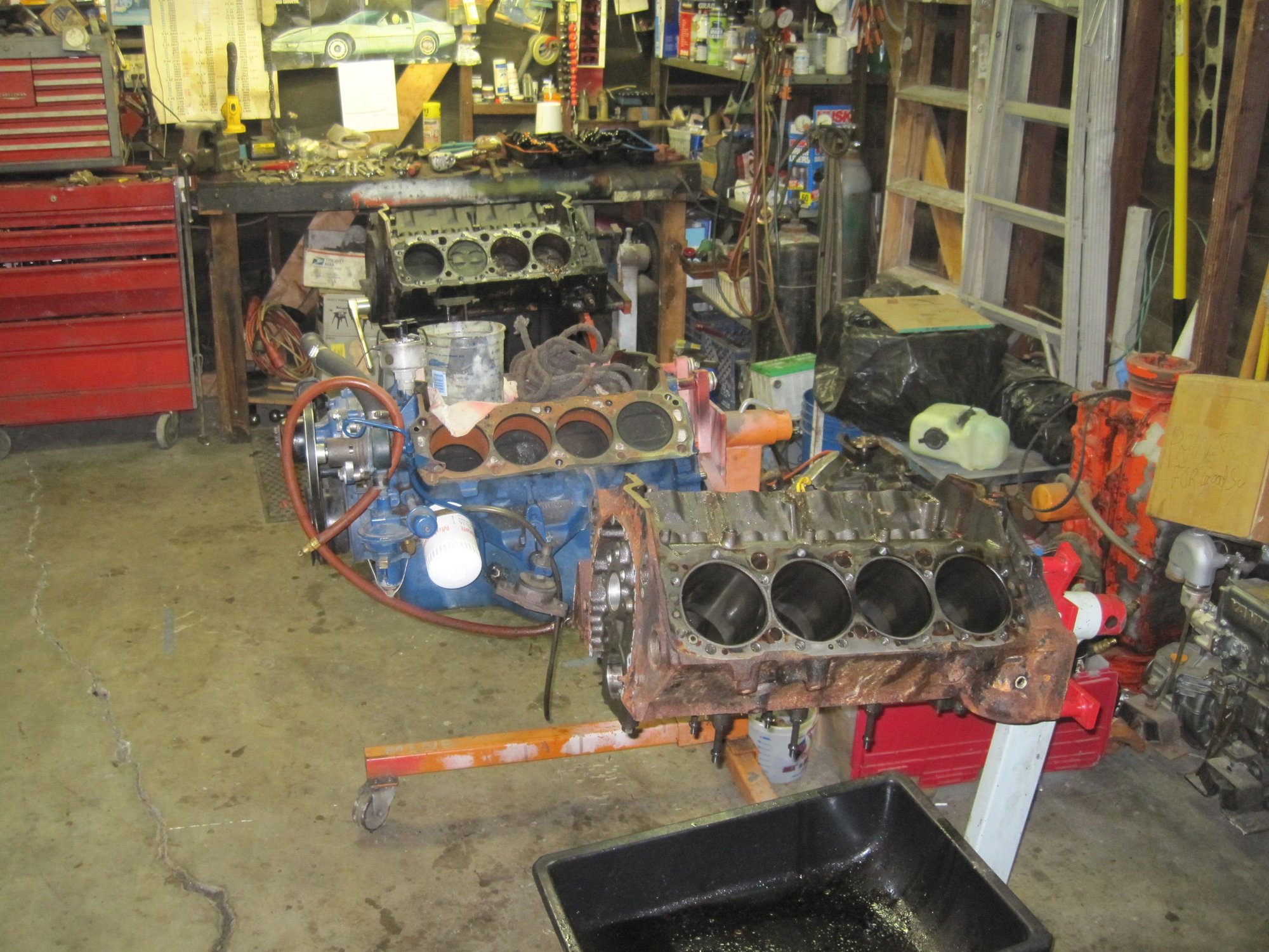

I work on "marine engines". The two Chevrolet's are Mercury Inboards, circa 1998, and the Ford is a 351 ci Commander Inboard for a tournament ski boat. Against the wall the orange engine is a 6 cyl Diesel for a 70' sail boat, and a 2 cyl Yanmar for a 34' sailboat. The picture was taken in my home shop in 2012. All 3 engines were for paying clients. I don't know the current status of the 351, but I still maintain the Chevrolets. They have about 350 hours since the overhauls, I set the lifter pre-load exactly the same way I've been doing it for 40+ years on car engines, and the valve covers have not been off since 2012. If mercury does do it differently, it hasn't shown up in dissatisfaction in my client's ownership experience. We've had almost no trouble with the engines in 7 seasons. He's happy, so I'm happy.
Oh please, do tell me the differences in setting hydraulic valve lash on a Mercury, or on any "marine engine".......
nice
My only recent experience with motors of the F family was a 460 with a pedestal mounting system for the rocker arms; the only "adjustment" was adding shims under the pedestal till the piston in the lifter was down in the lifter body a set amount (0.080" if I recall). Adjusting that valve train was a not easy; Thankfully, a Chevy valve train is sooo much easier to adjust.
Then why does my LT4 also uses a non adjustable pedestal style valve train, can someone explain that to me?.
