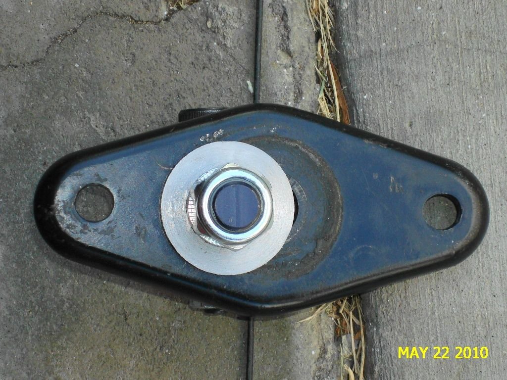

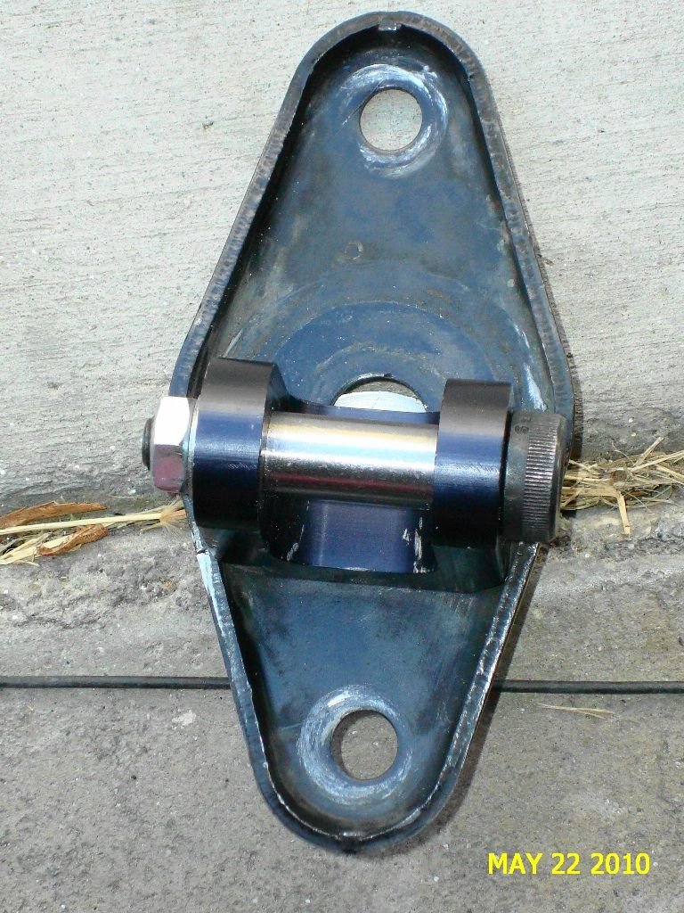

This is what I did ten years ago.
Van Steel now sells those brackets ready to bolt-on.
To install this bracket on the 84-87 ; the original welded bracket needs removed. The rail will need modified for the bracket. The 88-96 uses a stud on the end of the shock, it mounts to a plate bolted to the rail.

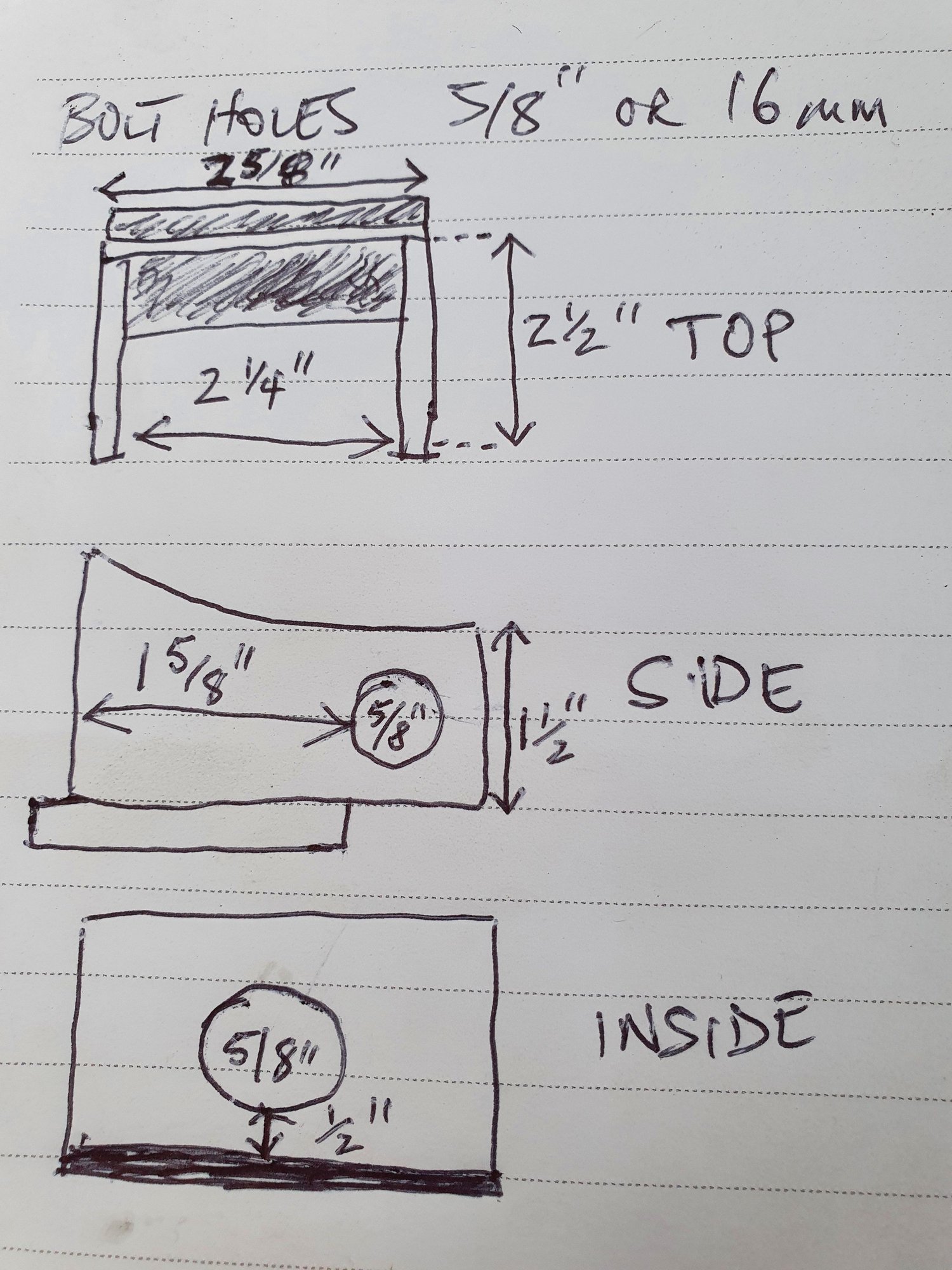

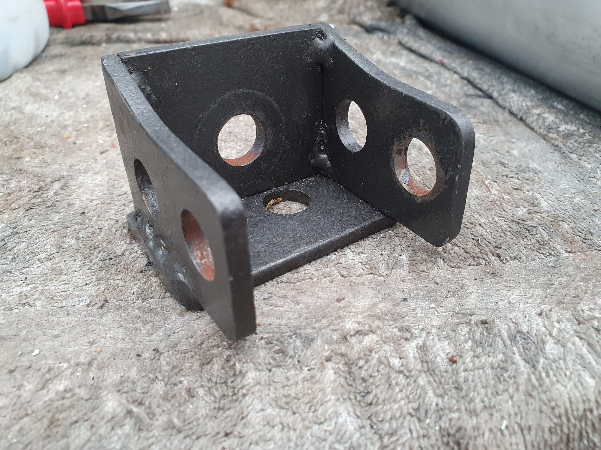

Yedister, here are the measurements of the bracket to be able to adjust the rear coilover unit forward and aft to get the spring to miss the axle.
The 2 1/4" inside measurement between bolt holes allows you to place the shock in position so that the spring clears the axle, then measure and make spacers to suit.
the extra holes are just there to lighten.
