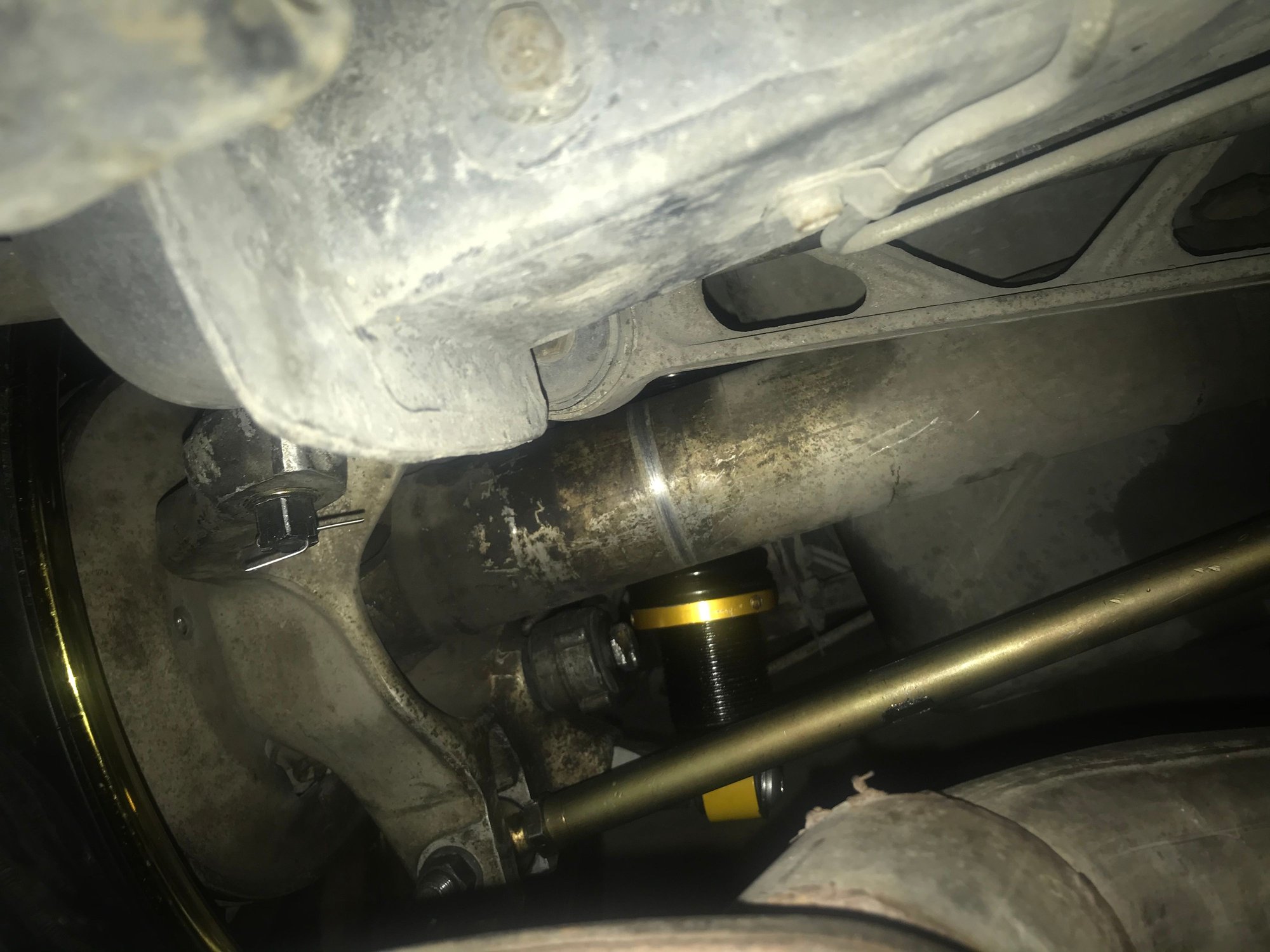

This is the driver side, it did this on my way to the alignment place a week or so ago, I turned the spring and it gave me better clearance, the passenger side initially didn’t scrape, but after my most recent test drives will scrape enough to hear it while turning
I'm removing the cheap adjustable camber bar you see here, the adjustable bar is almost impossible to turn on the driver side, the passenger moves freely. I've ordered the EM heim jointed camber arms to replace these.

Not exactly what I was expecting. I would mount the spare and roll on ramps. Then see how it all fits together. Is upper shock mount bracket adjustable?

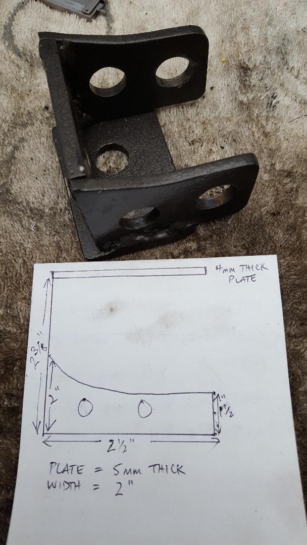

On the left rear you need a bracket like this so you can slide the bottom of the shock forward just enough to clear the axle.
you need at least 10 mm of clearance at static position between spring and axle.
Merle certainly didn't tell me that. I called and did my homework the best I could and I never found or was told anything about the bottom bracket needing to be pushed forward on the rear knuckle shock bolt. I'll try my stock bolts and see if I have any luck since I certainly don't have the tools nor the skill to fabricate something like that.
