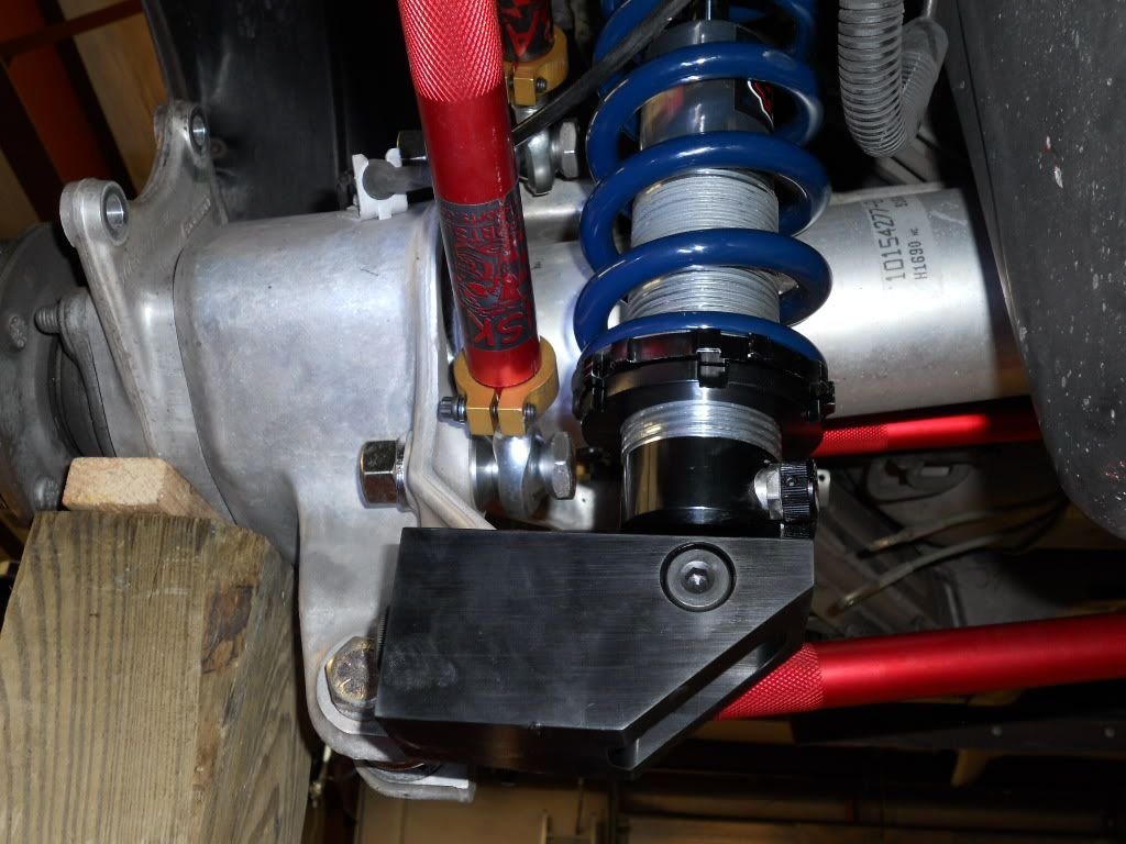

For rear coilovers this type of mount is the only one I would trust. A bracket that uses the bolts for both trailing arms and stock shock mount. Possibly use camber bracket bolt also. Then you can move the coilover away from the half shaft without over loading the stock shock mount.
https://www.corvetteforum.com/forums...post1595662368

Midnight custom made that bracket I've seen something similar http://www.streetrodgarage.com/c4cor...untingkit.aspx, I'm not sure it would work since these seem to be for frame swapped cars, perhaps someone more knowledgeable than me can chime in

I keep saying to people these cars are different left to right, if you do a coilover setup on the front on the early car you will find differences there too.
these are handbuilt cars from the 80's, if you want precision buy a Porsche
The best option Justin (not taking into account the cost) is to buy the Vansteel brackets, they were made to achieve that clearance.
https://www.vansteel.com/index.cfm?f...&subgroup=1972

I never realized before now that these brackets actually move the shock forward, but it looks like they do slightly move it forward. However, my concern with using them with shocks that have a standard OEM lower mount instead of a heim joint mount is twofold:
  1. Does the standard mount fit inside the "pocket" of the Van Steel bracket? One would have to measure, but I'm thinking the stock shock mount is too wide to go in there.
  2. The Van Steel bracket changes the shock's mounting bolt from lateral to longitudinal orientation. With the more severe arc described by the short trailing arms (relative to the much longer camber arm), I'm not sure a rubber bushing in the lower shock mount will allow adequate off-axis flex without binding. The heim joint has no problem at all with this.
Given all of that, the better option would probably be to send all the EM kit back and get the Van Steel kit, which has shocks designed to work with their bracket (using heim joints at the bottom). I've heard zero complaints from anyone about their setup. The other kit that addresses this issue and does the best job of strengthening the knuckle is the new Ridetech kit. It uses a steel brace/bracket along the lines of the one JoBy linked from Midnight_85.

I think these have the same issue that the Van Steel or Ridetech brackets would have: they all turn the lower mount bolt axis 90-deg so that it's oriented longitudinal (front-to-rear) instead of the stock mount's lateral orientation. They are all intended to be used with dampers that have a heim-jointed lower mount, whereas you have rear shocks with a stock-style, single-axis bushing mount. My concern would be about bind:
  • If you can't get the upper shock mount moved forward enough such that the shock is not in bind at resting ride height, then I think you'll have problems with bind and wear on the seals of the shocks (the shaft will always have a bending moment on it). The Ridetech kit has upper mounts that acheive this, even though their shocks have heim-jointed lower mounts. This Street Rod Garage set does not come with upper mounts to help with that, and I don't think your EM kit does either.
  • Even if you can achieve the proper alignment at static ride height, the shock will see a lot more off-bushing-axis (fore-aft, in this case) movement with compression/rebound than it would with the stock lateral mounting bolt orientation, because the trailing arms are so much shorter than the two lateral links (camber rod and halfshaft). So I'm concerned you'd still run into bind and bad shock wear.
  • I could be wrong about this - if your rear shocks have enough rubber in their lower mount bushings, then maybe they can absorb the off-axis movement without much bind. You can get a sense of the amount of bind with a test. First, determine how much forward you'd need to move the lower mount: 1/2", 1", whatever you think. Then disconnect the top of one shock and try to move the top of the shock left or right (to center or outside of car) by that same distance. How much force does it take? That's the amount of force you'll be introducing to the shock just resting. Then as the suspension compresses and rebounds it will probably add close to another inch of forward travel (depends on the exact ride height and angles of your trailing arms at resting height); so move it that much further. If all this feels like just a couple pounds of force, then it's probably okay. If it takes many pounds of force to move that 1.5-2", as I suspect it will, then I think ti will cause problems with handling and premature shock wear.
I'm still of the opinion that this EM kit is defective for you application, and therefore you should have the right to return it for a full refund and choose another option. The wear on the spring is because of the defective aspect, not because you did anything wrong! It's ridiculous that you're having to spend lots of time and money to cobble together a workaround. It's also ridiculous that you can't actually adjust the ride height on these things: that's literally half the reason to use coilovers in the first place! Get rid of this crap! The only good option I can think of is to modify your shock towers per a few other threads on this forum, or to figure out a way to fab a lower rear mount that keeps the lateral orientation of the mounting bolt but moves it forward enough to clear the halfshafts. But that's going to be a ****-ton of work, you have to have someone you trust to weld properly, and I'm not sure how to actually design it so it's strong enough.
