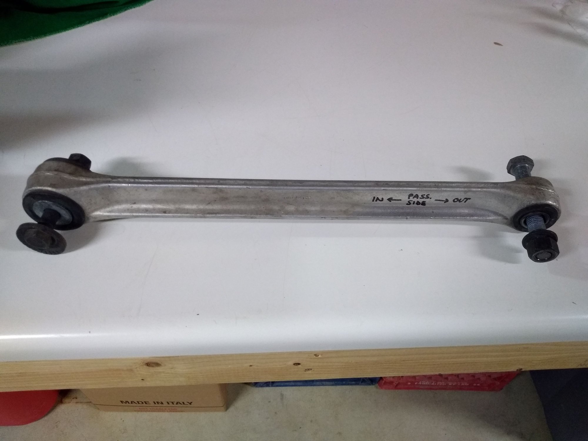

By the way, are the "camber bushings" you refer to the same as the control arm bushings?

This is a pic of the camber rod, it has a rubber bushing on each end. One end is by bottom of differential, other is near lower rear shock mount. Either one being worn wear the rod can move more than designed can cause the issue you describe. This "may or may not" be your problem, but worth looking closely at.

I get it. My Haynes refers to this as the "spindle support rod" (There is no control arm like on the front). I should also check the "control rod" bushings. It so happens I too have a '04 CE Z06. I think it is # 1999. In fact, I have a video on YouTube- "C5 Harmonic Balancer Supplemental, Part 1 and 2" -
