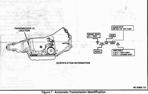

In my 93 FSM on page 7A-15A-3 is a chart with different models of the 4L60 transmission and the speeds at which each gear shift takes place. I can't find any information about these different models. Does anyone on here know anything about these different models? There are 25 different models listed in the chart. There is one model HLM that shifts from 3rd to 4th at 56 - 63 MPH which would be perfect for me.
Depending on axle ratio you should have a YCM (2.59) or a YDM (2.73 or 3.07) transmission I'd think.
*** That's assuming originality.
Do you know what those codes mean? I have a 2.59 axle ratio according to my RPO code. I could find any information on model numbers.
If original it should be YCM and use YCM info for diagnostics!

***See page 0A-5 in the FSM for ID location and explanation. (IHBD) - Don't look to be vertical to me!

Likes: 750
The different transmission codes are for all the 700r4 (4L60) different applications from 4 cylinder S10 to the Fleetwood. The transmission codes are probably listed in a chart in a parts manual or used part interchange manual. Corvette likely only uses two; 1 for the 2.59 and the other for the 3.07.
Thanks for the information Kevova, I can't seem to find anything on these codes. Were there only 2 differentials used in 93 for the automatic transmission?
