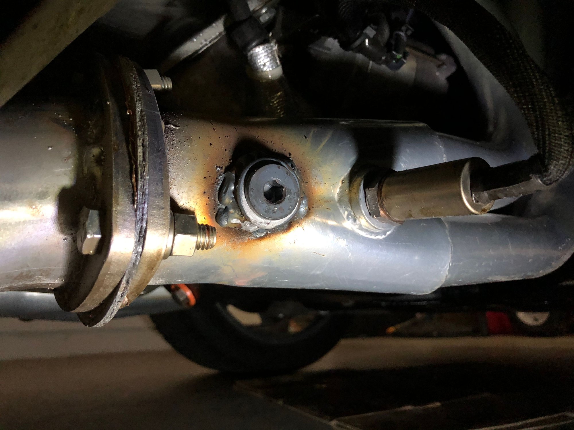

Default Less than great weld job
Originally Posted by FrankieD
Log this one
Frankie... photos attached showing one of the welded bungs as well as the small leak in the flange. I’m going to have checked by another welder...
