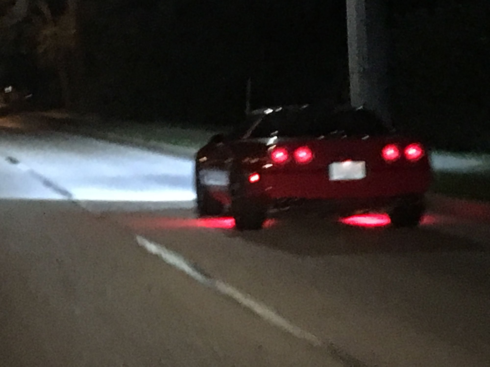

Two members have used the amazon light and are happy. Here is some not quality pictures of it at night going down the road
