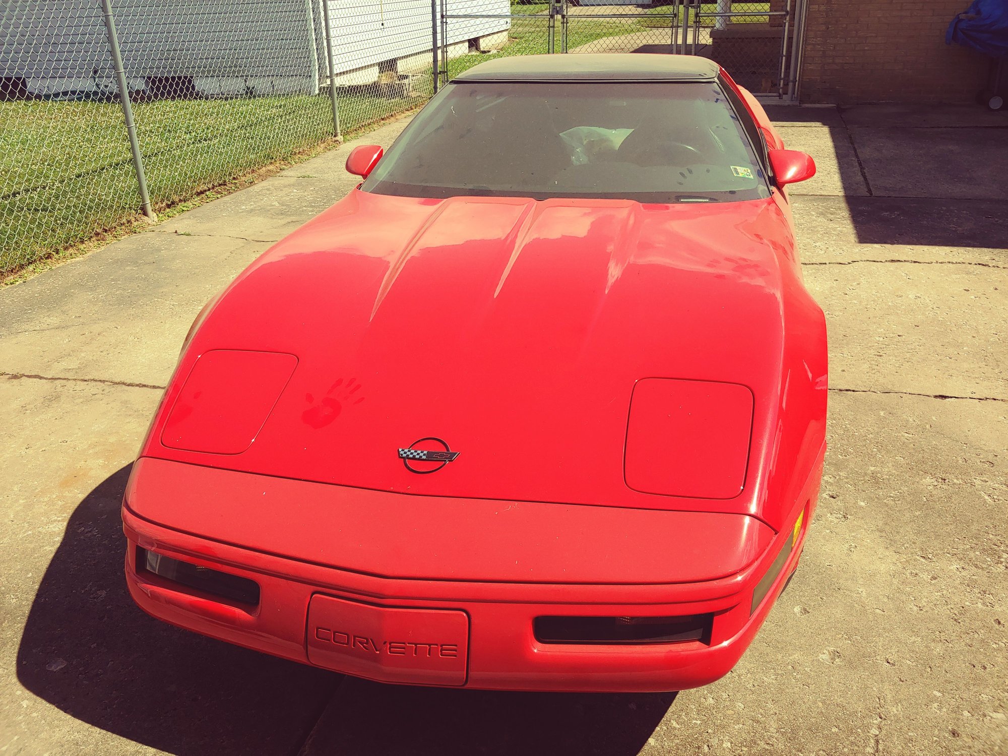

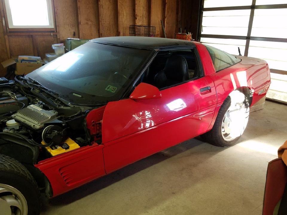

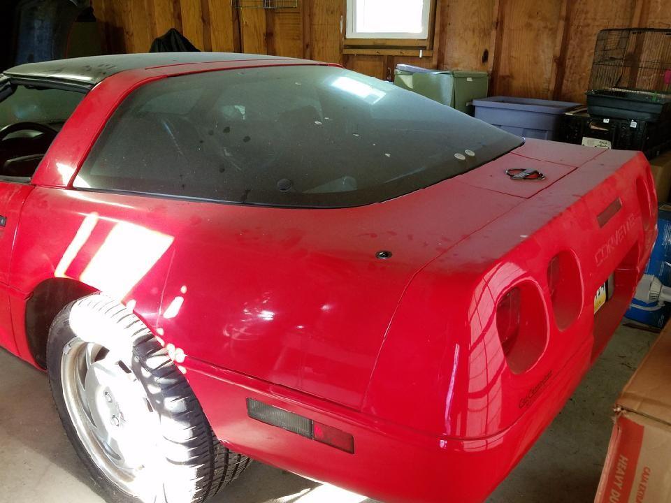

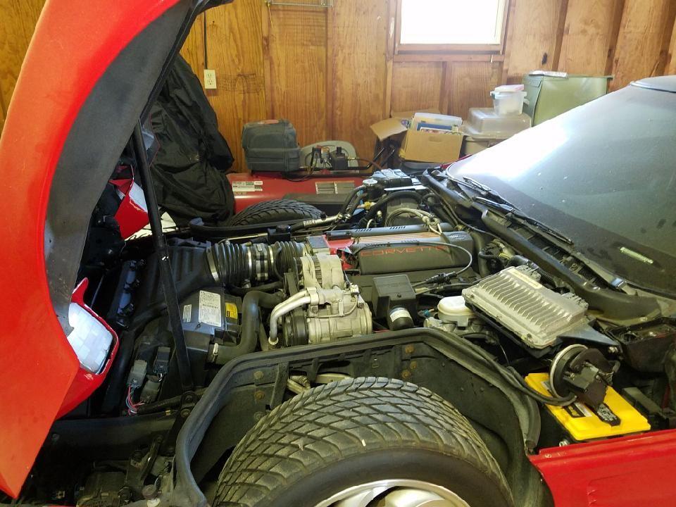

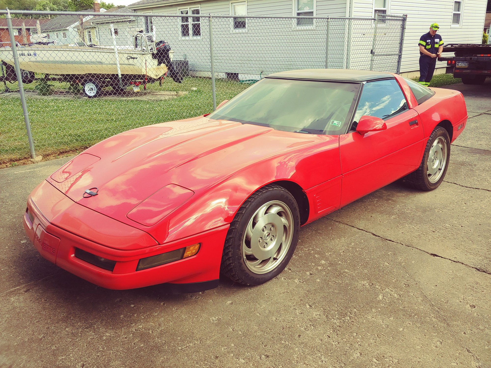

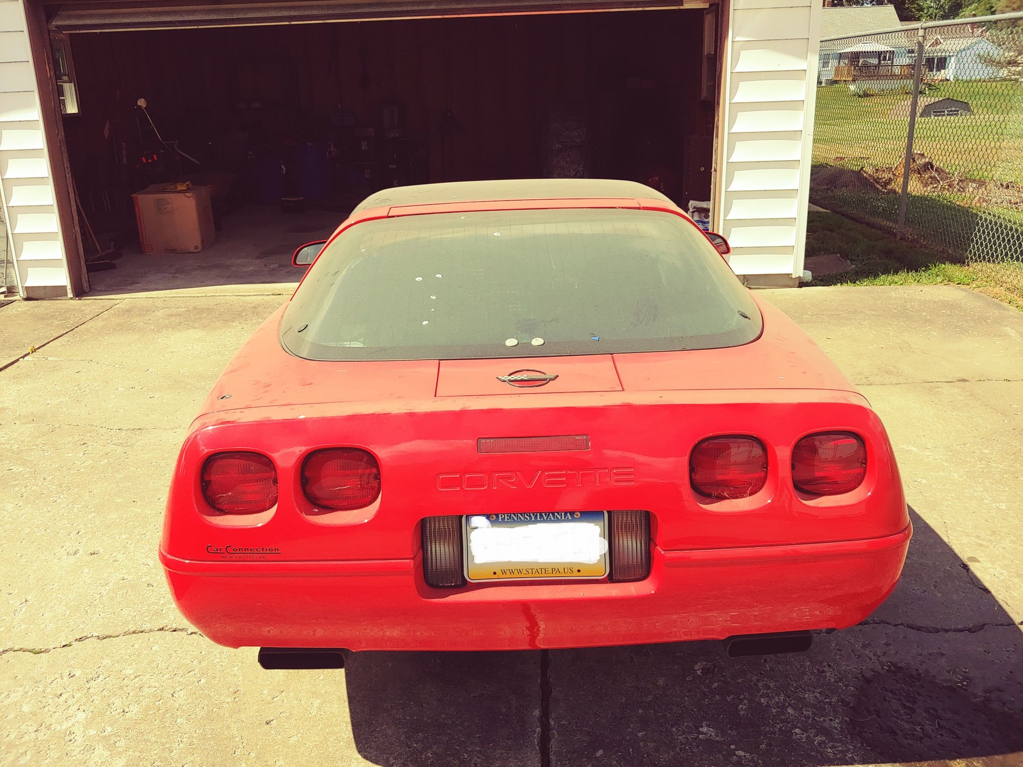

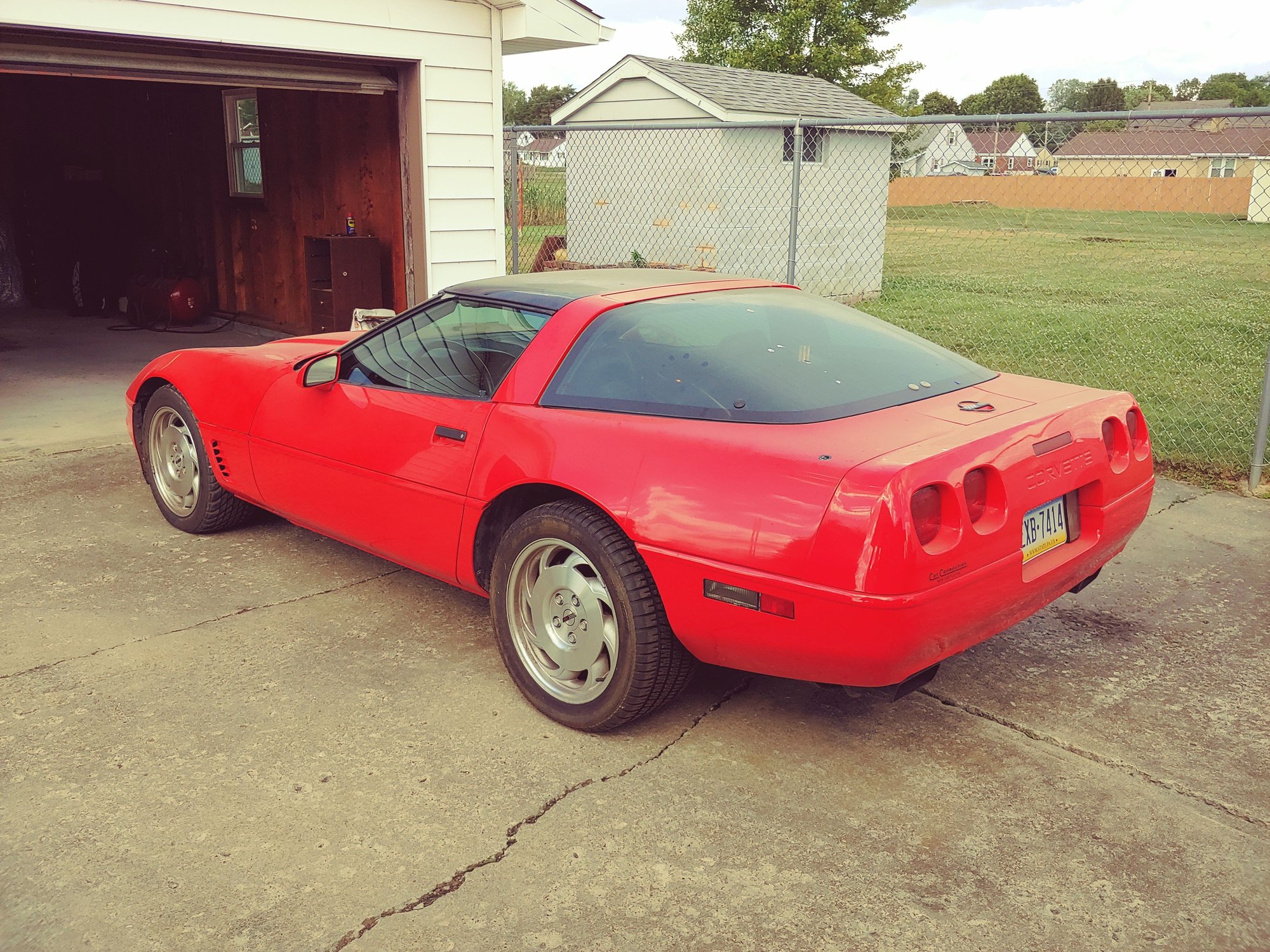

A friend owns a shop nearby and offered his help since it is staying in the family. I'm having it flat-bedded to his place. We are going to flush the tank and lines, change the filter, and clean everything out. We'll also check the belts and hoses and for anything else that might have gone wonky after such a long nap. I suspect the tires aren't worth trusting after all this time which is a shame, because they are factory spec Goodyears have all sorts of meat left on them.
Here's some terrible pics, but you get the idea.

Looking at the pix you posted, however, while the front tires look to be OE style GoodYear Gatorbacks, the rears do not.....
Good eye! Yes they do not match. I will be replacing all 4 for sure.

The front bumper just has dust on it. The paint isn't faded. The hood had been up for several years.
