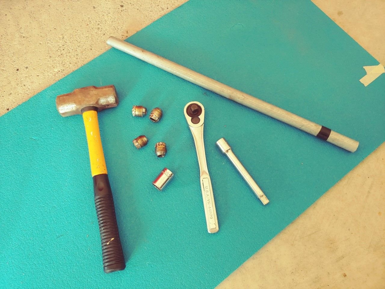

I agree with whaleman regarding the limited slip additive. Go to the Chevy dealership and get a bottle to add to the new fluid. These cars need the extra additive. You may need to siphon out enough to add the fluid but it will be well worth it. Then find a big parking lot and slowly do figure eights to work the additive into the differential plates. 20 or so slow figure eights should be enough then let us know if it helped.
Also wheel lock key was missing on my 92 when I bought it with the original tires so I followed the advice from a forum member and hammered a 12 point socket that was just a little too tight to go over the locking lug nut just enough so it grabbed the lug so I could remove it. Then hammered the lug from the socket and did the other three the same way. Replaced them with standard lugs like the other four and never worried about the key again. It was not like I was going to be leaving the car where there was a potential for the wheels to be stolen.

... I followed the advice from a forum member and hammered a 12 point socket that was just a little too tight to go over the locking lug nut just enough so it grabbed the lug so I could remove it. Then hammered the lug from the socket and did the other three the same way. Replaced them with standard lugs like the other four and never worried about the key again. It was not like I was going to be leaving the car where there was a potential for the wheels to be stolen.
Amcor shows the key in stock so I'm going to try that route first. There's no hurry and when I take the car on roadtrips I can sleep better at night. If for whatever reason that is a no-go, I will proceed with plan B.

That didn't take long at all. I was expecting a real struggle. Gives me very little faith in "security" of these devices. I think I'll join Dan's camp and go sans locks.
