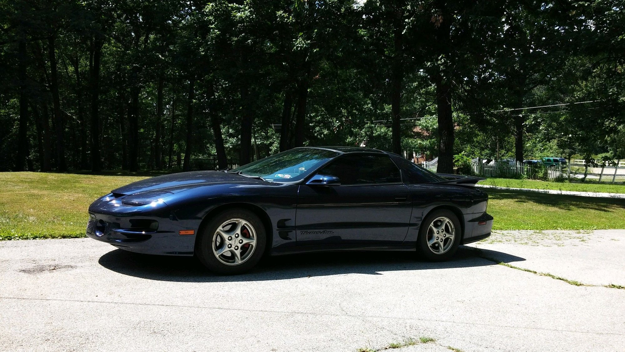

Totally agree with the F body platform over the C4 Corvette. Some really nasty Camaros and Firebirds out there.
