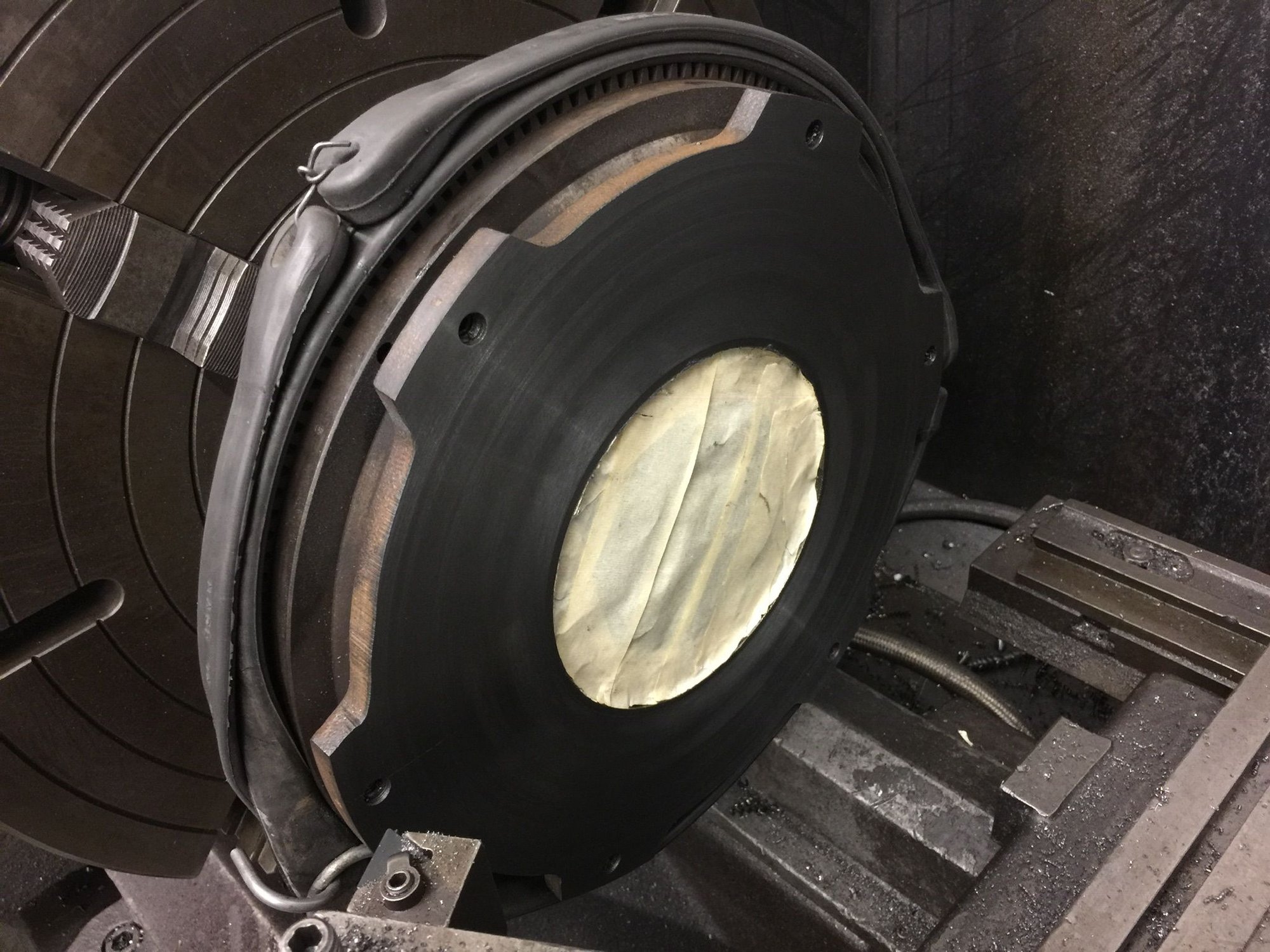

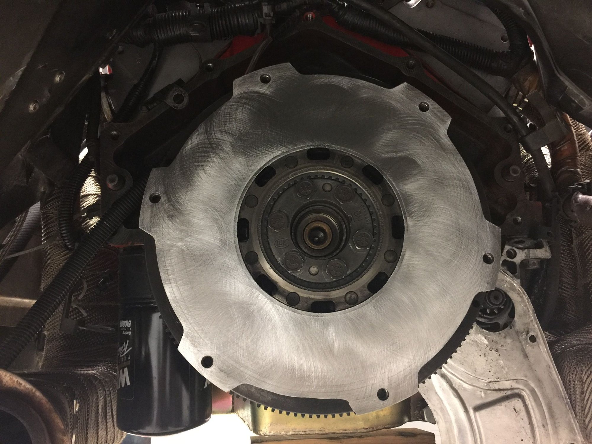

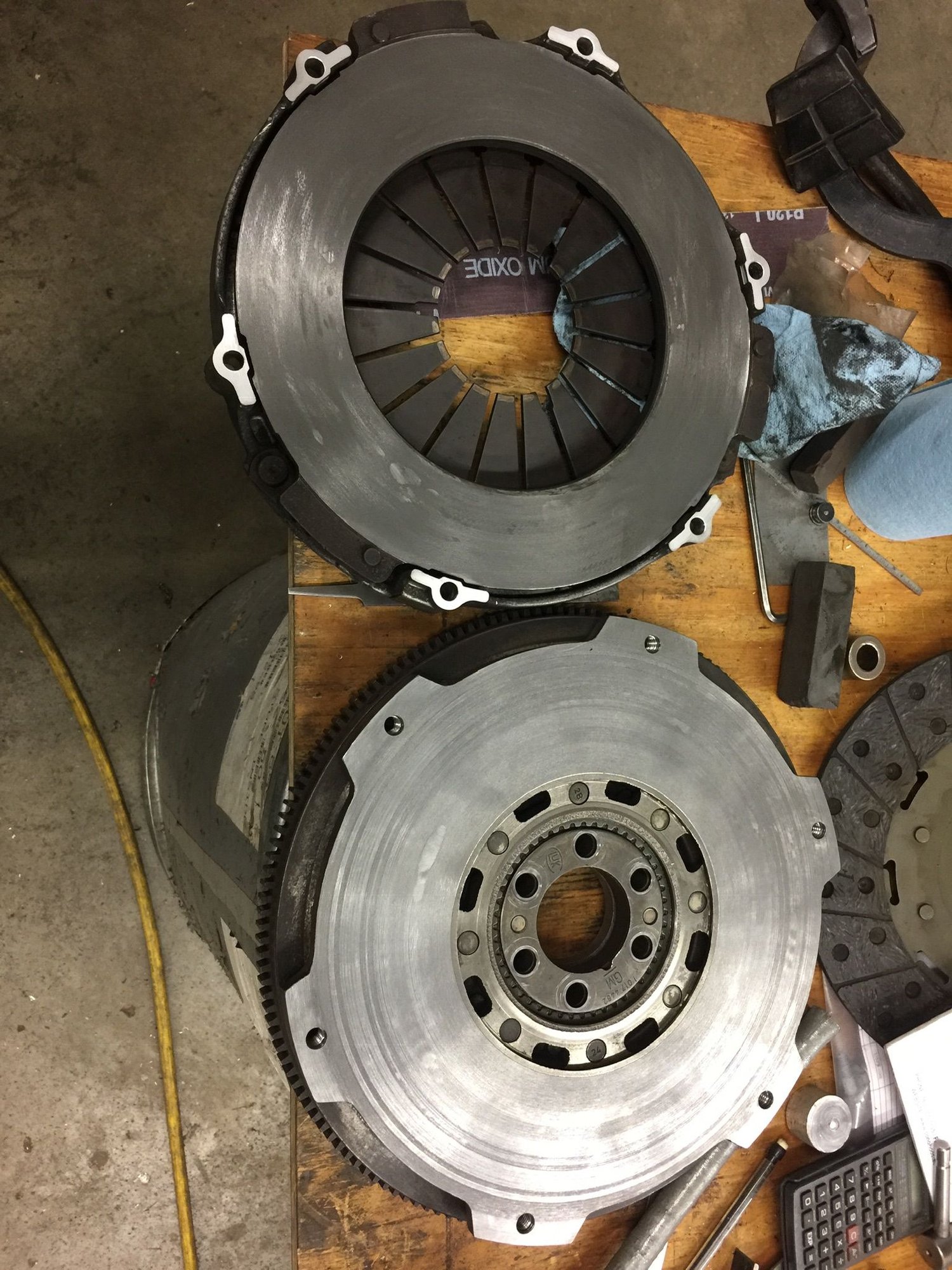

Here are some pics of my remachined PP and DM flywheel. I did a zf swap and needed some good clutch pieces. I spoke with both Jim and Bill at great lengths about this. They were both a little skeptical about this but after seeing the results, wanted some info on the process. The correct height for the standoff to friction surface is .190 to .195. One thing to consider is if you remove material from the standoffs, you have to put a spacer under the bolt heads to prevent them from bottoming out in the counterbores of the bolt holes in the flywheel.
