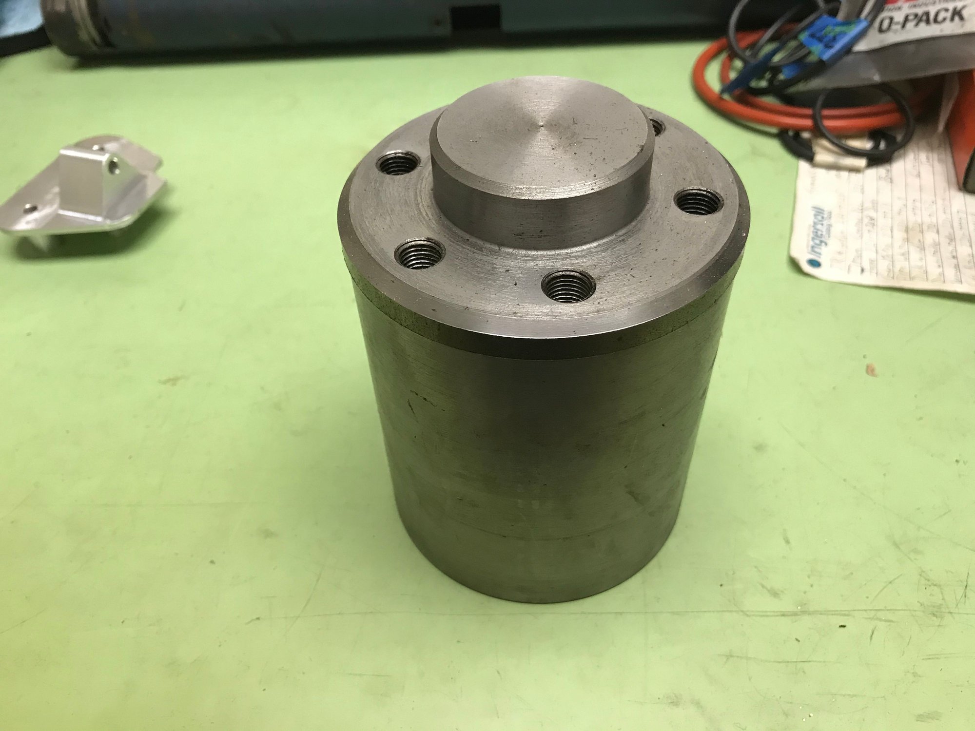

What have you done there? I can't tell from the pics, how you secured the clutch-side mass to the lathe?
And... what did you datum for flatness? Did you have to tram it in?
Looks like a 4-jaw ID clamped but I would also like to know.
I made this mandrel that is the same mounting as the flange of the crankshaft. This was finish turned in the lathe that’s was used for flywheel machining so it ran perfectly true. Bolted flywheel to it as if installing on crank. In order to support the friction side of the flywheel, and to keep it from rotating in the hub, I used 3/8 set screws through the PP mounting holes to make contact with the main side of the flywheel. To make sure I didn’t distort the flywheel friction side, I laid the flywheel on a flat surface and placed dial indicators on the friction surface to make sure I didn’t over tighten the set screws and warp the friction surface.
