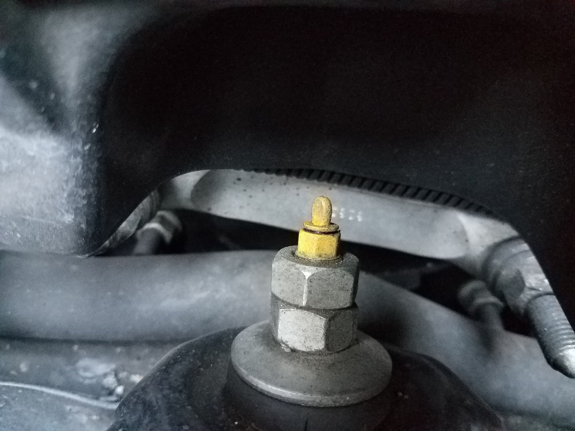

There should be a flat blade sticking out the top of the shock rod. In front you'd see it easily at the top/end of the threaded rod above the shock tower.

I checked mine, they're yellow, they say koni, but no flat blade sticking out of the top. Just a bolt end. There might be a slit in that stud you could get something hella thin in to turn... But I dunno. I'm starting to think they're either not real or something.

I'll go take a pic of mine....

From: Park City Utah
Here is what mine look like. The rear is the same, but of course you can't see them w/o removing the top from the frame.
