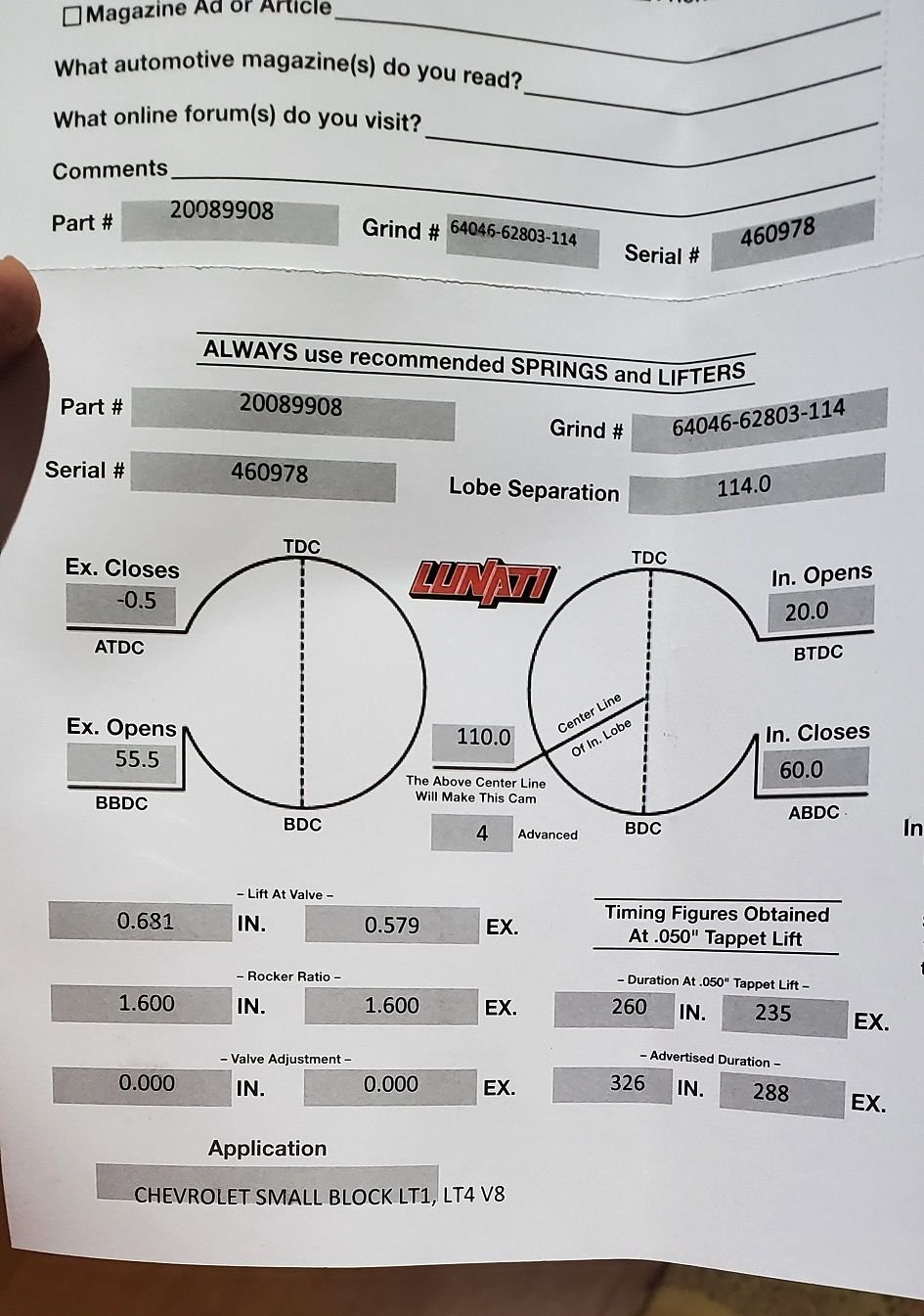

Cam is here:

Am I reading that right, 30 deg negative split on duration? Interesting.

Yes, as I mentioned above, LE and I had about a 10 min. conversation after exchanging emails for a few days. He was pretty confident this will be the best for the overall use of my car. Have to say, his name is getting him a nod of confidence from myself. It will absolutely go to the dyno once built so we will see what plays out.
This will not be a 1/4 mile car. I am sure I will take a few passes on it, but it will see parade duty more than it will see the traps at the top of the 1/4 mile. Shows, cruises, parades, and some fun racing.

Wait, you said earlier in the thread Lloyd recommended a 223/235 duration cam. You sure you got the right part shipped to you?
