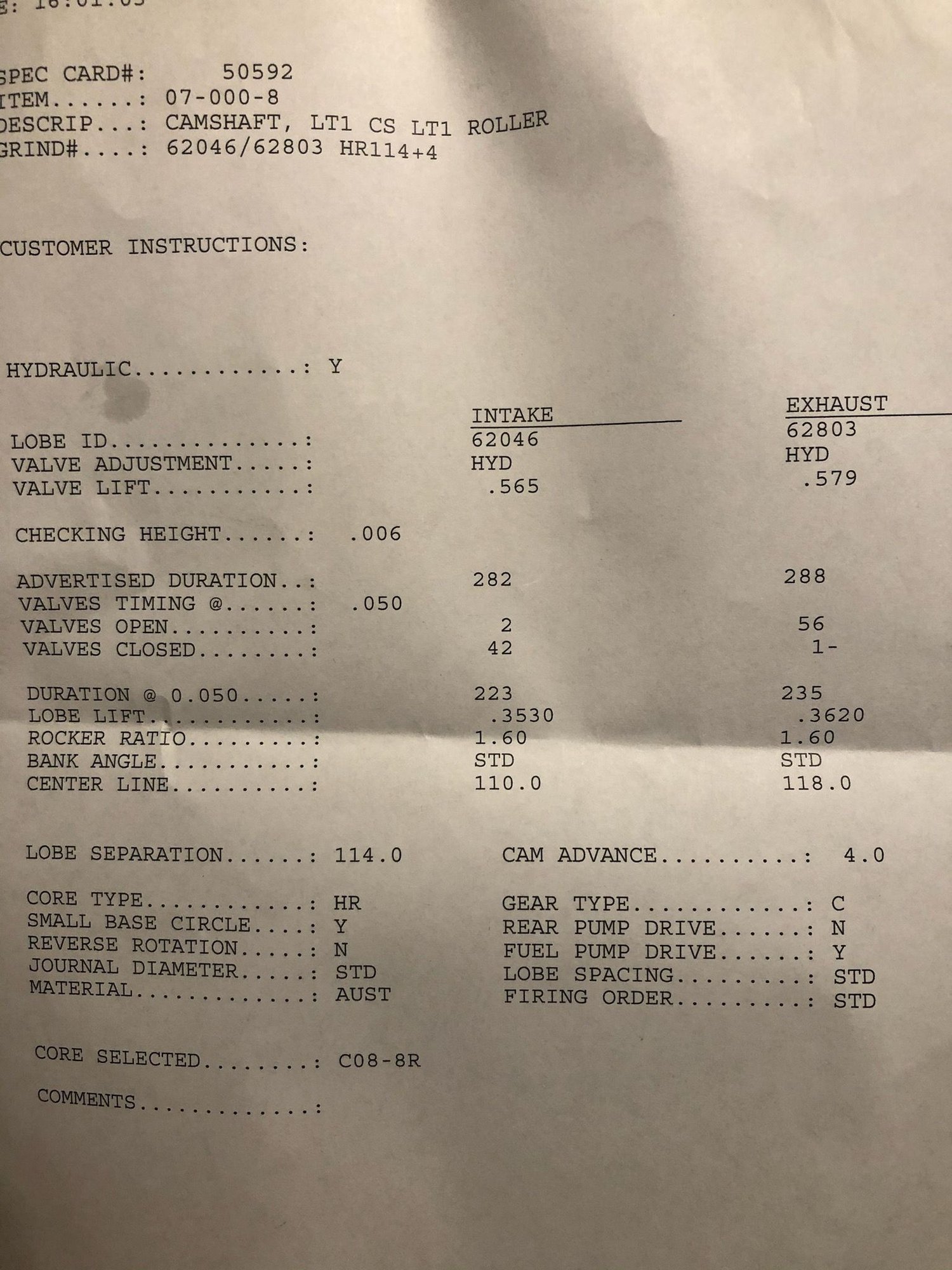

Originally Posted by sstonebreaker
Wait, you said earlier in the thread Lloyd recommended a 223/235 duration cam. You sure you got the right part shipped to you?
Pump the breaks... I was asleep at the wheel... email out to Lloyd for clarification. That looks like a much bigger cam that I expected.
Old Aug 13, 2020 | 09:30 AM
  #42
sstonebreaker's Avatar
sstonebreaker
Joined: Mar 2006
Posts: 5,775
Likes: 585
From: Texas
I bet somebody at Lunati got the 0.050" duration mixed up with the advertised duration when spec'ing out that intake lobe.
Old Aug 13, 2020 | 10:00 AM
  #43
KyleF's Avatar
KyleF
Joined: Jun 2018
Posts: 1,678
Likes: 229
From: Michigan
Looks that way... I shouldn't have assumed "Lloyd Knows Best", as mistakes can sometimes happen. Just have to see what happens here because I would expect there to be more duration on the exhaust side. I pulled the card out, took a picture of it, back in the box, and box with the rest of the parts in their boxes. Shame shame... should have paid more attention. Guess this is a lesson on assuming.

From: New Jersey
I was about to say... idk how that would run with that kind of duration split lol.

More than that, do the springs he has work with a .681 lift? I'n not sure that's even a hydraulic roller lobe. That much lift looks more like a solid lifter lobe.

Hopefully it's a misprint on the intake side. The exajst is about what I expected.
It was ordered as a 223/235.
@sstonebreaker that is way more lift than it should have for my springs.

Good news, got with Lloyd, Lunati claimed they produced the right grind, but messed up the paperwork. They sent a correct Cam Card and I measured the cam at work to confirm and it is correct.

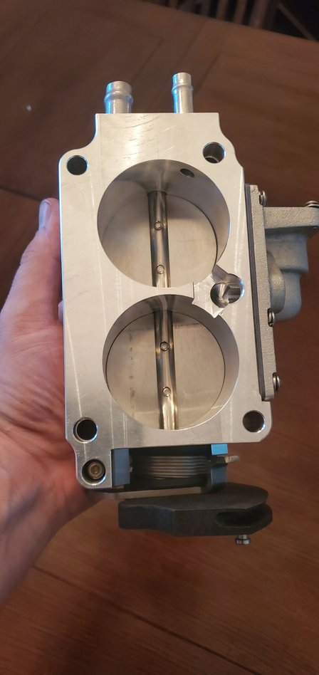

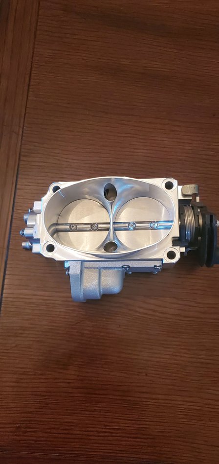

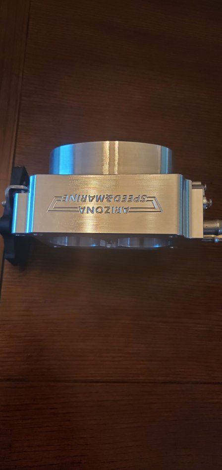

Also, while dealing with the Cam my Throttle Body came in:
It is some pretty machining.
