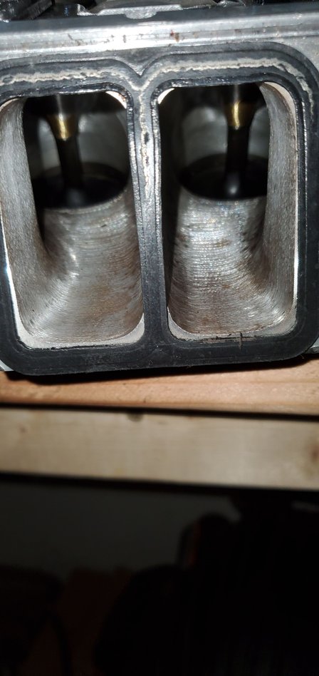

Currently, it is a 96 CE LT4 with about 58K miles. Procharged/Intercooled 8PSI making 385RWHP at 5800RPM through a Corsa Cat-Back. Car has been lowered by a bolt kit about an 1" or so, windows tinted, Targa bar for top out driving and a short throw shifter. Car is otherwise healthy, with good fluids, no codes, custom tuned, and boost/Fuel Pressure gages to keep an eye on things.
Goal was to get close to 450RWHP but look stock-ish. Now, we will bump that to 500RWHP. Call it operation “Not your Dad’s Corvette”. Yes, there will be clues to other “car guys” but what I am getting at is I don’t want to change the wheels, do any body modifications, stripes, decals, fins, wings, other decorative items or a bunch of add on electronics visible in the cabin … smooth. I like the stock look of the later C4s a lot. We will call it a sleeper C4 since most people think they are supposed to be slow. Obviously, opening the hood will reveal some truths, but just from passing by or to a glance from a casual observer, I want it to appear as just another C4 and leave them wondering why it sounds so mean. The car is a cruiser, will see 2 or 3 competitive events each year, multiple cars & coffee and other shows, and spends a lot of time blasting up back country roads. This will also fulfill my desire to always have a built car that is way faster than it should be.
I will be keeping notes on suggestions as this goes on and research them. Will update this as parts are purchased and installed… keep a reasonable build diary here, we will see how detailed it gets. It will probably be a few years before completion. I also have an IROC with projects I plan to do, however I never have both cars down at one time. For the most part, I do one project and then switch cars for the next. I don’t usually work on my cars with a schedule, just when I get free time.
What is on its way?

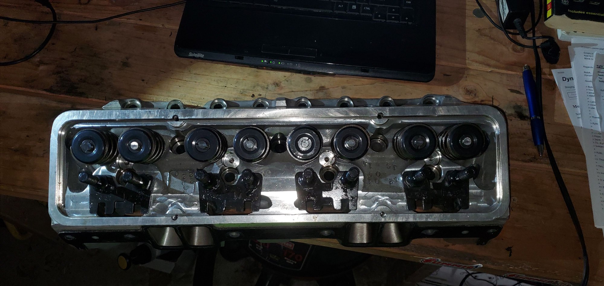

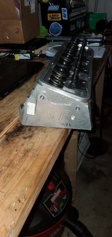

AFR 210's 64cc Chambers, loaded, 7/16” rocker studs ported by Lloyd Elliot info provided:
Lift Intake/Exhaust Flow
0.200 144/106
0.300 208/139
0.400 245/174
0.500 289/196
0.600 307/209
0.700 312/216

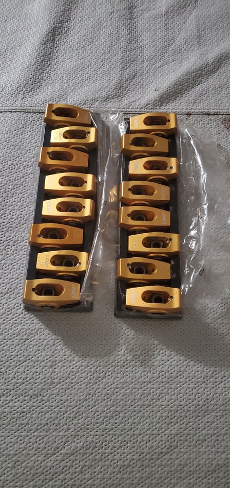

Crane Gold 1.6 Roller Rockers

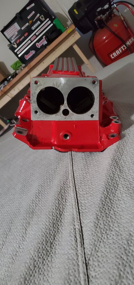

Port Matched LT4 intake.
Major parts I know that will be needed to make this build happen:
Cam: Emailed Lloyd Elliot today and will order a recommended package. The kit previously had a matched cam, but got sold separately. I am guessing he will have his notes but the previous combo may not be a match to mine. He suggested a 223/235 .565/.579 114 LSA camshaft, so that is what I went with.
Headers: From my readings, I am pretty sold on the American Racing Headers. Unless there is a better set for installation and clearance, TPIS? Here is where I would sack a few HP to be able to reach my plugs better.
Injectors: This is going to require some research on size and which brand will be best once I know what size to run.
Fuel Pump: going to need to be bigger. Haven’t spent much time on this one in recent years. Used to be a Walboro 255 was enough to support anything. I am sure there are better options available today.
Throttle Body: The manifold is ported to a 58mm. I am not a huge fan of upgrading the TB on most combos, but I believe with the flow capabilities of this combo, it will be in order. What are the high quality units out there these days? Update: Looks like all the same players, so I went with AS&M.
Brakes: I already have my plan together for this one. Since the C4 GS/CE had an improved J55 caliper, I am just going to stick with them, paint them, put slotted rotors on, better pads, stainless lines, bias spring and complete fluid flush. Update: StopTech Rotors, Goodridge Lines, Paint, and Carbotech Pads with a DRM bias spring was selected here.
Suspension: This one is a bit open. I know I want to go to a better nonadjustable shock that the factory. I am sure my bushings could all be replaced. I don’t want to go crazy here. The car is superior to my driving capabilities for now.
Tuning: Nobody local, so it looks like Jet DST will be in order. I will be going mail order tune to get the initial tuning done and get it on the road. I do have access to a dyno to get some dyno runs in with logs. Just have to see how it shakes out and how hard to tuning is to get worked out. I am currently installing an EBL system in my IROC. Depending on how much I learn there, I may tackle some of the tuning on the Corvette. Or is this the time to ditch the Opti and do a Torque Head or other solution? That adds a significant cost but makes this section easier.
What else may be in order:
Gear: Figuring the 210's and matching cam will make it's peak power around 6500RPMs, will a 3.54 be enough. I know I am giving up some lower RPM torque and Elliot’s site says a 3.42 or better gear for a cam close to the specs above in Y&F body platforms. Should I be looking as deep as a 4.10/4.33? Will that still be able to keep the rear tires under the car?
Clutch: As far as I know, all is factory with my clutch. Probably isn’t going to handle this. Even if it does initially, I fear slipping will not be too far behind. So, any comments on clutches would be great.
Flywheel: Is going lightweight with this build a good idea? I was considering it as the car sits, but with the bump in RPM with the bigger heads/cam I may need that mass at low RPMs. Thoughts?
Bottom End: With low miles, I think I will leave it as a 350 for now. Since the larger chambers are going to drop the compression a bit, I feel like the bottom end has a chance. Also considering this isn't going to be a race car that gets pounded on regularly, I think it has some years on it. If I break something, I would go with a forged bottom end 383. Can break that down when the time comes. Feel free to comment though, just don't see it needed right off.
Supercharger Pulley: With the larger chambers I can run more boost safely, but what about the efficiency range of the blower itself. This is another topic that could use some discussion. Also may need to address belt slip with a more aggressive engine. No current issues, but the engine will be trying to accelerate much faster once the heads/cam/intake are on.
I figure the steps will be: Do the Brakes and then the suspension upgrades while I collect parts. Then do some of the supporting mods before tearing into the motor. By this I mean getting the fuel pump in, doing the clutch and gear if it goes that way, and other odds and ends that come up.
So, have at it. I am not saying money is no option, but I want it done right with quality parts. Also, all guesses of RWHP will be entertained as once it is built, it will go to the chassis dyno. Goal is 500RWHP and not breaking anything. As decisions are made I will update this post to reflect that a decision has been made. I know some of you will have fun with this, so have at it. @dizwiz24 @Tom400CFI @MatthewMiller chime in please.

Question, and I know it doesn't matter much but I am curious, why are those exhaust numbers down substantially in flow compared to what AFR publishes for the 210 LT? I've seen their numbers are usually spot on but there are a few outliers in the provided info.
As far as cam, LSA is probably right, I suspect the degrees at .05 are also close and I would say it'll be a higher lift cam, closer to .6 valve to take advantage of the head flow. Now if he keeps the lift down, I would say more like a 232/242 then but that's me.
For the headers, as long as they are angle plug heads I would think clearance isn't a problem. Mine are easier now than stock but mine are melrose which are NLA...
Sounds like everything is in order.

Heads Intake and Rockers are here
Afr 210s
LT4 Intake port matched to heads and for a 58mm Throttle Body
Crane Gold 1.6 Rockers

Guessing my the #s those arent the comp port? Looks like he did a basic cleanup on them...(but why are the valves still caked up)With a good head and FI you dont need a bunch of cam
I like the smaller of the 2 , that will work perfectly with the gear you have now and allow you to stay in the torque band longer....youll love it.
If you cammed it up and geared to suit you would have to (still might wana consider it) run M/T full time so you dont wrap it around a pole. On the strip it would be awesome not so sure if its worth it just as a street car
