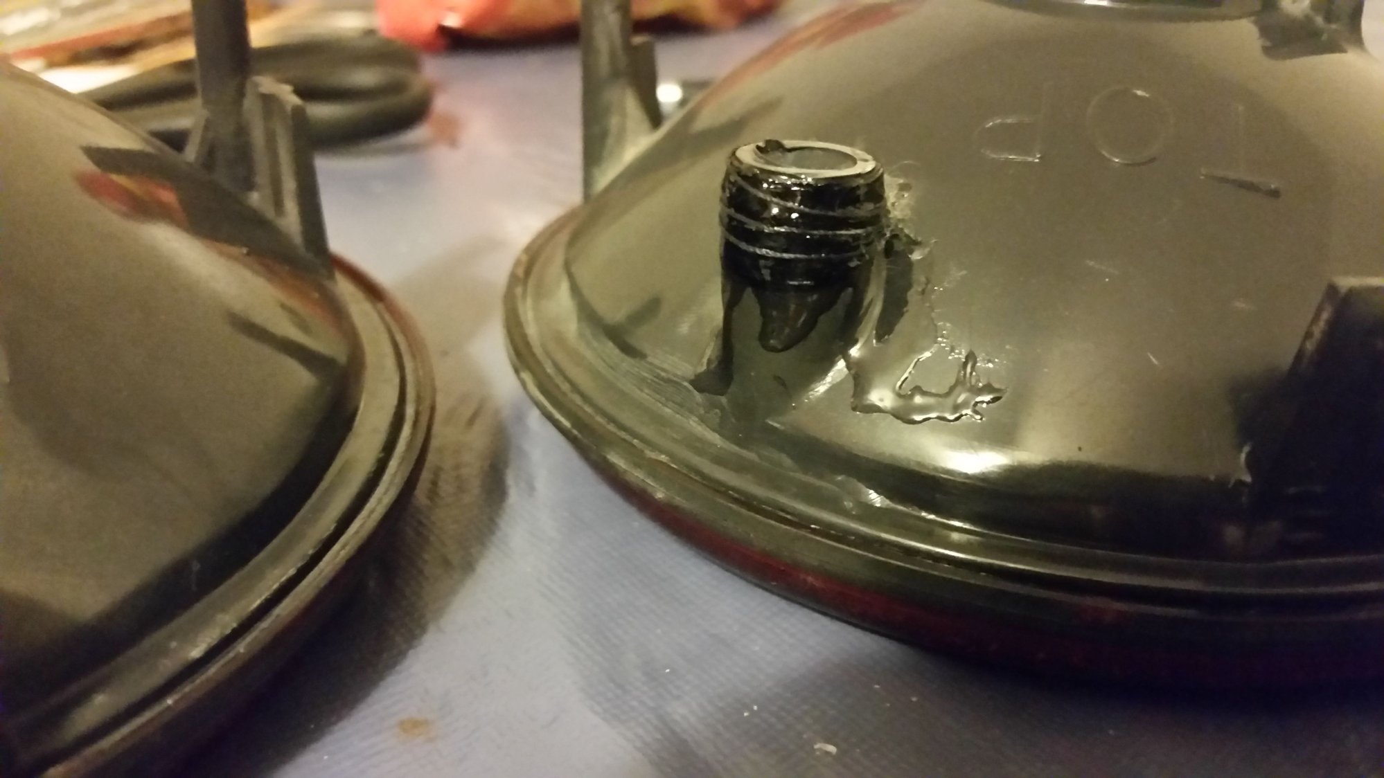

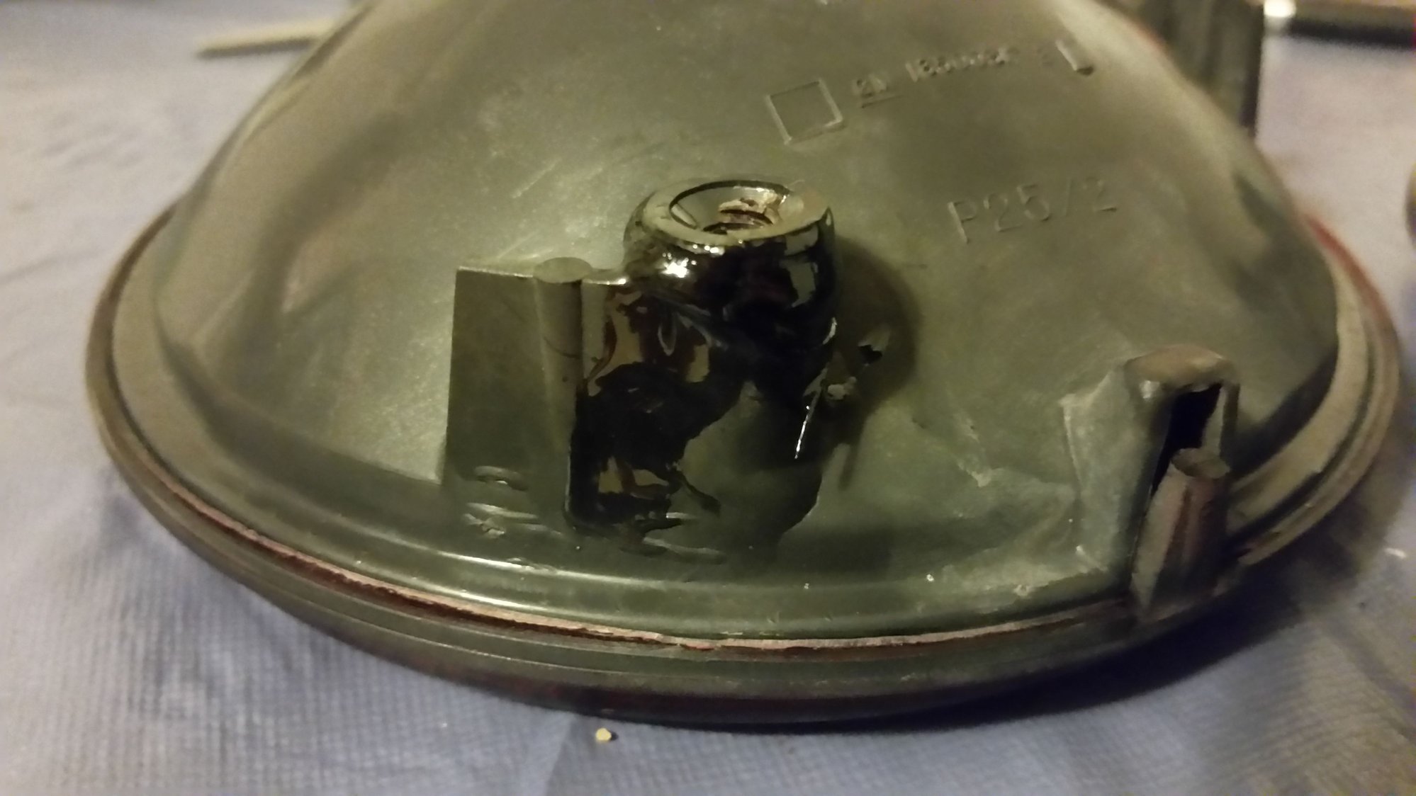

If the light housings are original and you are planning to remove the bolts, be prepared for the plastic mounts that those bolts go into to break. Both mounts on 2/4 of mine fell apart when taking them out. Had to use epoxy and thread to glue them back together - it's not pretty, but it worked for now.

I had my 84 housings break as well. I bought some longer bolts and cut the heads off. This made some studs. I then drilled the holes with the proper size for tapping the studs. Ran a tap into the holes and then double nutted the stud and screwed them in the housings. I also put some JB Weld in the holes to hold the studs solid in the housings. Used nuts and flat washer w/lock washers to secure the assembly in the bumper. They have been in there for about 6 years and no problems.
