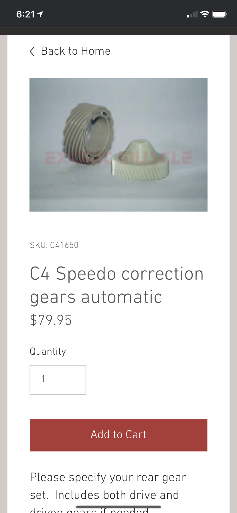

Sounds Fun! I'm having my 3.55 installed now. I decided to go with the physical gear from Exotic Muscle rather than the box to keep the odometer correct (at least I think the gear will keep it correct). Keep us updated on your process of choosing tires--that's my next purchase as well ;-)
R
What rear axle ratio was original to your 40th. If a 3.07 you should have the correct VSS and a single gear 'might' do correction. If other than a 3.07 the correct VSS is a very hard find.

I had the 2.59 "Cadillac" rear end according to the build-sheet on my glove box. EM listed a 3.54 speedo adjust gear, so I ordered it. I'm a newbie, what do you mean by VSS? I thought the rotation of the gear sent the wheel-speed info to the digital device running the speedo--am I wrong?
Ronn
You should need a drive 15 tooth, a VSS and a 42 or 43 tooth driven. You currently likely have 17 drive and a 35 for driven along with the incorrect VSS.
So, if I understand correctly, the gear alone is not helpful. Am I better off returning it and just getting an electronic unit like the abbot--accepting odometer error?
Thanks
R
I would think so unless you were able to come up with the correct VSS. That's very unlikely to happen. The ERA I'd think is currently a more reasonable approach. What exactly were you sold and how many $$$. EM wasn't/isn't known for 'deals'!!

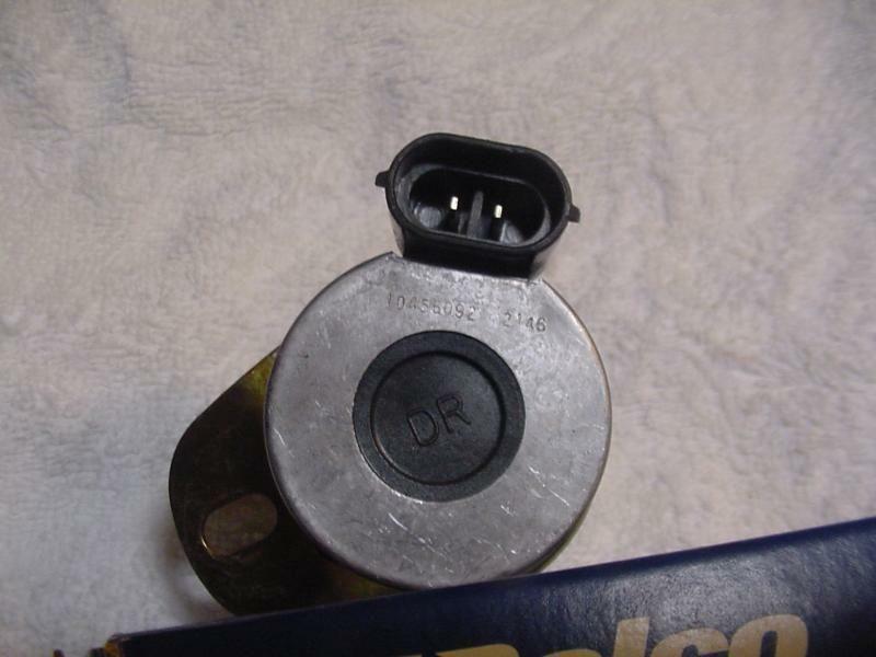

I got this- calibrated to 3.54 gears
You would need a correct VSS to use those. An original GM # would be 10456092. Your electrical connector currently is likely 'white'!
