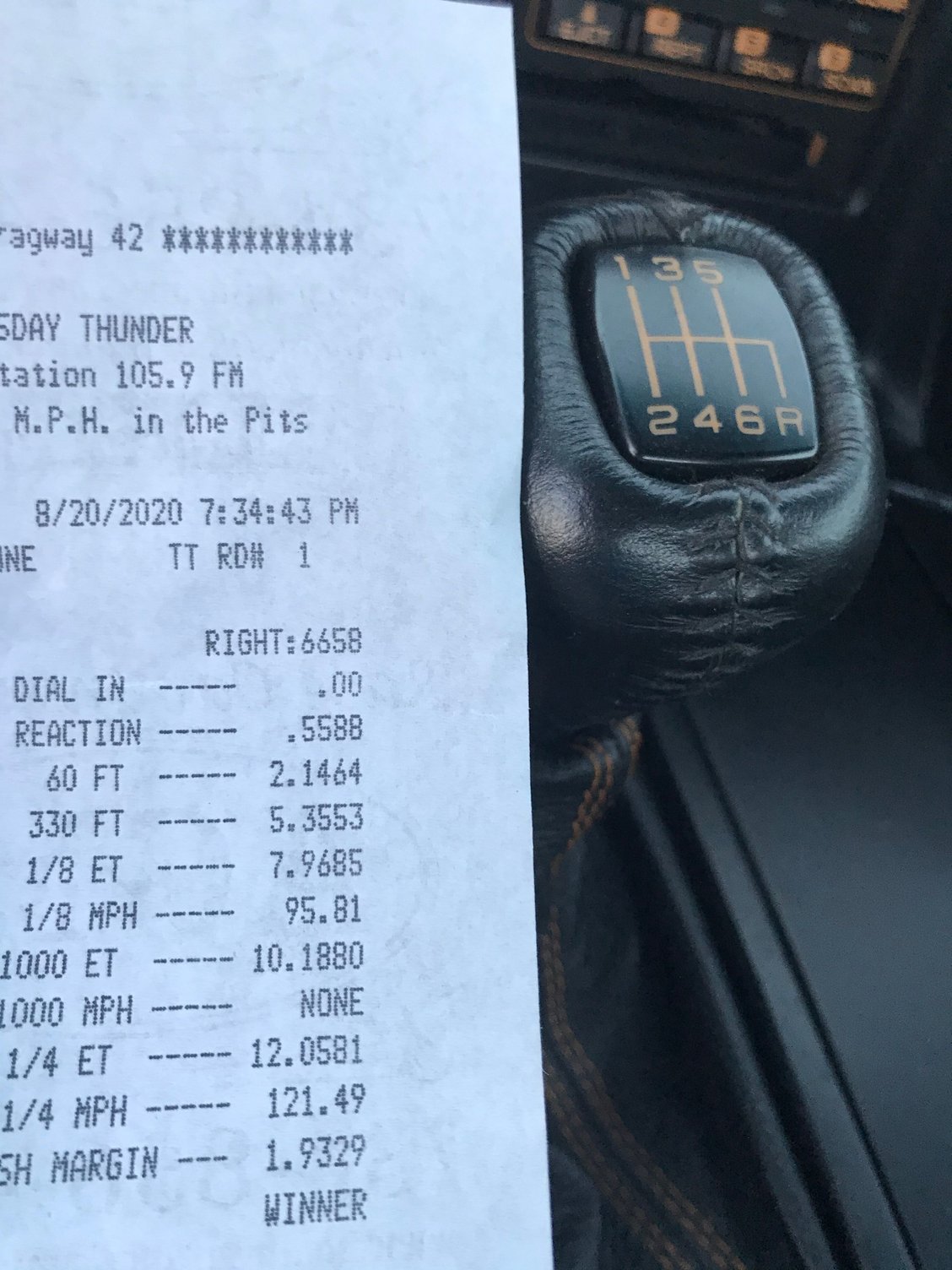

I had a clicking noise/shuddering from the rear as I launch
ed my 6spd supercharged 93 at the dragstrip last night (p315 /35r17 toyo r888 road race tire)
here is the timeslip for that run. Ive gotten 11.96 once with this car. Was hoping for that or better last night but no such luck
I tried to post a video below. Turn sound on and notice the clicking/shuddering as the car launches.
you may have to ‘zoom in’ on the video to see whats
going.
(i meant to capture my gage pod (in the video) but failed miserably)
But yeah - please watch the video and tell me if the shuddering//rat-a-tat-tat clicking seems normal ...

Did you turn off the traction control?
Engine sounds nice! 121 mph is nice too!
