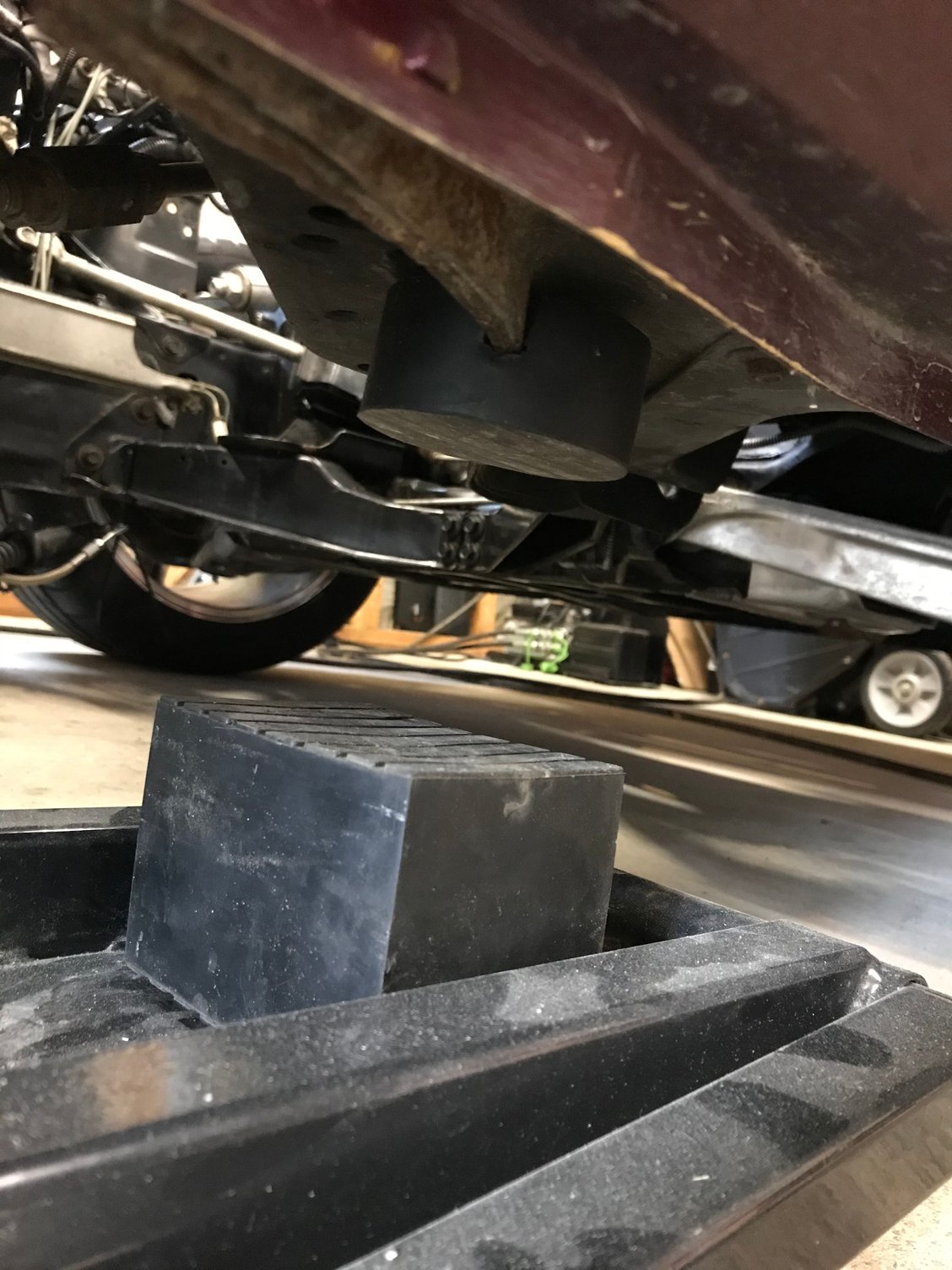

Originally Posted by KyleF
No sure I follow. You can see in the pic I have placed their 3" Blocks directly under the lifting points. they are centered on the pinch weld, blocks are centered in the QJ frames R to L. Teh set up is with the QJ frame close to the rear tire, lift is up and back. The weight of the car compresses the blocks by about 1/4" but after I have had it up in the air a handful of time there is no indication of cracking or tearing of the block. I check them before/after each lift. Maybe you just need new blocks?
My blocks compress enough that the frame of the quick jack, specifically the inner rail (closest to the center of the car) gets too close the underside of the car. Next time it's in the air i'll take a picture. It's almost like the square blocks i've got are bad and compress too much. I'd like them to be more rigid.
As a solution i've been using the square block combined with a pinch weld block, where I normally place jackstands.

In the below you’ll see the underside of the car sits lower to the ground thank the rocker pinch weld. If the blocks compress enough, the QJ frame gets too close the body.
Here’s how I’ve been using it combined with a pinch weld block as a solution. Interesting you havnt encountered this makes me wonder if my blocks are defective.
We are setting up a bit differently. I will look through my phone later and see if I can find any more detailed pics of how I have been setting mine up.
