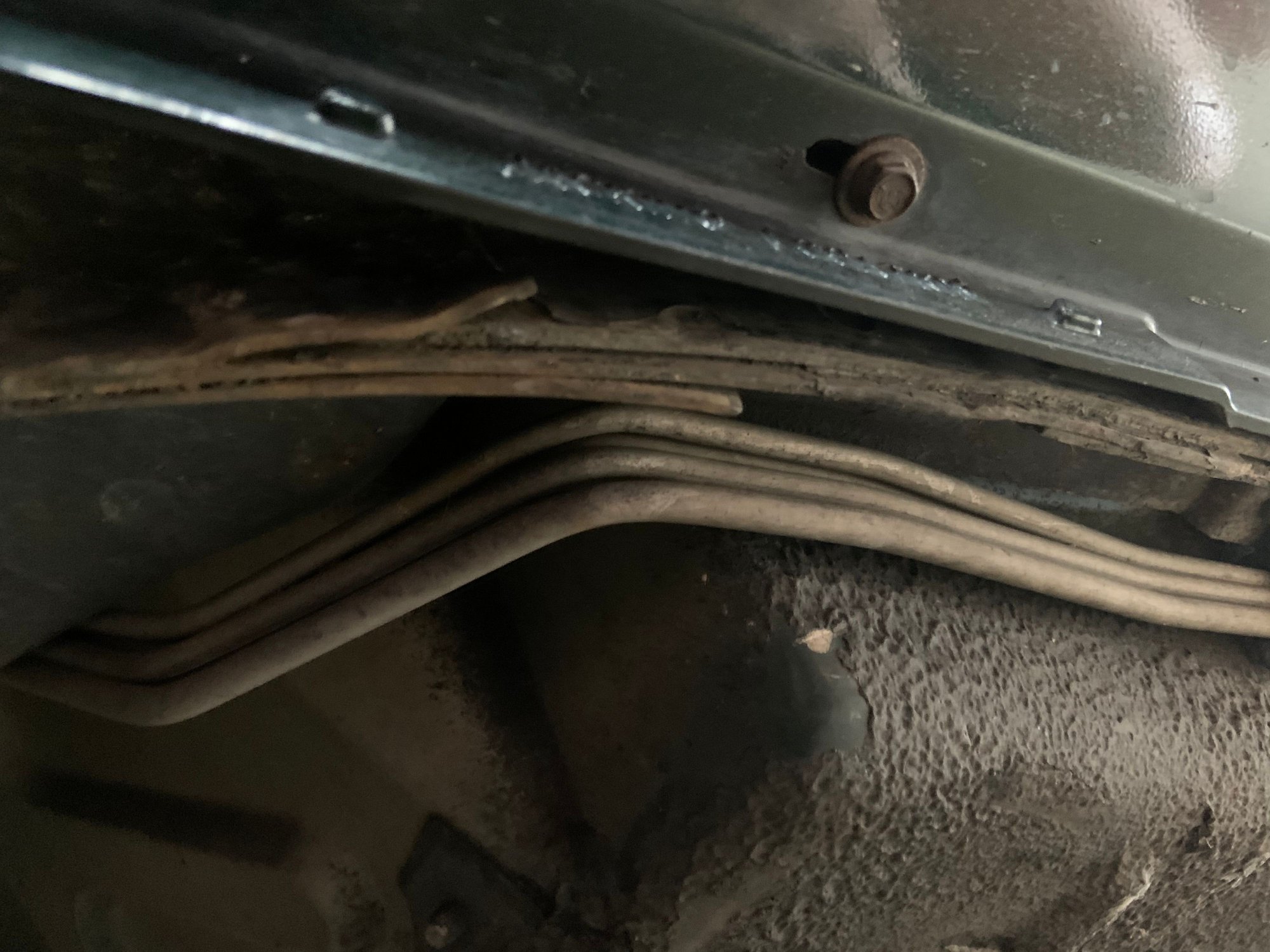

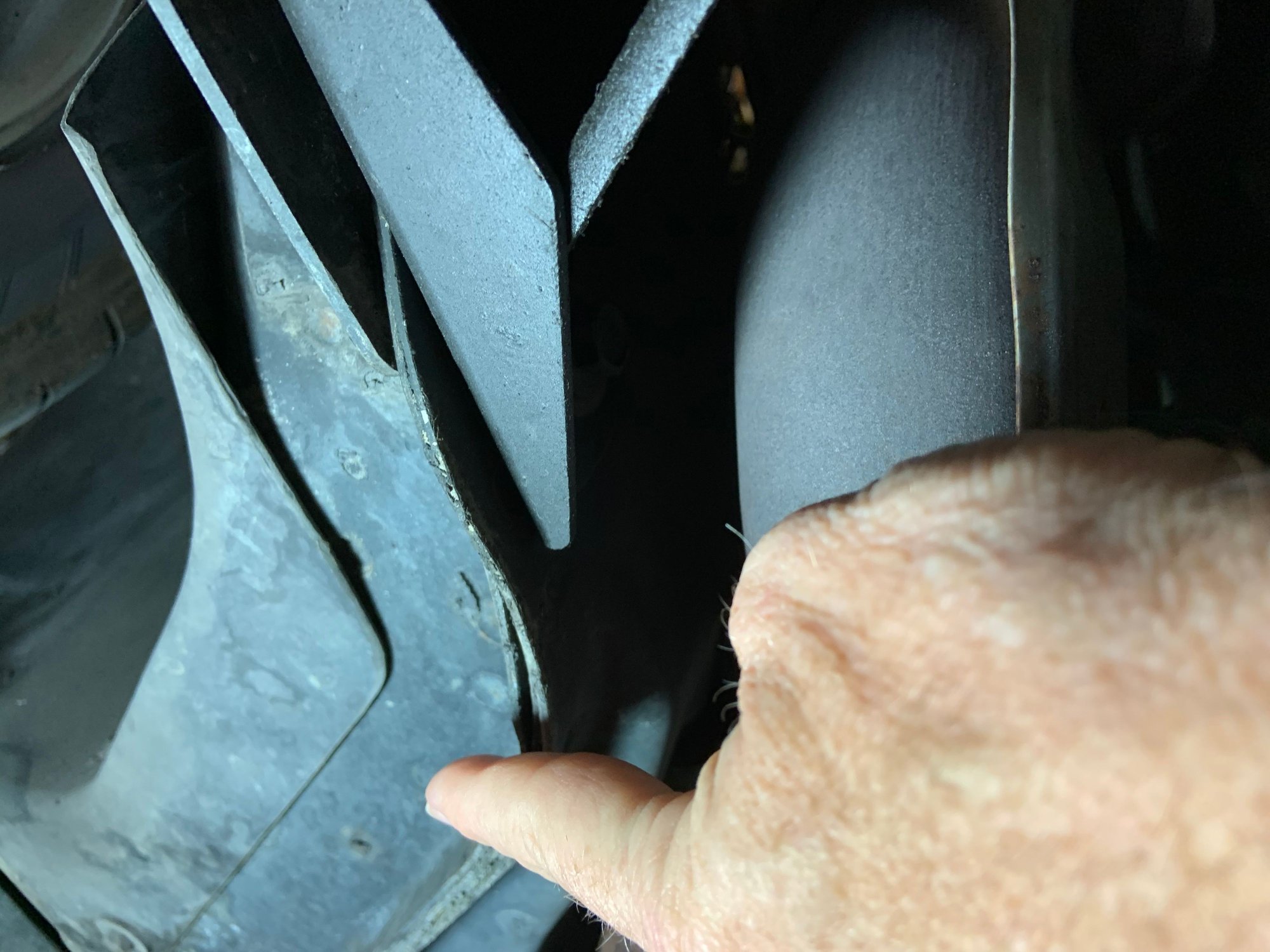

When I look at the marked jacking points, I see the pitch weld, but I also see the fiberglass rocker panel right on top of that pinchweld--seems like a recipe for cracking my rocker panel? I am I right in assuming a piece of steel or aluminum bar stock, allowing me to focus the lifting torque on the pinchweld, is the way to go, or am I mission something. I use a slotted hockey puck on my Miata, pinchweld right on the rocker panel as well, but the Miata has a steel body. I think the puck would still transfer torque to the rocker.
Also, who put these damn lines here--any advice to avoid these other than "use a really think piece of bar stock"...?
