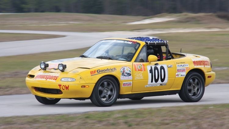

Grassroots Motorsports Magazine ran a test on the effects of wheel inertia on a short autocross course and 0 to 60 acceleration.
Granted they used a low powered Maita for the testing.
The whole article is interesting, but I clipped the acceleration details .. here
Are Lighter Wheels Really Better?
https://grassrootsmotorsports.com/ar...really-better/

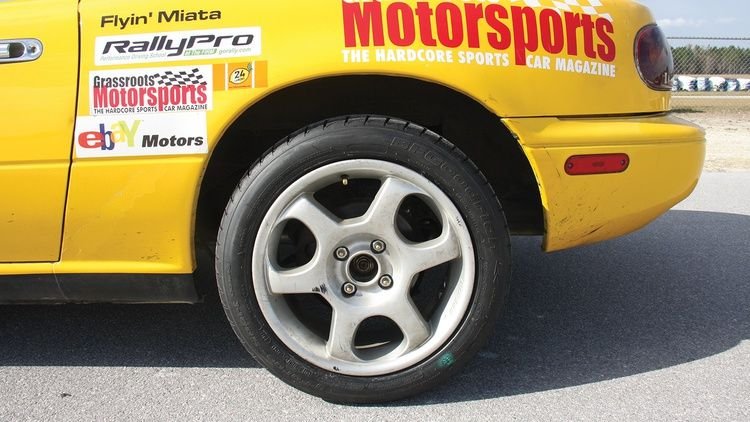

Masitaly Wheels
backspace: 57/8 in.
spacer: 1/2 in.
total weight per corner: 42 lbs., 4.6 oz.

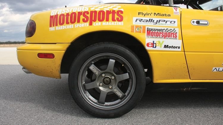

Volk TE37 Wheels
backspace: 53/8 in.
spacer: none
total weight per corner: 30 lbs., 14.6 oz
This test showed clear differences both on the kart track and at the strip. Times were substantially worse with the heavy wheels, which slowed the car by 0.31 second on the average lap and 0.46 second on even the best lap. Even though Alan’s final run on the heavy wheels was substantially quicker, it still was 0.16 second behind his best time on the light wheels.
0-60 times:
Volk TE37 = 8.61 sec
Volk w/ballast = 8.75 sec
Masitaly = 9.04
Our zero-to-60 launch was our big test of angular inertia, and it showed substantial results. We ran three tests here, the third with the lightweight wheels and an additional 42 pounds of ballast in the trunk. This would illustrate the difference made by the fact that the heavy wheels aren’t just weighing down the car, they’re increasing the amount of energy required to spin them.
That test was fruitful, too. Though the ballast slowed the car’s zero-to-60 time by 0.14 second compared to the Miata equipped with simply the light wheels, putting that weight on the hubs slowed the car by an additional 0.29 second.
