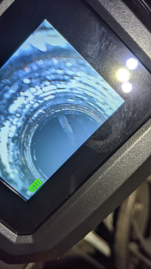

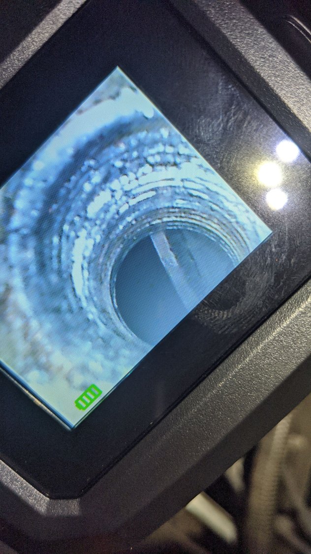

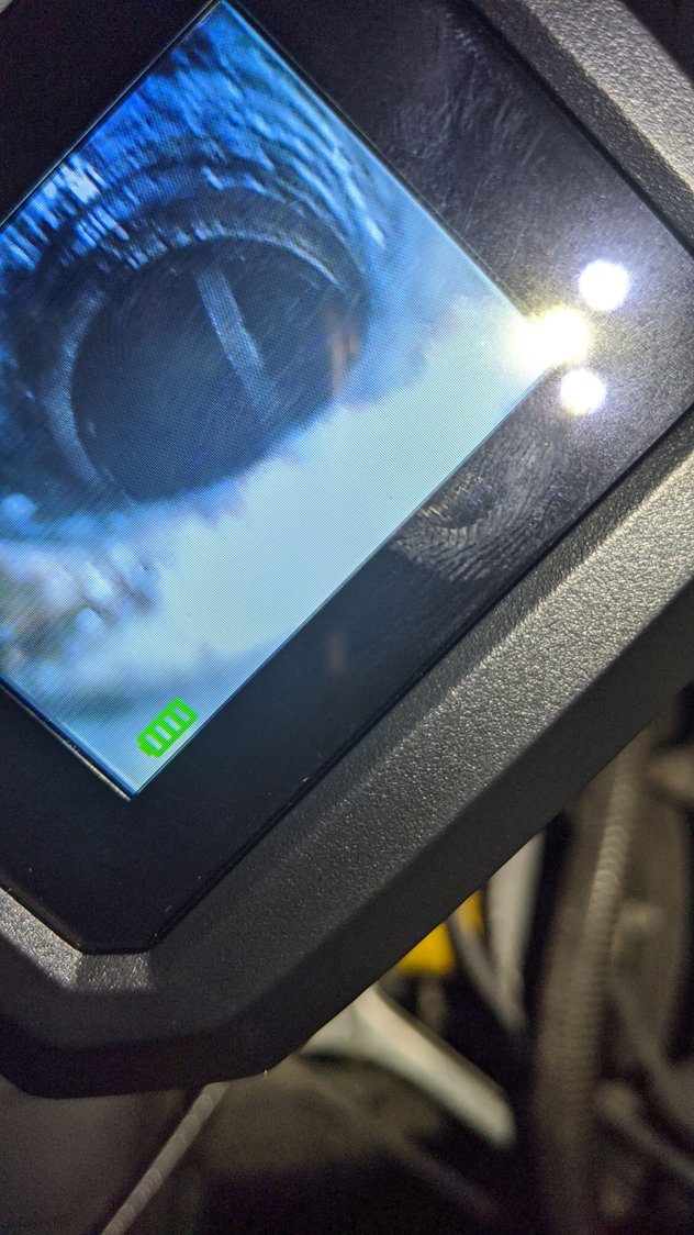

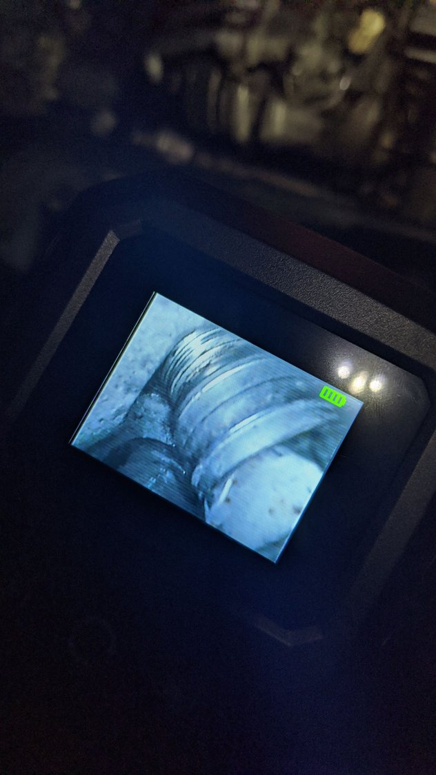

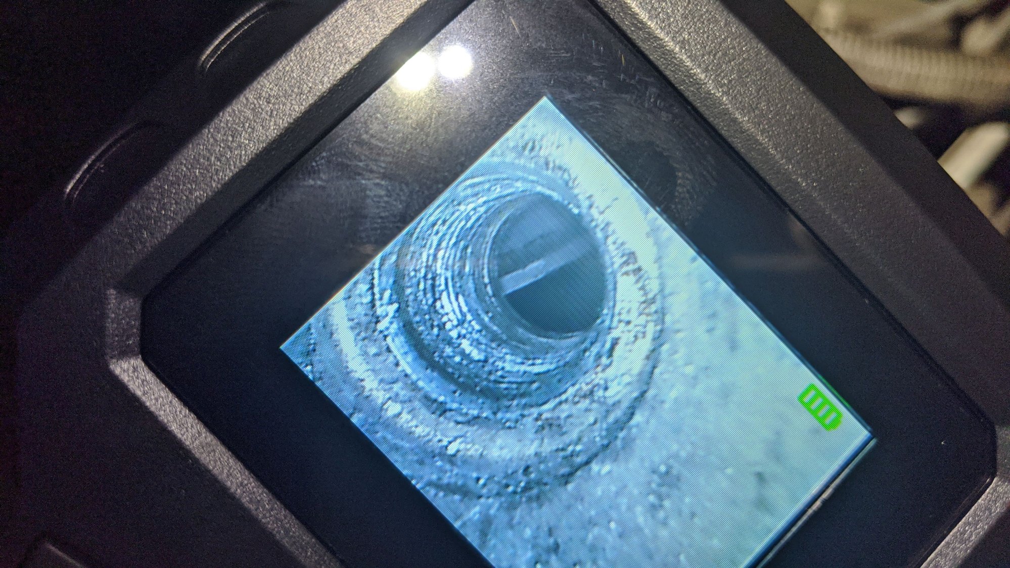

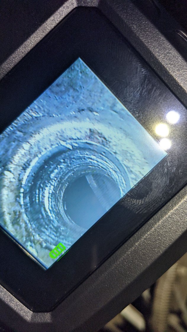

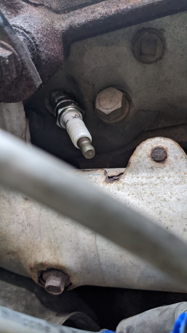

So I have so far changed all of my spark plugs except one, it goes about 3/4 of the way in then tightens and won't go in anymore. I took a bunch of photos some may be useful some may not be but I am at a loss on what to do except moving my head job up sooner and shipping them to Lloyd Eliot. Any tips will be helpfull

You need a sparkplug thread chaser. Most parts stores should have one.

Originally Posted by Alejandro Guerrero
i may just be me but...those threads do not look like the cleanest in the world. and this shot makes me thing the plug is cross threaded in the head.
maybe i just need a new pair of glasses.

I think the op has changed a set of angled plug heads into straight plugs. Hopefully the chaser will do it. I'll give him a 50/50 chance.

I got it in, I used a thread chaser and after running it in and out about 30 times the spark plug went in easier than some of my others. I did use anti-seize however it was copper so I immediately did some research and other than ctmccloskey couldn't find anybody saying not to use copper and many people saying TO use copper. Can anybody else back it up either way? I am getting some head work done by Lloyd Elliot this December so I may replace it with some non copper at the same time just in case.
To the guy who mentioned angeld plugs, I am not sure if that's what I did or not. I used the NKGs that everybody here seemed to recommend but either way they went in and car is running great!

I was being humerous meaning you changed the angle of the spark plug to the head. Glad it worked out.
