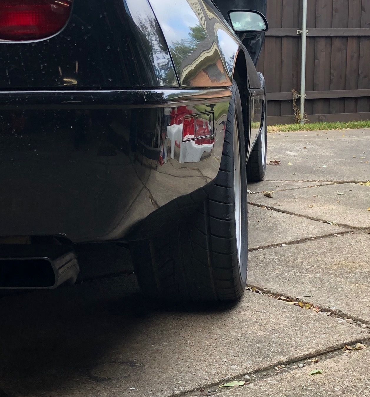

Hello,
This forum was instrumental in getting my car running again. Thank you!
Now that it runs right it's time to get it riding right. I have noticed a few things. When the car goes over a bump and bounces the rear end bounces side to side. You can feel it kick out a little to one side. I have also noticed there is some camber in the back tires when sitting still. I am not sure if this is a normal amount, see pic.
I also noticed the rear spring has a small strip of fiberglass glass hanging off of it on the underside, almost like a small split on the passenger side. The car also has more clearance over the passenger tire than the drivers side by several inches. The drivers side does not have a split in the spring. Not sure how to figure out why it sits like that. How would you suggest I go about finding the issue?
Things I know I need to do.
1. Shocks - suggestions besides Bilstein are welcome.
2. Bushings
Should I change out the leaf spring? I see new ones run about $550 at Ecklers. I saw Ebay ones for around $175 - but I don't think I want to go with a used suspension part??

Don't go with a used spring unless you're damn sure it wasn't in an accident. Else you could end up with a spring just as bad as the one you already have. And from what you've described, yours is pretty bad. Be thankful it's the rear--the front springs don't appear to be in production right now. Vansteel sells new springs for both FE1 and Z51 spring rates, so check them out as well. Heck Ecklers is probably selling their springs, if I had to wager a guess.
For shocks it depends on how crazy you want to go. If you just need the car to sit properly and drive properly, Gabriel makes cheap shocks that do work properly. I have them on my car and I've raced it--they do the job. They're not amazing by any means, but they do what a shock is expected to do.
That is not a normal amount of camber unless you just lifted the car. If you lift the car, because of how our suspension works, it plays wonky with the camber. But the moment the car is allowed to roll and settle, it should even out again. If it doesn't, something's wrong. Probably that leaf spring.

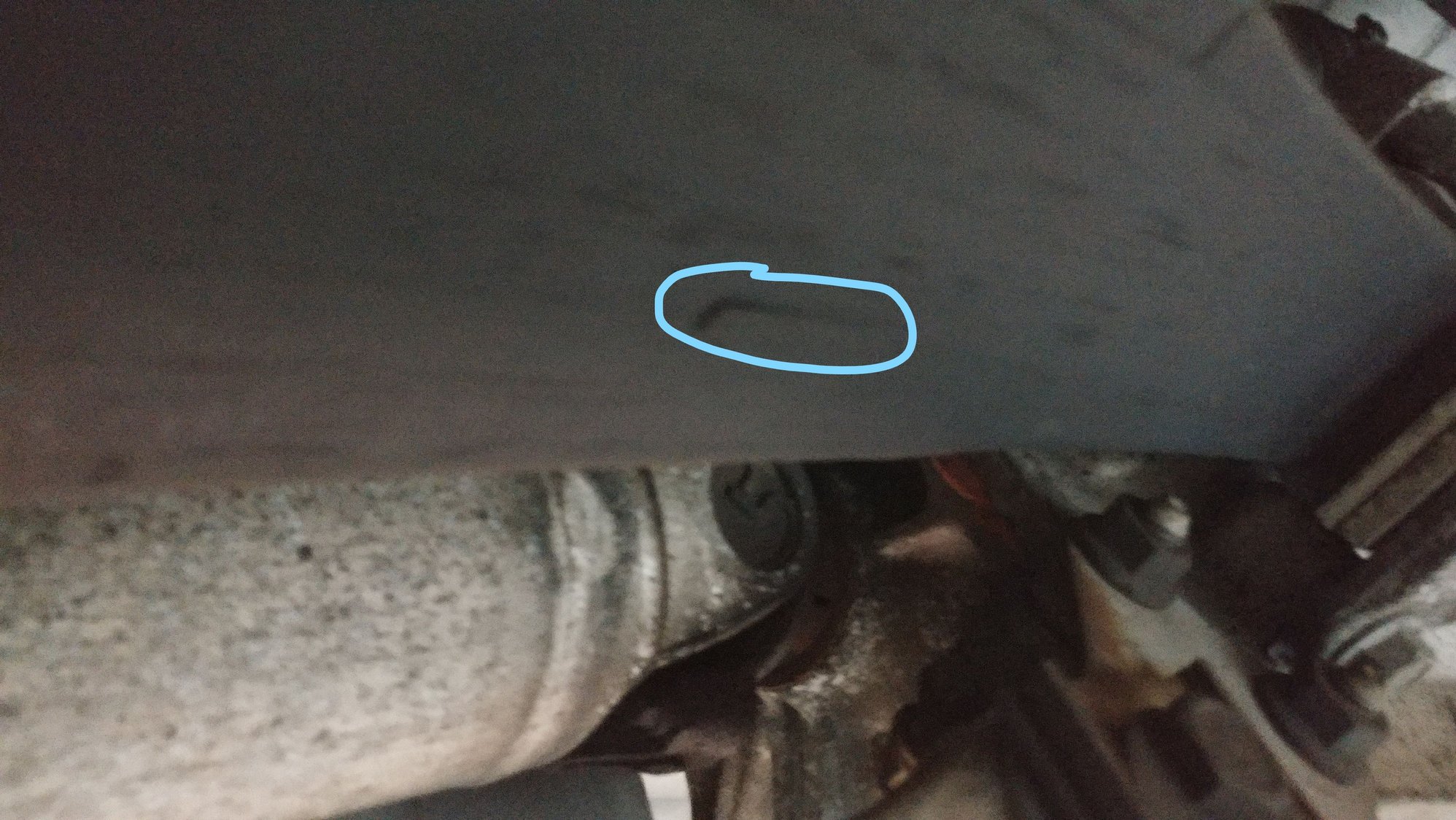

That's (not) funny. My '96 has an area of delamination on the LH side rear spring. I have marked the area boundaries to see if it will grow. Here is a photo of it.
Negative camber for the rear tires are normal; if they had positive, they were abnormal.

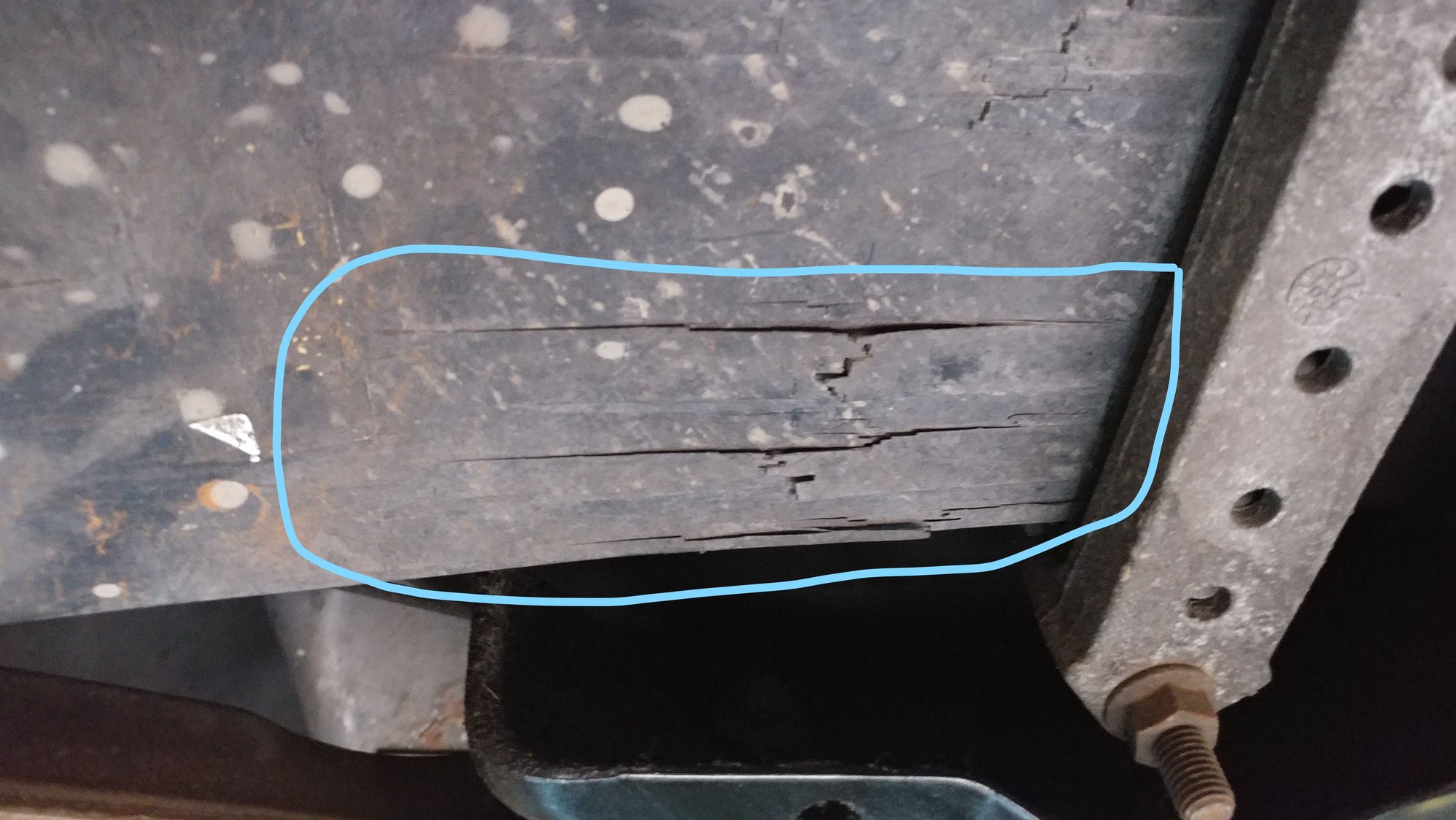

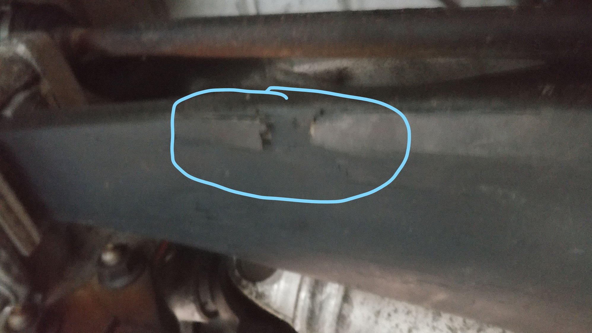

Here are my monosprings. I did purchase a used set from sleezyrider, I hope they're in good shape (and not been in an accident )
The 1st picture is the front and the car is lower, there is a dip in my(long) driveway and unless I slow down, the front will hit

i do hope those pictures are of your old springs. i do not recall the springs i sold to you looking like that.

no those are the ones being replaced
