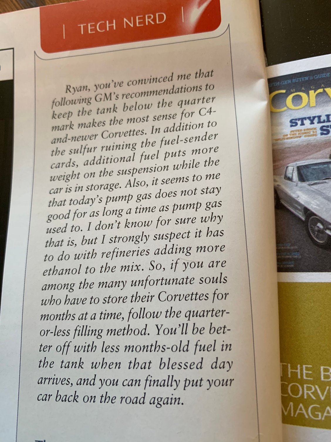

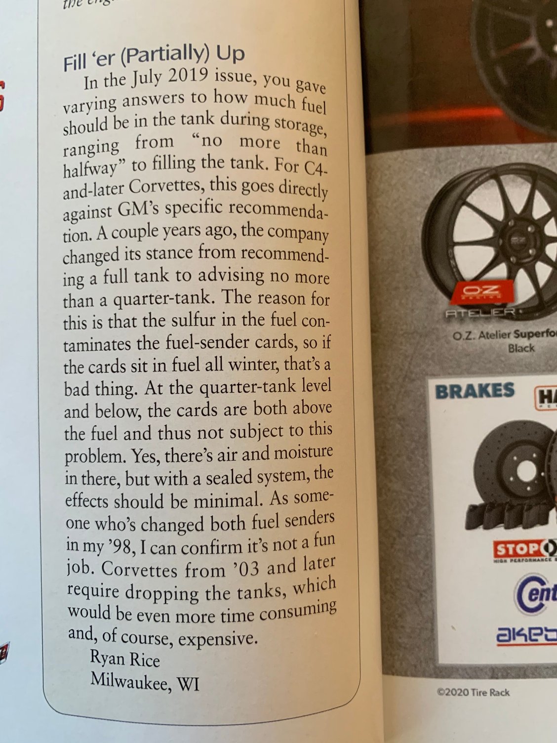

This year I am leaving about a 1/4 tank of gas, This is from a article in the Corvette magazine that a full tank covering the fuel sender will be harmed due to chemicals in the fuel. I did add St Bil for fuel preservation.

Check out Tech Nerd in the June 2020 Corvette Magazine, Filler Partially up
or check with GM on 2003 and later they have changed their stance on storage with a full tank.
I was agreement with you until I read the article.

From the article
Fuel that sits in the tank all winter will damage the fuel sender card from the sulfur.The reason it targets 03 and newer is the tank has to be dropped to repair. We all know the C4 does not. I suggest you look up the article and make your own decision.

C5 and newer tanks are made of plastic and won't rust from being exposed to humidity inside the tank. Not applicable to C4s or any vehicle with metal gas tanks.

I read that too, but wasn't that for 2003 and up models? Not C4s?

A very good point.
Then we will have to decide what will cause the most damage in your tank rust or sulfur.
With this being pointed out I personally think rust is the worst. I will replace my sender assembly a lot easier than a rusty tank and what else the rust infects.

Like I said, I'm curious how it doesn't damage the sender card when you have fuel in it for normal use.

This is the article I am referring to.
Thanks Hawkeye56
